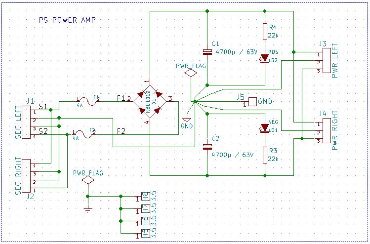

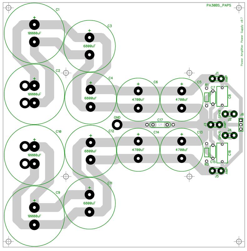

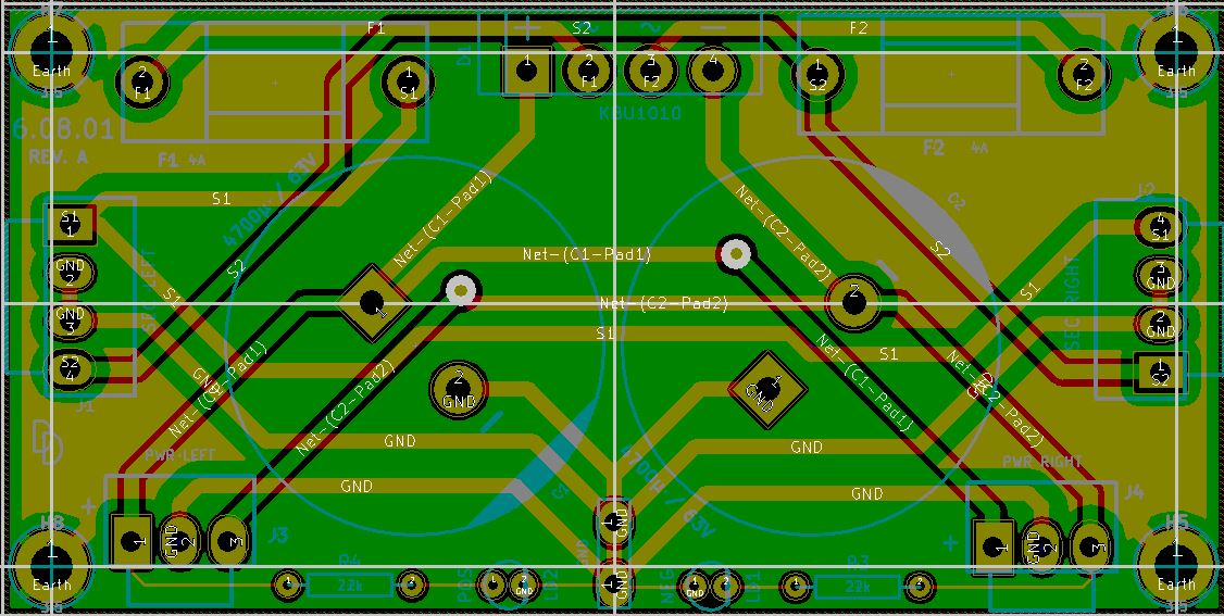

I've created schematics and PCBs for supplies, could somebody please check them and write if something is wrong or there is a better way of doing something there?
Size of the PCB can't be changed(enclosure limitations).
Amplifier PSU schematic/PCB:
https://cdn.pbrd.co/images/2W3FvKM.png
https://cdn.pbrd.co/images/2Wh1d8R.png
Note: using 2 diode bridges, 35A which are not on the schematic.
Is this the right way of connecting multiple caps with different values? 😀

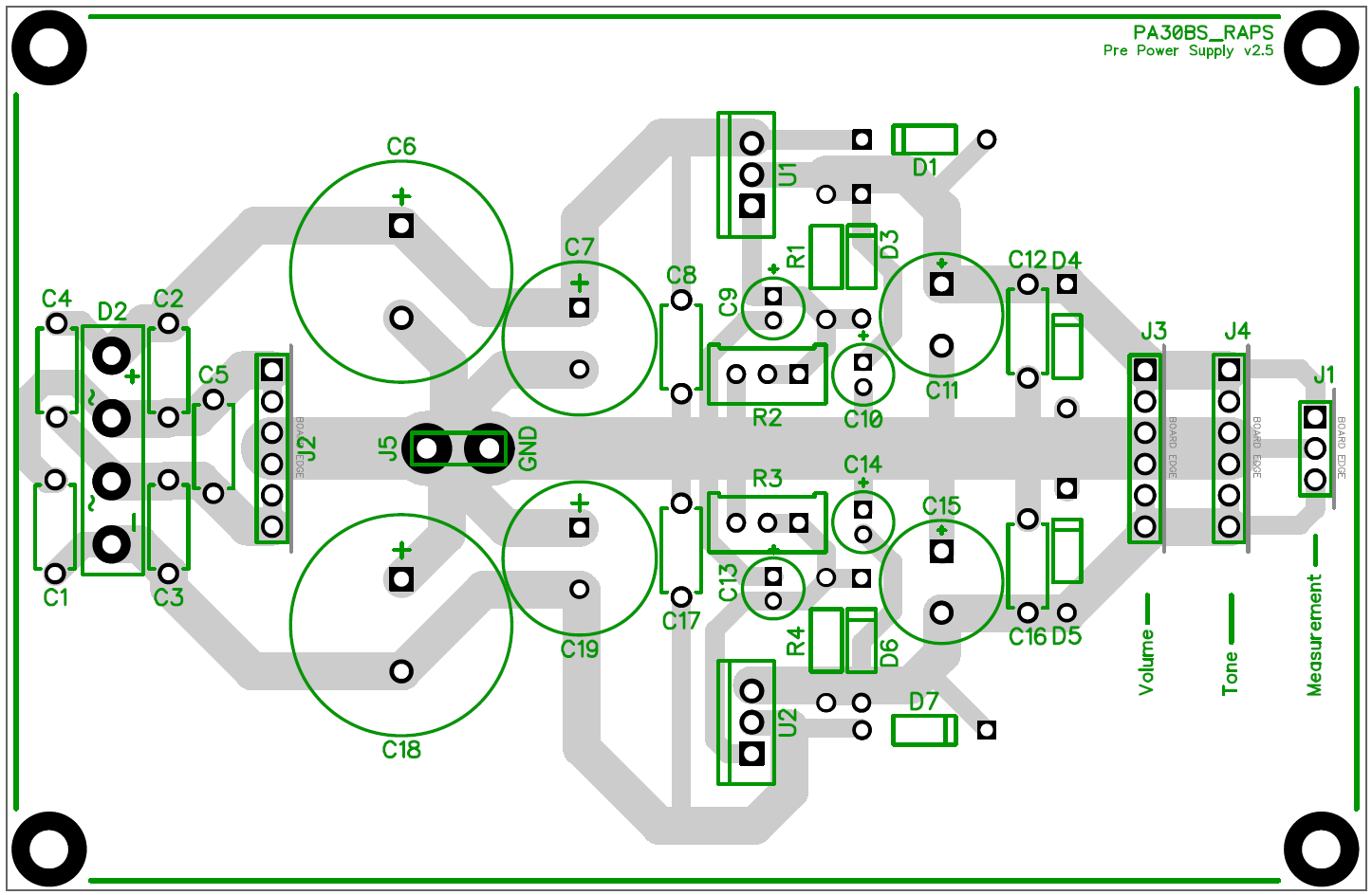

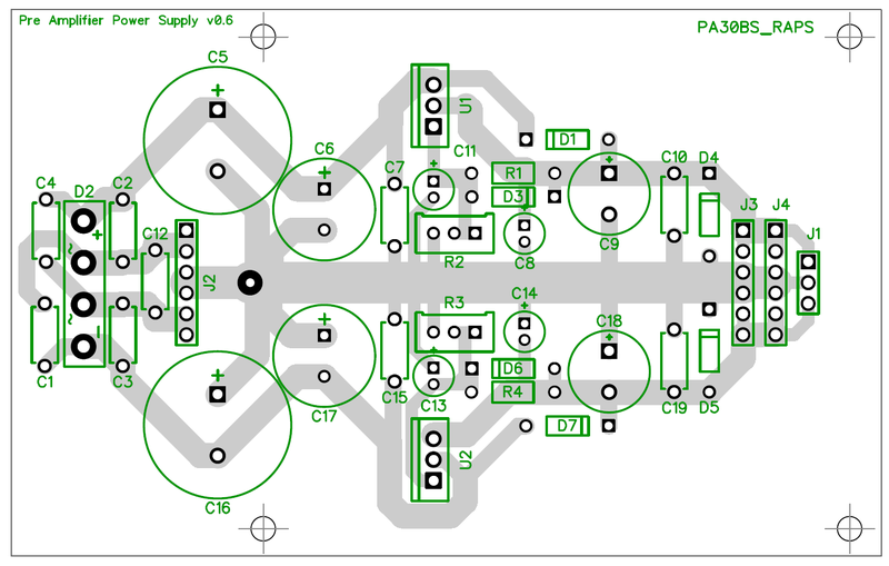

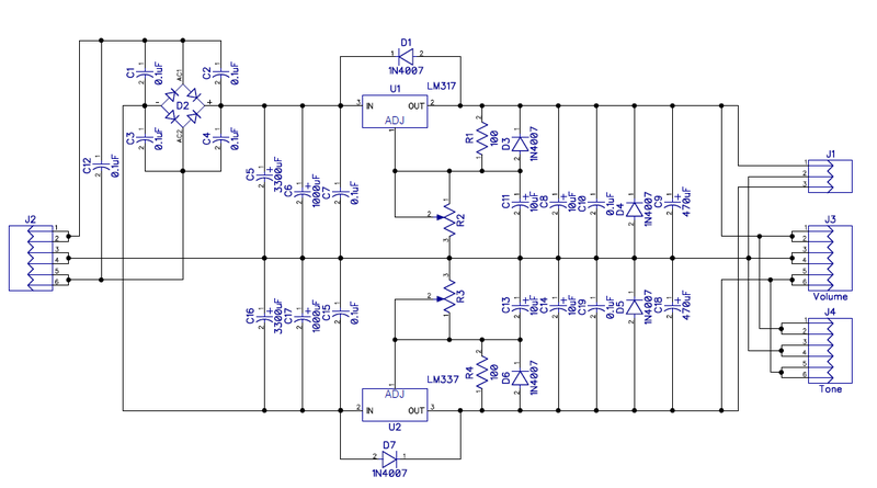

Pre-amplifier PSU schematic/PCB:
https://cdn.pbrd.co/images/2WnAp4e.png
https://cdn.pbrd.co/images/2WpOUXw.png

Could you explain why did you use 10000||10000||6800||6800||4700||4700 uF combination for the amp PSU instead of paralleling four 10000 uF caps which would be more compact?
The idea was to use larger and smaller caps since smaller ones charge and discharge quicker than the large ones.
Unfortunately I bought all the caps before I realized I will have to make this kind of messy PCB for it. I still can use 8x10000 caps but then smaller ones will be left unused(something I would like to avoid).
Have you actually looked at the existing designs, e.g universal PSU from diyaudio store?
Sure I did. Along with numerous others.
Also C||RC snubber after the capacitor bank should probably be put before the rectifier according to Mark Johnson.
Rectifier bridges have their own snubbers. According to Texas Instruments "AN-1849 An Audio Amplifier Power Supply Design" C||RC snubbers are welcomed after big capacitor banks due caps inductance.
On the pre-amp PSU I would turn the regs parallel to the board's edge and make provision for the heatsinks.
Putting regulators on board edges is a no go for this PCB, but I will make some space for the heatsinks. Thnx!
Also what is the purpose of D4 and D5 on the pre-amp PSU? You could look on ebay which is full of LM317/LM337 PSU PCBs... even if just for an inspiration.

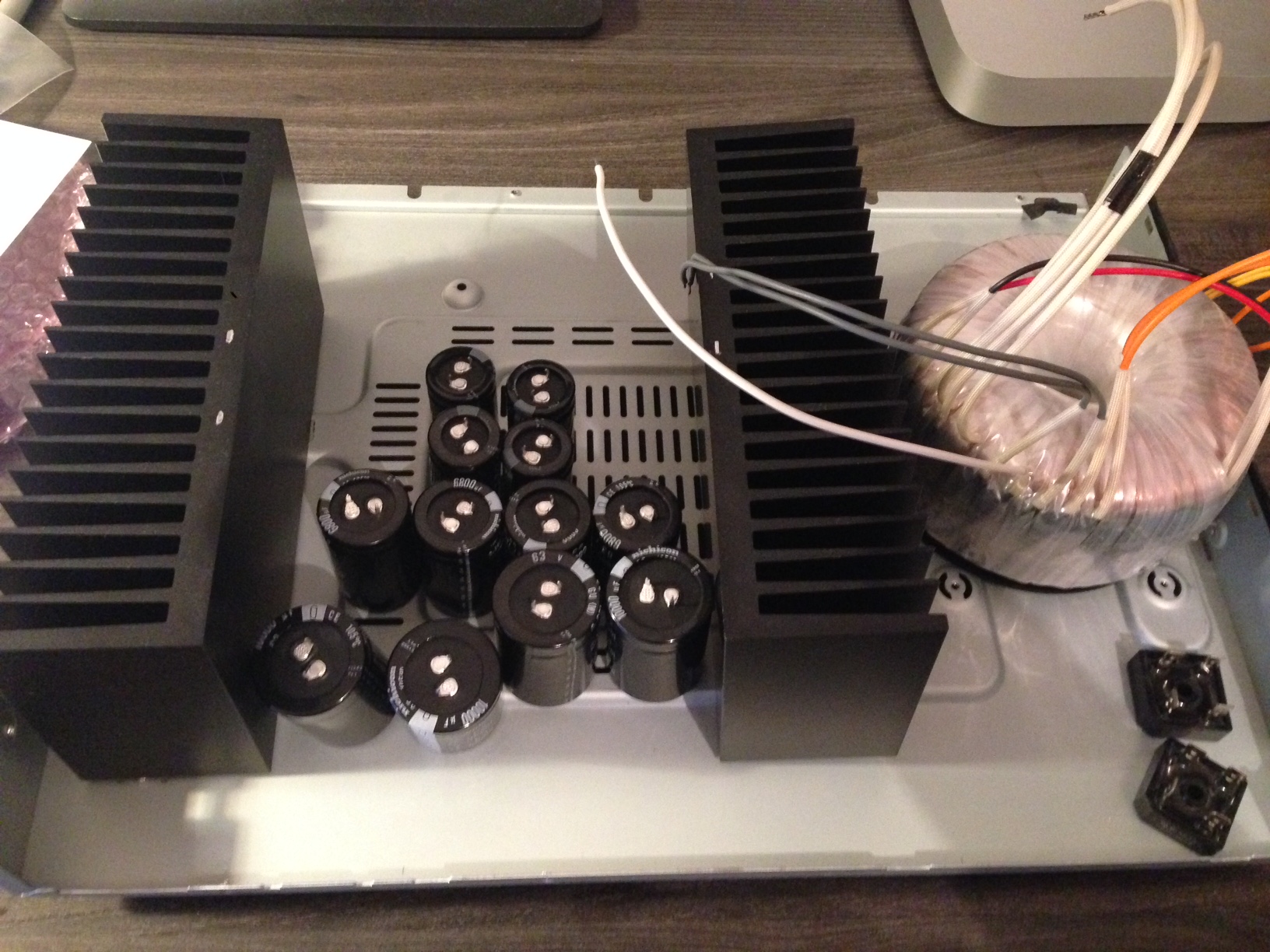

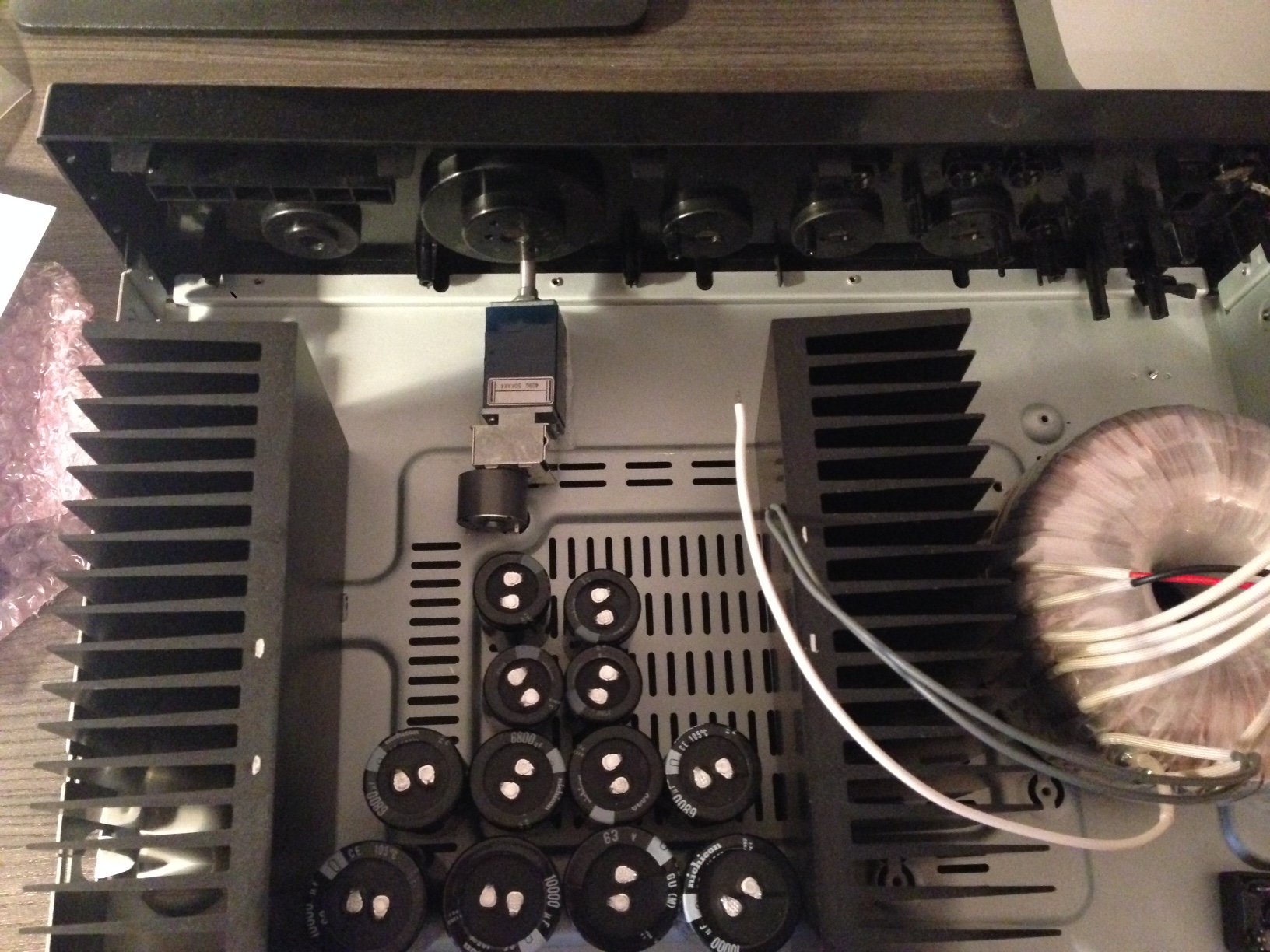

Since images tell 10000 words...
Amps go on each heatsink slightly toward the front. So I have to use the end of heatsinks for place to put large capacitors. After OlegSh post, I'm was thinking of using only 10000uF caps but I can't use 4 in a row, only 3 per row. ALPS 4 channel pot is coming in front of the pcb, at the center. To many space limitations.
You can see amp capacitors so you can image where amp psu pcb goes.
Pre amps psu pcb goes directly above it.
I've been messing with this for ages, no other way.

You will save a lot of space by hardwiring instead of using a massively oversized PSU PCB
Remove C1 to C4. They are likely to make ringing on the supply lines worse.
Instead add an R+C snubber in parallel to C12.

When designing a PS you should create ground reference point. This is the point that interconnects all grounds from different boards. See the attached pictures for a simple example.
Amasing how a very simple schematic can be turned into an extremely overcomplicated, still not good PCB. As you told GND is the most important potential in an amplifier, and despite of this we can see unneccessarily long, but thin (high impedance) traces in GND net, while a huge amount of copper is wasted for Earth. At least the charging current doesnt go through the star point (as the sch suggests). This is the only good point of the PCB. (However this is no. 1 importance.)
Maybe the 2nd most important thing is not to ruin ESR of capacitors. A good capacitor has about 10-20 mohm of ESR. Parallelled 5 has 2-4 mohm. 40mm track with 2mm width is 10 mohm. So if this track is in the loop, then the money spent on quality caps is thrown into the trash bin. In this aspect the topic starter PCB is a very bad design, since the big caps effectively cant work at high freq.
In a power converter PCB every place not covered by copper is a waste of money. Rails should be as wide as possible. If 2 layers are used, then 1 should be an almost continuous GND plane (small gaps may needed to control route of charging pulses to separate them from signal GND). Loop areas closed through different caps should not differ much.
Wire or PCB track?
Loop inductance of 2 typical wires side by side is about 1 uH/m. (Twisting doesnt help.) Two tracks side by side is about the same. Two 2mm tracks 1 over the another, on 2 sides is about the half, and 2 planes (on opposite sides of the same area, 10-20 mm wide) is almost 1 magnitude lower. Thin PCBs are even better in this aspect.
Why is this important?
Because a class AB amp has a very distorted supply current. This flows through supply loop, generates distorted voltage spikes, and finds its way to the output through not perfect PSRR of amp. The less the impedance the less the distortion generated 'by PCB'.

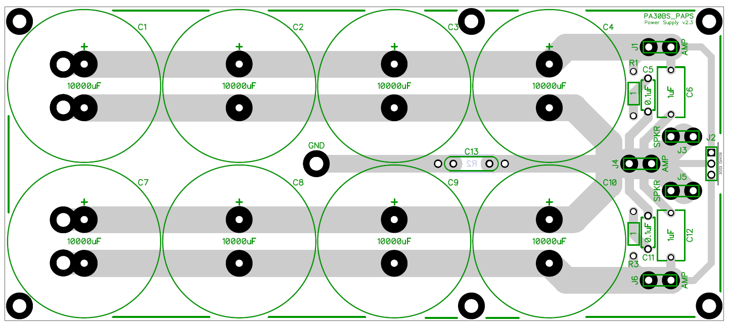

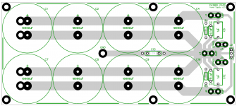

I will use 8x10000uF caps. After some additional measurement seems it will fit just about right.
PCB is attached.
I forgot to mention that I will use additional wire(1-2mm2)and connect capacitors with it(following the trace lines) for additional "copper".
Lines are 6mm wide on amp psu pcb.
Thanks to JohnnyBerg I added a place for faston for common GND on pre-amp psu pcb. It was a simple pad before.
I don't know how to make GND plane for this schematic that will "improve" sound/ESR/whatever... Could you show me on some example?
Wire or PCB track?
Can't make tracks side by side unless I widen the tracks... Shouldn't tracks be as far as possible so you get 0 H/m? Also, can't make tracks on top of each other in this case, so I'm not following. Sorry. 🙁
I will lower the impedance of tracks by soldering additional wire along the tracks on pcb. I can also put the same tracks on 2nd layer which would double the width of the tracks to 12mm(6mm x2). In that case I would not use additional wire.
Why? Every single "serious" supply puts capacitors as snubbers on diodes... Even "low cost hi-fi" equipment have them.
just because lots make the same mistake does not make the practice right.
Adding capacitance across the rectifiers just changes the frequency of the ringing.
A snubber is a resistance that absorbs the ringing energy.
A capacitor is not a snubber.

Not yours, but one of JohnnyBerg. PCB too. Yours is not complicated, and charging current goes on a mostly harmless way in both of your designs (if I decoded your design correctly, since you didn't indicate inputs at all).
Sorry, I don't have that much time! On 2 layers its easy, on 1 layer almost impossible.
The opposite is true. 0 distance is needed to achieve 0 inductance. They should be as close as possible!
It reduces resistance, but not inductance.
A GND plane on second layer would be much better.
The tracks lying one above the other on a two sided PCB could be termed close.
Using a 1mm thick PCB would be better than using the standard 1.6mm thick PCB.
Multi-layer PCBs that use ground and power planes properly have layer spacing of ~0.2mm
If you had a pair of dual polarity traces lying side by side on the bottom layer and the Zero volts track of twice the width on the topside and directly above them, you would get low EMI and low inductance.
