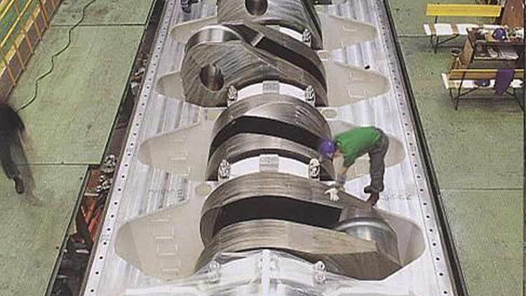

How's that for a crankshaft:

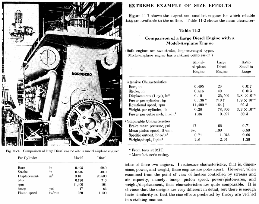

The fun spec about the largest direct drive engine is full power is at 102 RPM.
Spot-on. All engines have similar piston speeds, adjusted for duty.
That BIG engine is a 145 inch stroke at 102rpm. 15,280-something.
Old Ford V-8 is 3 inch stroke rated 4,400rpm. 13,200-something.
My Honda is 3.8 inch stroke rated 5,500rpm. 20,900-something.
Model airplane engine is 0.5 inch stroke and 20,000rpm, 10,000-something.
(We traditionally say FPM, but that means more math, and "feet" is obsolete, so I just go by S*RPM=something.)
This works-out that the 20,000rpm engine is relatively SLOWER than my last two sedans, and the hotel-room engine is in the middle.
The model engine has several strikes against it. No timed ignition. Awful mix of explosive and thick fuel. Conservative and Cheap all over. I'm sure the better models hand-ported by an expert would turn much faster.
Doesn't durability play a role? Apparently those container-ship engines are not only expected to last 25 years, they are expected to be serviced in-situ; even the entire crankshaft can be replaced with the engine still in place in the ship!
In the V10 era of Formula One, somewhere around 2002, there was a BMW race engine that revved to over 19,000 RPM; stroke was around 42 mm, or 1.65 inches. RPM x stroke would have been over 31,000 inch-rpm. 😱
That engine was most definitely not designed to last for 25 years of operation!

I live in La Boca, the old river port of Buenos Aires, 60 meters from the water, surrounded by Naval Supply shops, shipyards, ship repair shops and so on.
Typical is buildings with 3 to 5 story high doors so the large engines can be brought in, vertical as in the ship, I have seen monster crankshafts, and one just a block away has what I origibnally thought was a revolving platform, similar to what railroads have at critical points to turn locomotives around without maneuvering.
No, it is a monster Lathe, parts to be turned are placed **vertically** (the axis of rotation is vertical) and man sized tools come from the sides.
Are you sure?
For engine with side valve intake and exhaust ports, simple venturi throttle, glowplug ignition...
Have you seen how much Fractional horsepower a 0.12 Cu. In. 2 stroke makes?
And then compared it to what a 50cc 2 stroke dirt bike makes per cubic inch?
Model engine - Wikipedia
Now, efficiency...well that's another thing altogether.
It a little like the Wankel Vs Piston arguement - simple engine is more efficient at making power from small displacement, but less efficient when it comes to fuel, oil consumption.
A marine engine is almost the opposite situation, highest possible efficiency using said thick gloopy fuel.
One would probably find the HP per CI to be very very low in a marine engine.
