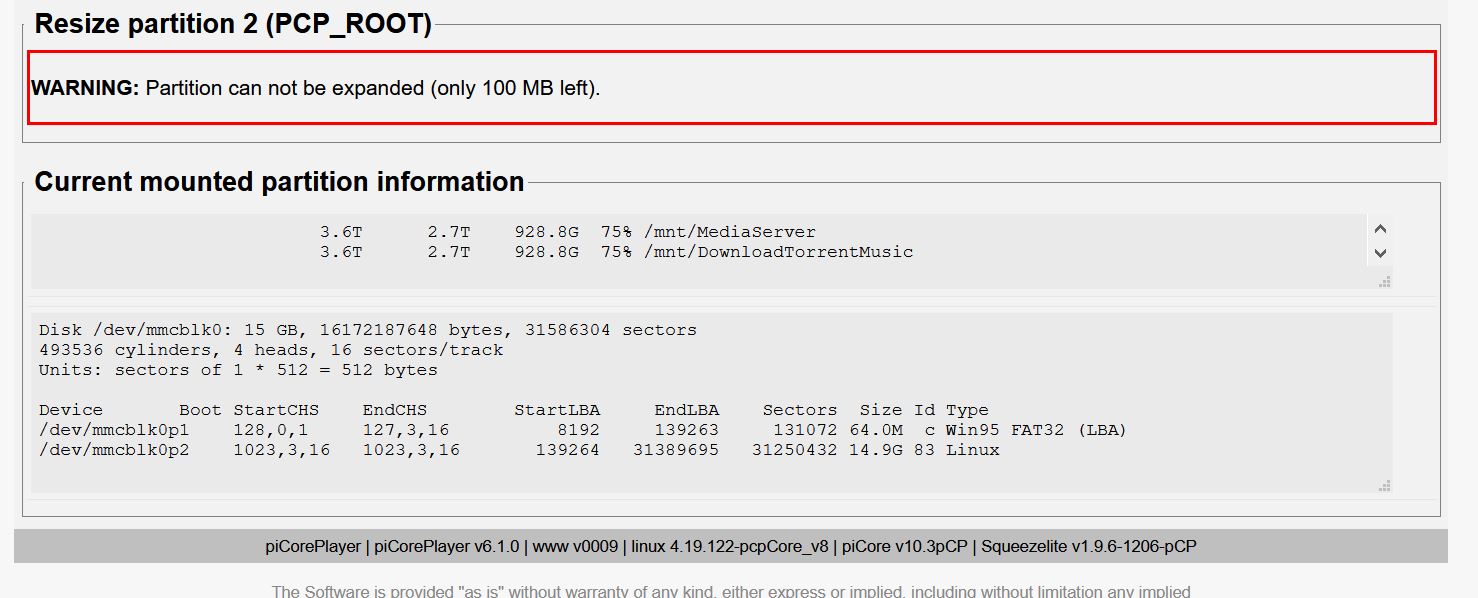

Hi Jesper,
Of course I have saved and rebooted. I just copied and pasted all together in order to show you.
I have resized to the full microSD after the first settings. Please find screenshot.
