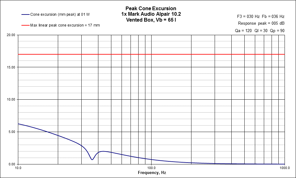

I've looked at the cone excursion plot, and it doesn't get scary until you start pushing sub-30Hz content through it at 20 watts. I will never run my drivers that hard, but I am considering implementing a simple RC high-pass at 30Hz to rule out the dangerous frequencies (in case any teenagers are at my house while I am not there). Not really a "need" for me per se, because I am basically always pushing less than 6 watts, at which point the cone excursion is well within safe limits all the way to 15Hz.

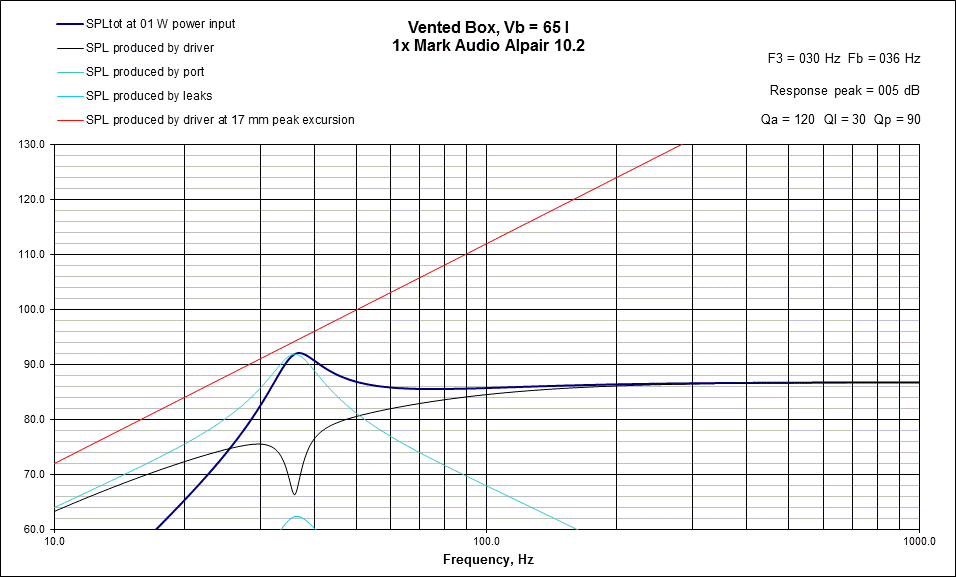

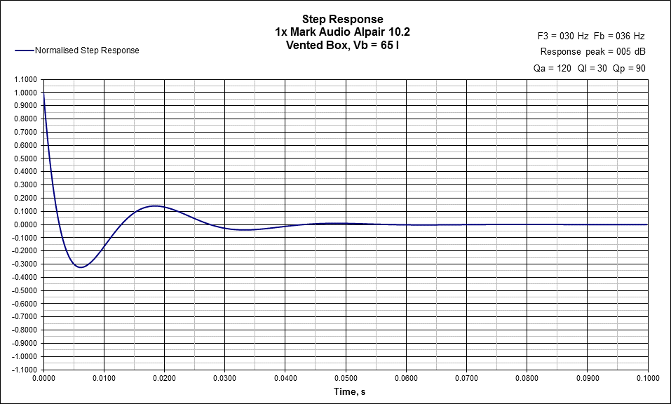

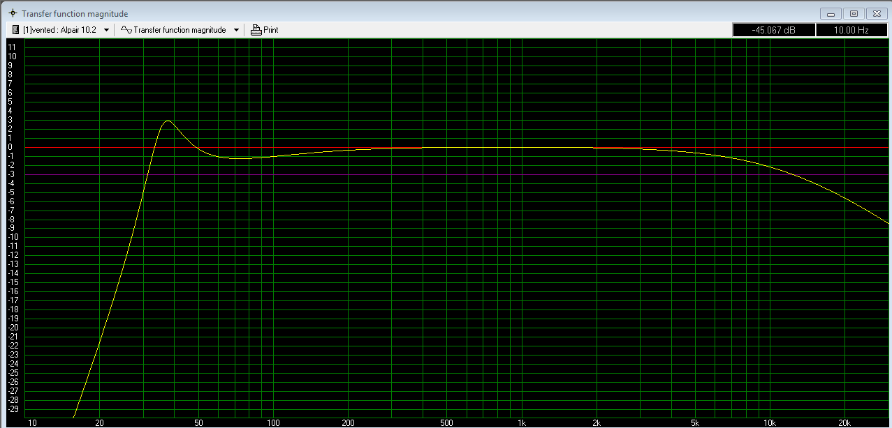

I tried them in a 2.3 cu.ft. standard bass-reflex box (my Clairtone Console project) tuned close to Fs and the bass response was shocking. That is what I was looking for, and the Pensil just wasn't designed to do it. I wish I had known that it was designed to only go to the mid-50s. Live and learn.
Hmm. 10.2 in a 2.3ft^3 'standard bass-reflex box' tuned to ~Fs? Anechoic attached from UniBox & WinISD. To each their own.
Fb on the pensils varies depending on the design. Note: Fb is not a brick-wall filter. They should provide decent output to the low 40Hz regions or lower under most practical conditions, depending on the box. They will not go as low as Bob's MLTL or an equivalent. They are not designed to. If that's what you want, you need to build something else.
Indeed. To each their own room and preferences. The simulation is not the full story, and you know this better than most here. Put that design (or close to it, see below) in a particular room and it will sound boomy and graceless. In my room, it sounds fantastic. I haven't done enough sweeps to figure out why yet, but I plan to. Also, at moderate listening levels I appreciate a little "loudness" enhancement. Not bone-crushing, window rattling "thump" but at least the nice, deep, rich bass tones that are so essential to so much music. Without it, it doesn't matter how good the mid-range and treble are; something is missing. The thing with the Alpair 10.2 is that the mid-range and treble are incredibly strong. I wouldn't call them "shouty", but when the bass is lacking they certainly approach "shoutiness". They deserve to be in a cabinet that takes as much advantage of their excellent bass as possible, IMO. They have an Fs of 35Hz, after all. 😕
Perhaps the Pensil is rolling off right where I have a room suck-out. I don't know (yet). All I know is that I stuck the 10.2s in an old console (enclosures are more precisely 2.148 cu.ft.) that I tuned to ~35Hz and I could not believe how good the bass was. Very rich and smooth down in the deepest notes but maintaining speed and detail in the upper bass, and it all extended right into the dining room and kitchen, with zeroed EQ. I was amazed.
Having said all this, I can coax similar response from the Pensils after changing the lining/stuffing extensively and if I get relatively aggressive with the EQ. Of course, aggressive EQing of bass response is not doing the drivers any favours. I'd rather expect the box do that heavy lifting (especially a box this huge). Hence, the plan to play with an adjustable port shelf. Forgive me for taking the liberty of attempting to tune this enclosure to my particular room and preferences. I do not intend it as a personal attack on you.
Someone mentioned that I should use distributed subs. Apparently they get the impression that I want sub-30Hz waves at goofy SPL. I don't. I simply think that the 36-46Hz range is critical for truly "full range" audio, and asking that of a driver such as the Alpair 10.2 is not a ridiculous proposition. In fact, I know it isn't because I have heard it with my own ears.
The pensils achieve their design goals. If you need / want something else, then as I have said, you need a different box.
