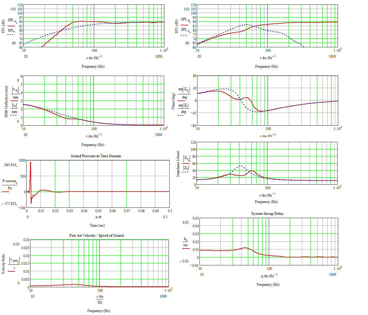

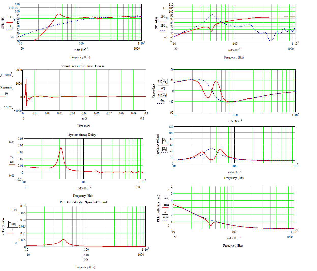

Pulling damping and tuning the box to a lower frequency per your recommendation will unfortunately mess things up. The pensils are designed to achive a specific alignment (with a degree of adjustability for rooms / amplifier output impedance / personal taste built in); if you want to change Fb however, you'll need a different box I'm afraid. For the sake of confirming what you've presumably already discovered when you put the cabinet in question through WinISD, they have nothing in common with any T/S volume alignment you are likely to encounter. They are derived from my own alignment
Btw, what do you mean when you say 'pro-audio alignment'? Flat response like a studio monitor or sound style similar to a PA system used by a DJ?
The second is heading in the right direction. I described the general alignment above, and in various other threads. Basically, the pensils are tuned to provide relatively broad-band gain through the midbass region (depends on the specific alignment I used, which of course depends on the drive unit), a relatively unreactive impedance load and linear drive unit deflection akin to a transmission line. On the left is the cabinet as designed. For interest, on the right is the box modified as you suggest above. I've seen (much) worse than the latter, but it's not one I'd recommend.

Thanks for running the sim with the extended shelf port. It does give it a rather big boost in the low bass emphasis and I agree your original design looks nicer.
