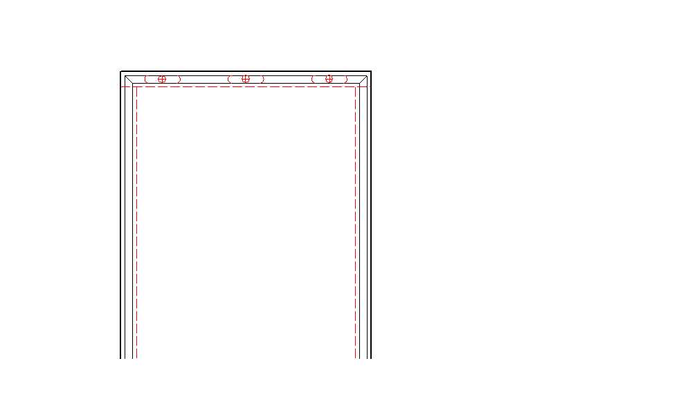

I had panned on using Curly Maple or Cherry to build the speakers. I would use Quartersawn White Oak, for its stability, but I made my TV stand and bookshelves from this and want to introduce something new. Although you may tone the music with a particular species, the same can be said for plywood or MDF. From what little i have read on the forum, MDF is said to have a dead and somewhat bloomy sound, where plywood/wood has a brighter sound. I don't know, this being my first speaker. Any recommendations with impressions are greatly appreciated. Another point on tone from wood. Many of the instruments that are affected by toning from the wood tend to use wood that is much thinner. I would assume that the thicker the wood, the less of this problem there would be. Once again, this is an uninformed thought. I have seen ideas for fastening to allow for wood movement, that i think i can get to work. I will try to post a drawing showing the method being considered. I would appreciate a comment when posted, if possible. THanks!
Here is a skimpy mockup of idea. It includes upper half of Pensil 10.2 as seen from the side. I was going to route a 3/8" deep channel 1/4" wide and 1/4" from top of the side panel. Within this route, i would do three more small routes with a chamfer bit that go all the way through the wood which would hold the head of the screw inserting into the top. This would give a tight fit, but still allow for movement. I would use some sort of thin gasket for good air seal. Same thing would be done down the sides and back. After tuning, the larger route would be filled with different species of wood ,which would cover the screws and fill gap as well as add a decorative touch. Just a thought. Seen it done in Fine Woodworking, I believe.
