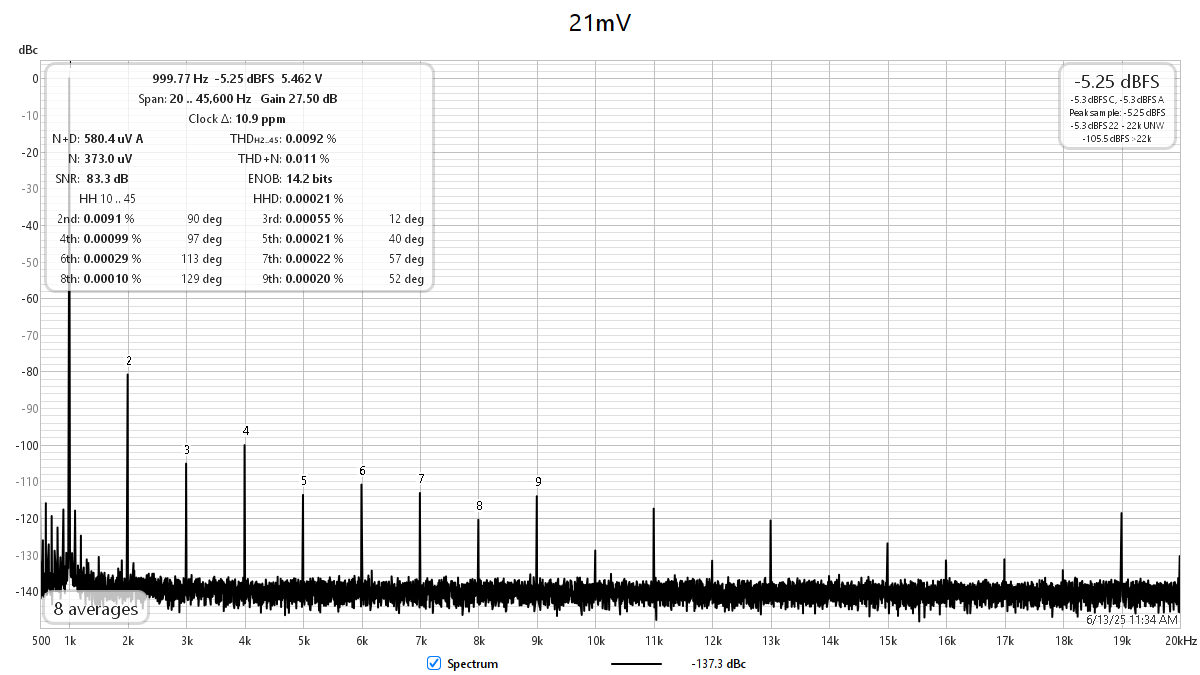

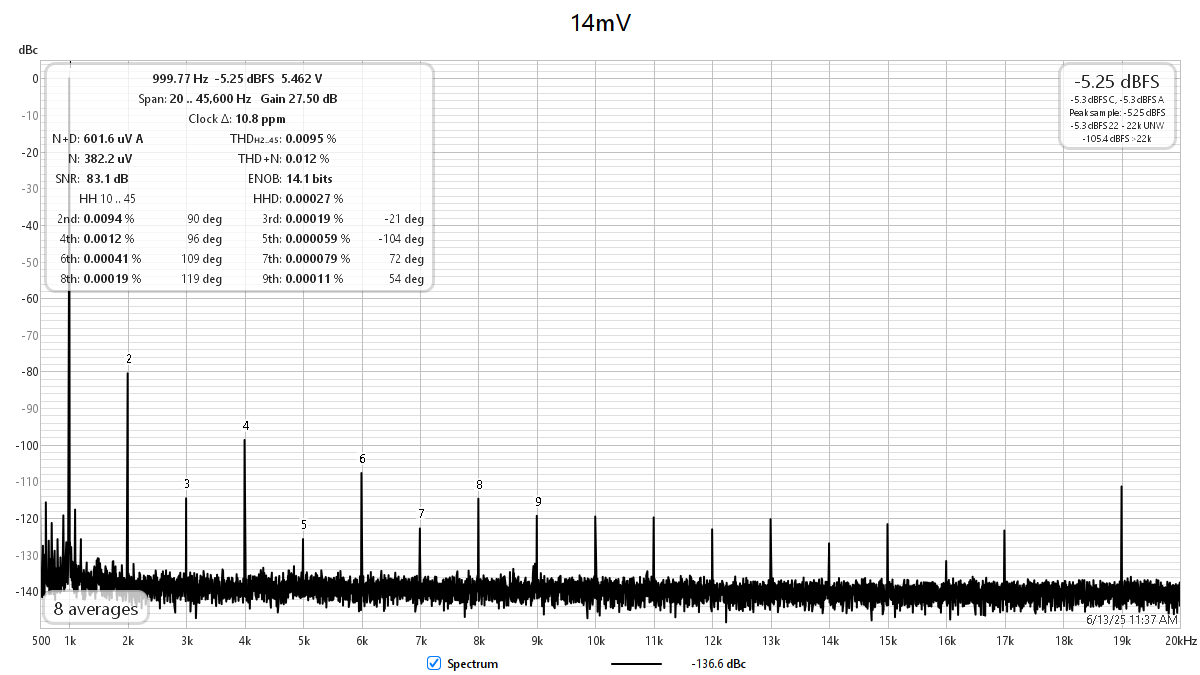

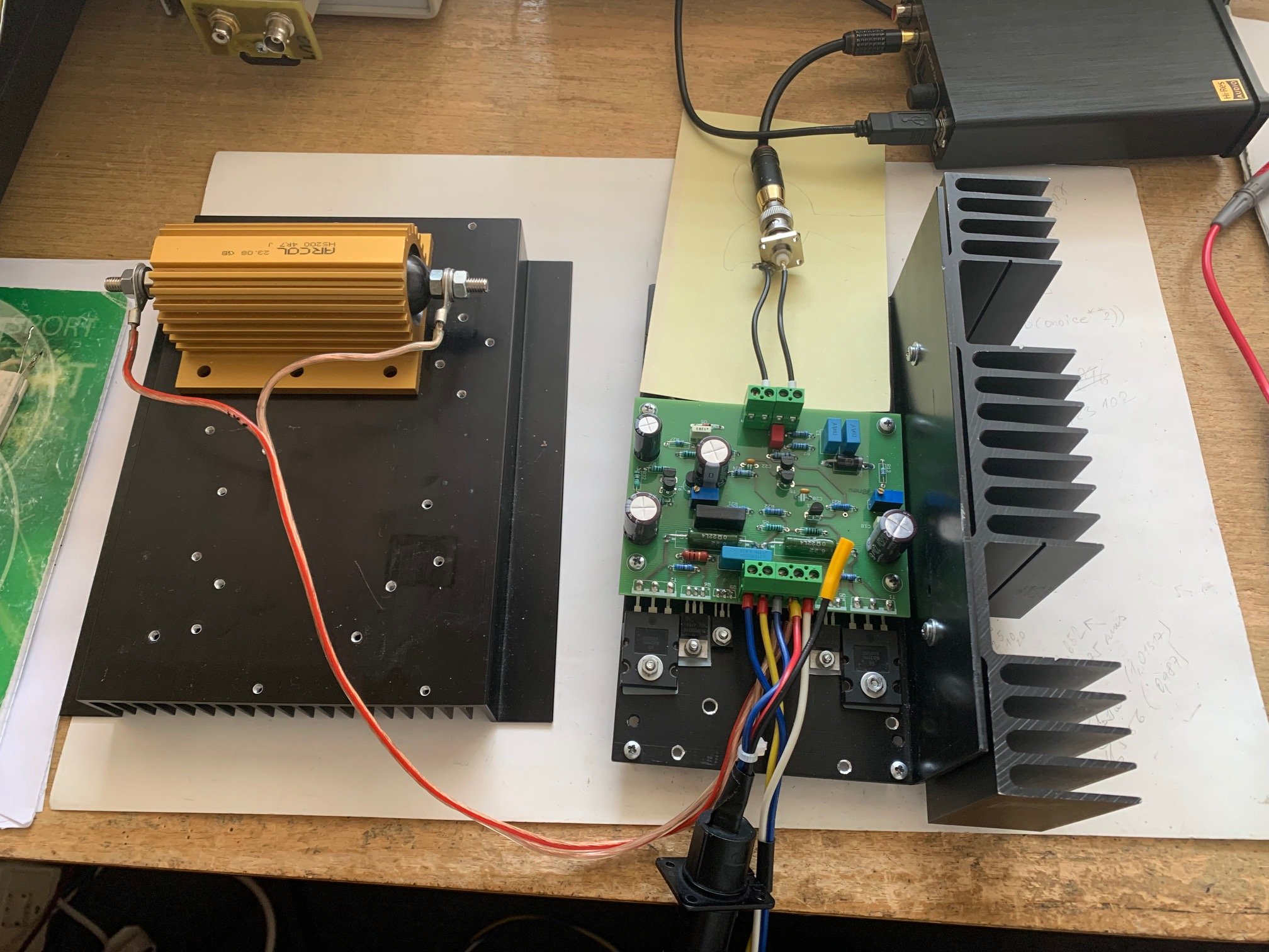

You know Ed, there is a lot of myth spread through internet, based on simple simulations and incomplete analysis, that is not taking into account enough variables.The simulator also shows that 15mV is fine, but the lower voltage will be more affected by temperature.

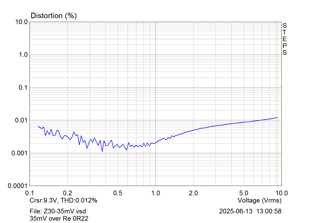

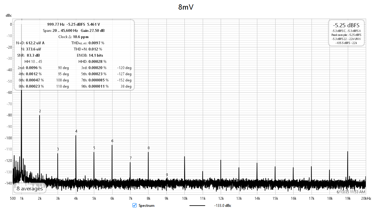

I have just made for you, and others who might be interested, a set of measurements with a simple class AB amplifier, with MJL21193/4 single output pair, 0R22 Re resistors, and 4R7/200W load. The results with 8mV, 14mV and 21mV across one Re resistor are shown below.
Please check them. This is my humble suggestion, not only to you, but to all simulation-only guys. NEVER give any strict suggestions based on simulations only. Just say maybe. You never know before you build the circuit. Go and build the circuit ad then optimise it (including idle current) to the best results you can get from the circuit. Then you may give suggestions, valid just for one circuit and existing implementation. Anything else is a stub. It is up to OP to show what his circuit can do, in a real world.
@PMA - Thanks for the measurements! A very apparent difference is that the measured data (of a real amplifier) shows both even and odd harmonics, while my simulation (of only a complementary emitter follower) shows only odd harmonics. The conclusion is the real amplifier has more distortion mechanisms than the one in my simulator.

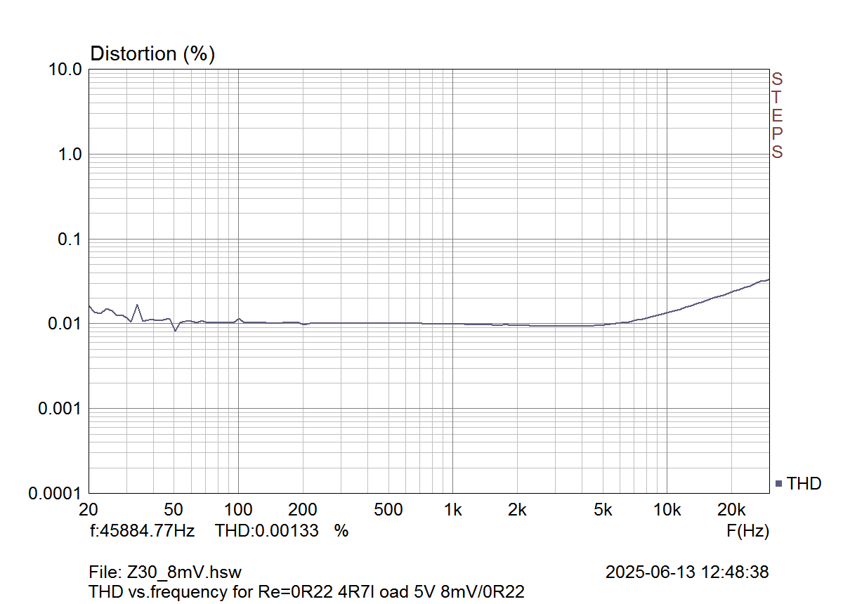

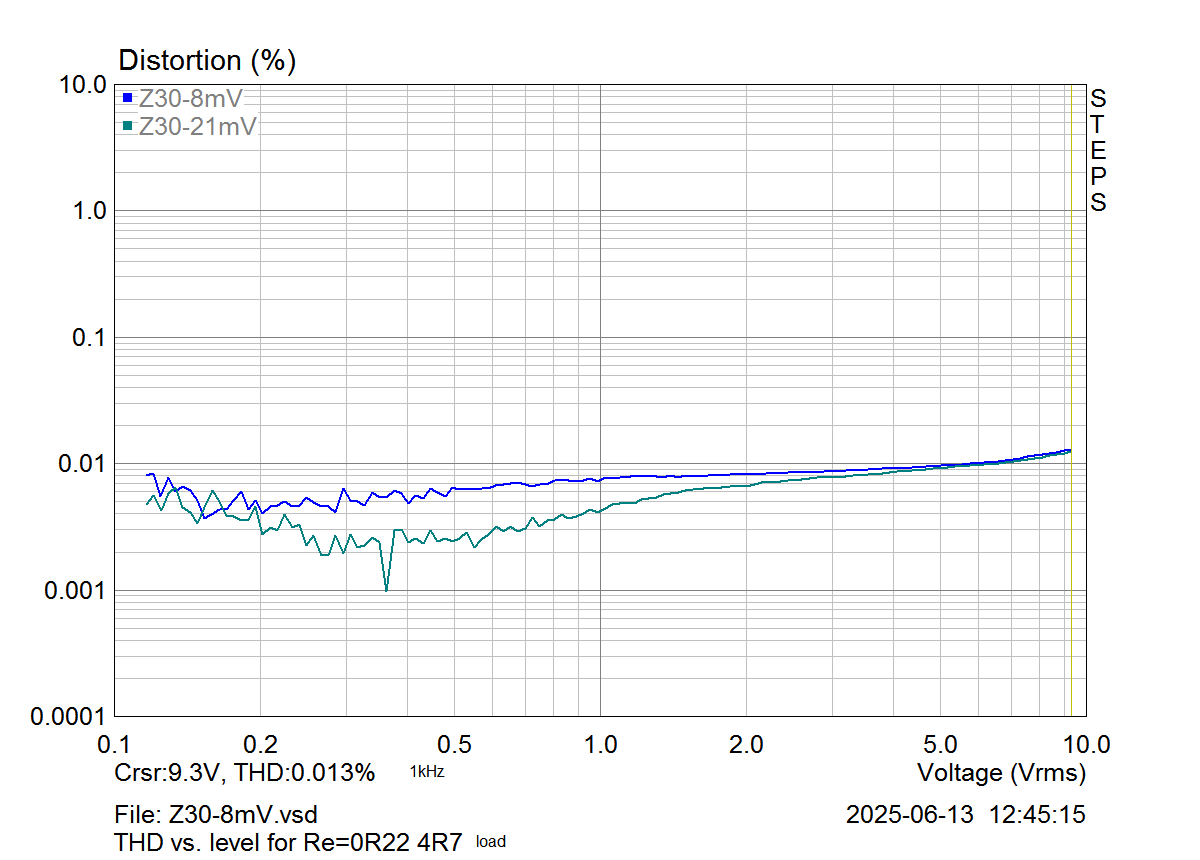

21mV over 8mV bias advantage can be seen at low power, as the output stage stays longer in class A, due to higher idle current. That's all.
THD vs. frequency keeps being reasonably flat.
Sorry if I am OT, but I cannot stay silent when I read certain recommendations.
Now, 35 mV across 0R22 makes it even better
So, I am asking, where are the text-book suggestions on 21-25mV? We have known for years that it does not work.

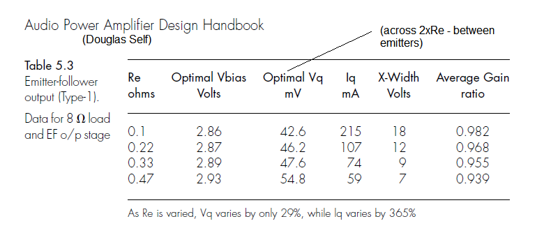

Push-pull EF or 2EF output stage is probably the most frequently used output topology in class AB amplifiers. It is well covered in renowned design handbooks, like
Self, D.: Audio Amplifier Design Handbook (Newness)
or
Cordell, B.: Designing Audio Power Amplifiers (McGraw Hill)
Authors come to the conclusion that for the lowest distortion in class AB, voltage drop across an Re resistor (usually 0.1 to 0.47 ohm) should be about 22mV, as by Self below (he shows voltage between emitters, i.e. 2 x Re resistor):
Simulators (MicroCap, LTSpice) show +/- similar values. But how...
