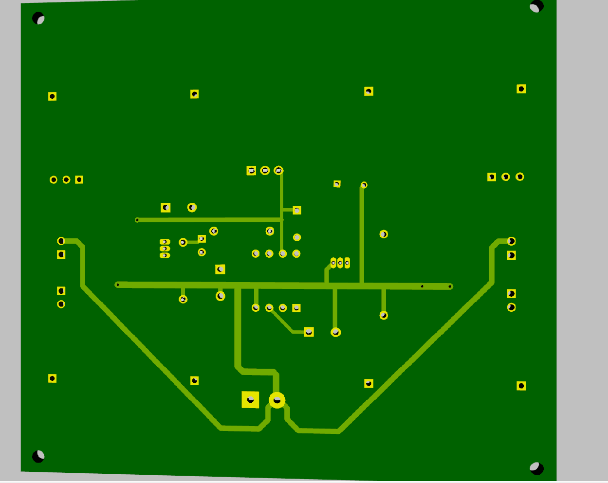

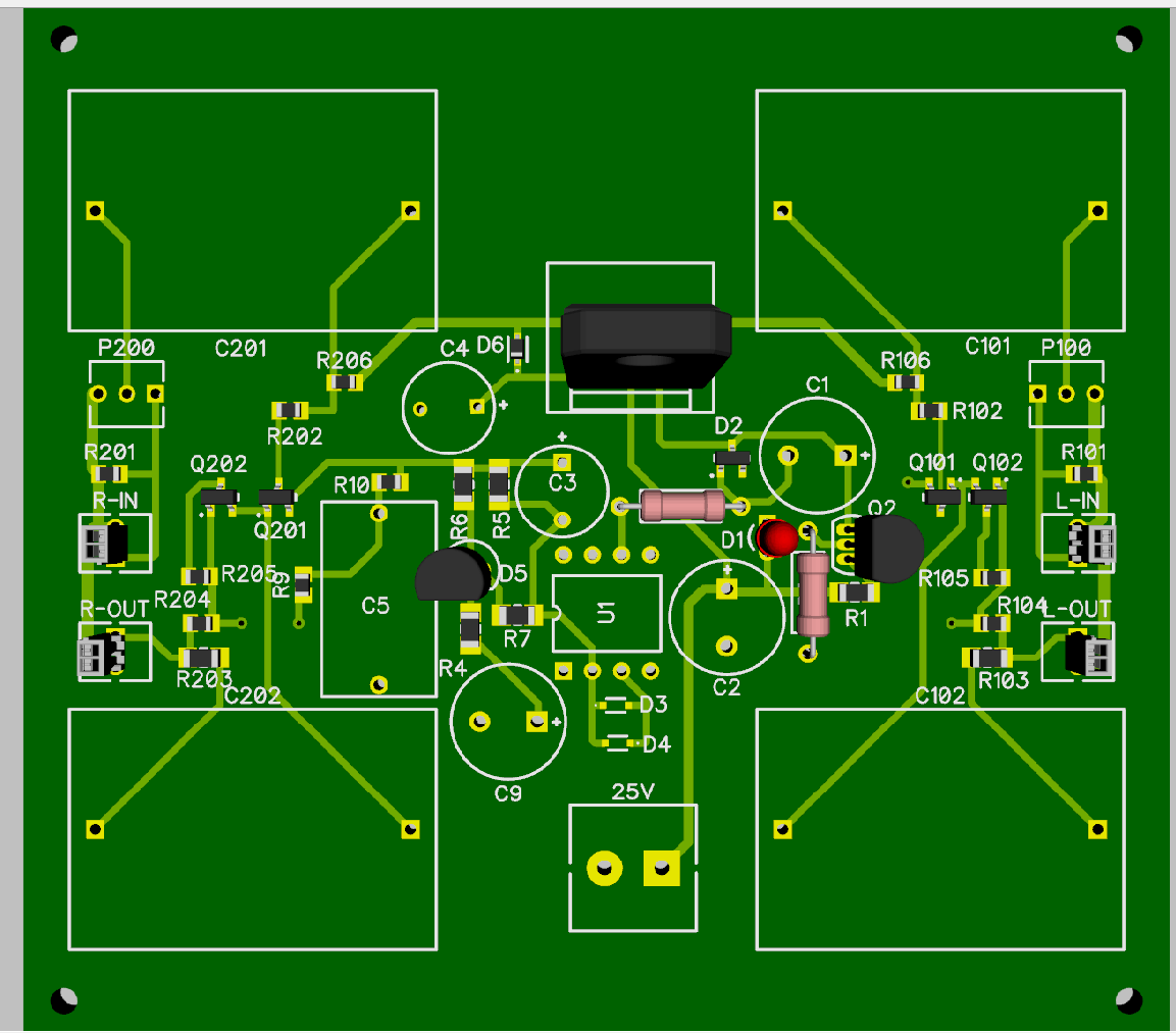

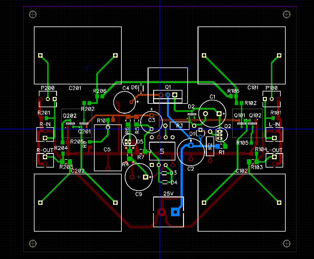

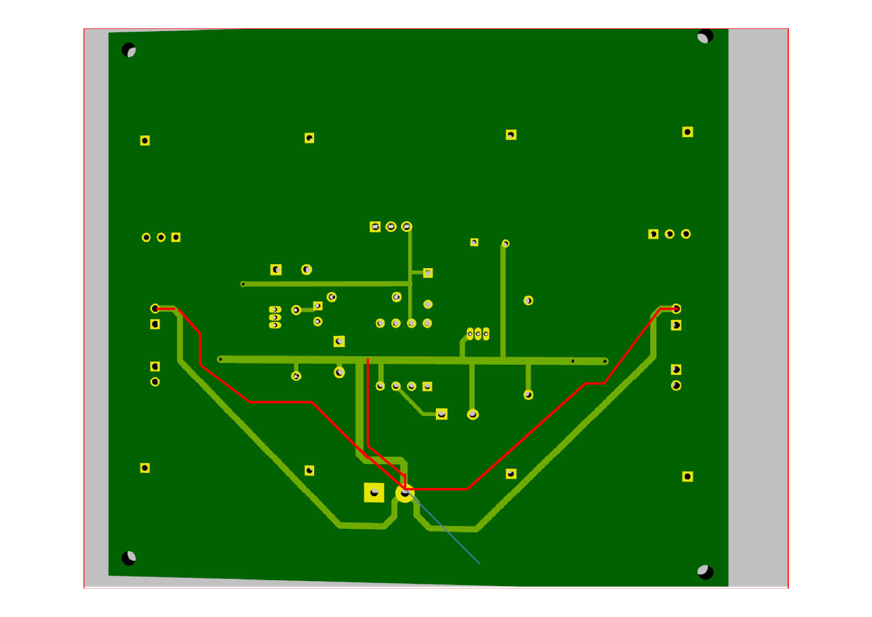

Ok,I will turn them into two 45 degree. Changed C5 ,the polyester cap with polypropylene(bigger).Is this any better?😱
Well, I always try to make it compact, but that's just me. Not a big deal I think.
What I do is step back, look at the big picture, forget about all the parts and stuff, just look at the pattern. But I've been doing that for decades I guess ;-)
Jan

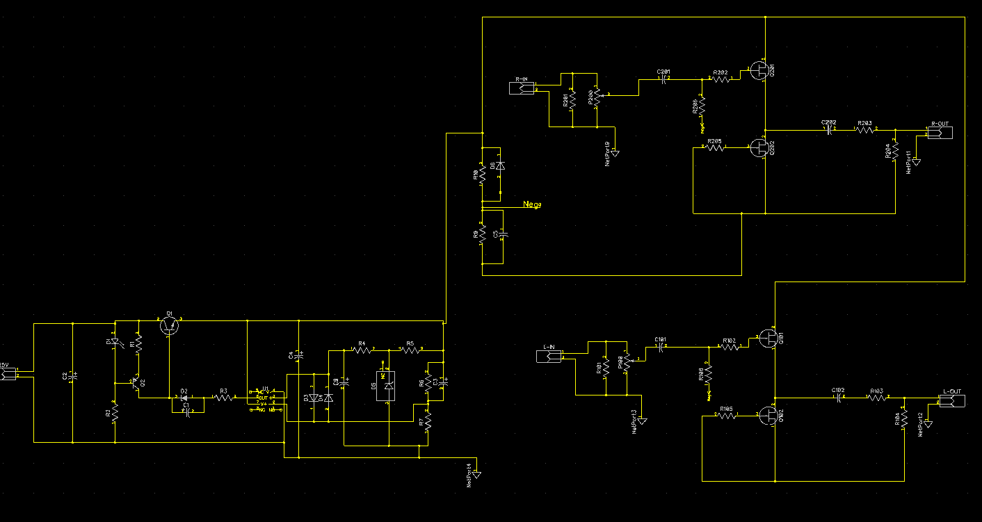

how does this design appear to you
Are you ruling out surface mount for the op-amp? AD825 is only in surface mount.
An L-pad can sound better than a pot. The series element is a resistor and the nasty sounding pot is only shunting to earth. I just did a couple of conversions like that, with something like a 2 k or 5k in the signal path, followed by the 50k pot, in those cases, to earth, and wiper to earth. Then your 1k.
You have R202 after the capacitor C201 (200 on the original schematic), and after R206 (which was 203 on the original), instead of before them. Or is that a gate resistor for each FET? Which the pdf doesn't have: http://www.firstwatt.com/pdf/prod_b1_man.pdf Or are you earthing the lower FET's gate via a resistor?
Should the input and output grounds not be separate to the earth star?
Copper track sound muffled and blurred so the less of it in the signal path the better. Same for solder joints. I would try and share solder pads to reduce the number of joints. I done these things many times and heard the extra clarity.
