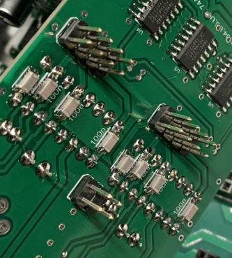

Just directly wired the sense connection on the supperreg board to the -12V pin on the DAC IC ==> ZERO effect on the scope. Positive thing about this test is that it gave me more confidenence in the pin connectiors.
Removing the DAC from the bottom board and restively loading the suppereg's via the pin connectors removes the oscillation.
Load is 31mA for the -12V regulator.
Test: I added a Pana FC 35V 47µF parallel to the 100n decoupling cap ==> oscillation amplitude reduced from 100mVpp to 15 mVpp. Need to order some Panasonic Polymer caps (https://www.mouser.be/ProductDetail/Panasonic/20SEPF120M?qs=OE1iw1LrrPGaVmyWj69G7A==)
It's most probably the high-Q ceramics on the DAC board.
The final cap on the superreg board should have non-zero ESR to provide enough damping.
The idea is that with a bit of (inductive) wiring between the superreg board and the load (here the DAC) there would be sufficient isolation between the superreg and whatever is at the load.
With directly plugging the reg boards to the DAC/motherboard that isolation isn't there.
To verify that the diagnose is correct you could temporarily remove the 0.1u ceramics at one of the loads and see if the oscillations stop.
If that is the case we need to come up with a solution ...
Edit: where did you add those elcaps? At the superreg out or on the DAC board?
Idelly as far away as possible from the superreg, like after the headers, close to the DAC.

Yes, the elcaps are placed close to DAC pins. As far as possible from superreg out.
Directly at the superreg out, there are high ESR tantal caps (6ohm at 100kHz): https://www.mouser.be/ProductDetail/KEMET/T491A475K025AT?qs=%2Bcwu2E9E7oWIZoJQLPvDlQ==
I removed the 100n COG decoupling caps from DAC pin's ==> result is back to 100mvPP oscilation.

Wait a minute..., I see big differences when holding the scope probe by hand or clamp it on a wire without touching the probe. I'm afraid I need to do the entire exercise over.
Jan, on the superreg board is mounted the tantal as mentioned in post 3447. on the main board, on which the superregs are placed, a 100µf 35V Nichicon FG is there (20mm from the superreg PCB). In my understanding, both are low ESR. The tantal is there, just for stand alone testing of the superreg's.
The trace lenght between superreg and load is approx 60mm.

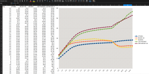

I've tried to make a structured overview with all tested parameters and the result.
Quite some things can be concluded out of this for my next PCB revision.

I gave up and inserted an inductor in the psu traces (out of the feedback network with the sense connections). Inductors are 47uH (RDC about 6 ohms ☹️). Oscillations are completely gone.
Now, what is the added value of using these Jung-Didden superreg’s in this configuration with the inductors?
So yes, nothing wrong with the regulators, just a PITA load.

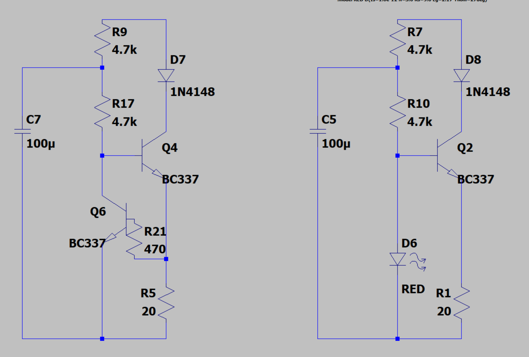

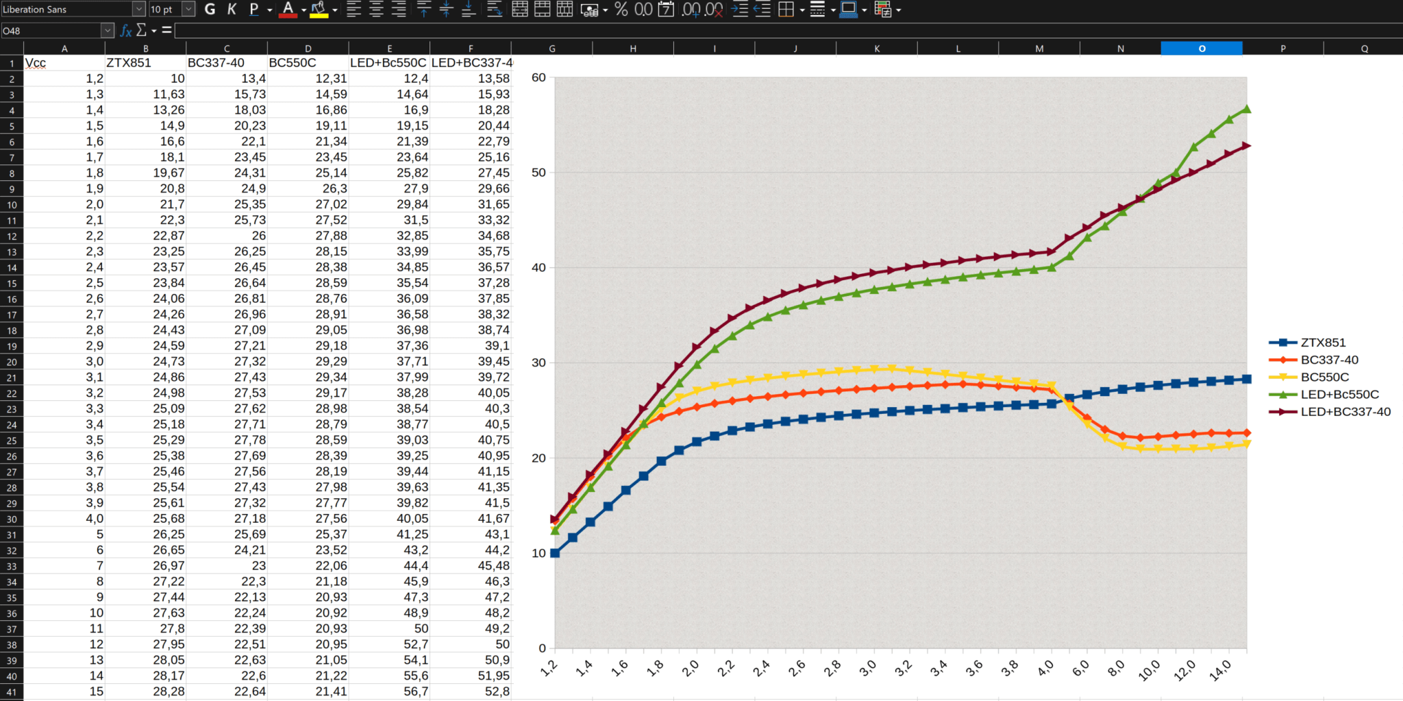

Having encountered strange behaviour at high load and minimum voltage offset, i decided to compare input CCS stability with dual BJT vs LED+BJT at different VCC levels, as in super regulator , Voltage offset is the VCC for CCS. I loaded the CCS with one silicone diode drop to simulate pass transistor. I tried to be as scientific as i could be for 1 hour, first 4 Volts in 0.1V steps, from 4 to 15V in 1V steps, all other elements unchanged.
It seems, that at high current draw i get too much voltage drop on input cables from PSU, thus lower input voltage. Having too low input voltage, results in simultaneous VCC drop for CCS (i.e. regulator offset), and while CCS current input droops, the pass transistor being in it`s own beta droop region, needs MORE current. Last night i was able to get to 0,93 Volts offset with Vout stable at 0 to 1 Ampere draw, but it seems that at this offset, my input CCS is already giving it`s lats few mA, while pass transistor is still able to keep up with regulation, while op-amp does it`s magic.
Input CCS stability chart shows, that much cheaper and widely available BC337_40 at low offsets is actually more stable than expensive and momentarily unavailable ZTX851, to my relief. Also dual BJT CCS seems a better choice than BJT+LED at low input offsets, but in general a minimum 2 Volts offset seems most advisable if I want to count for input voltage drops at sudden current draws.

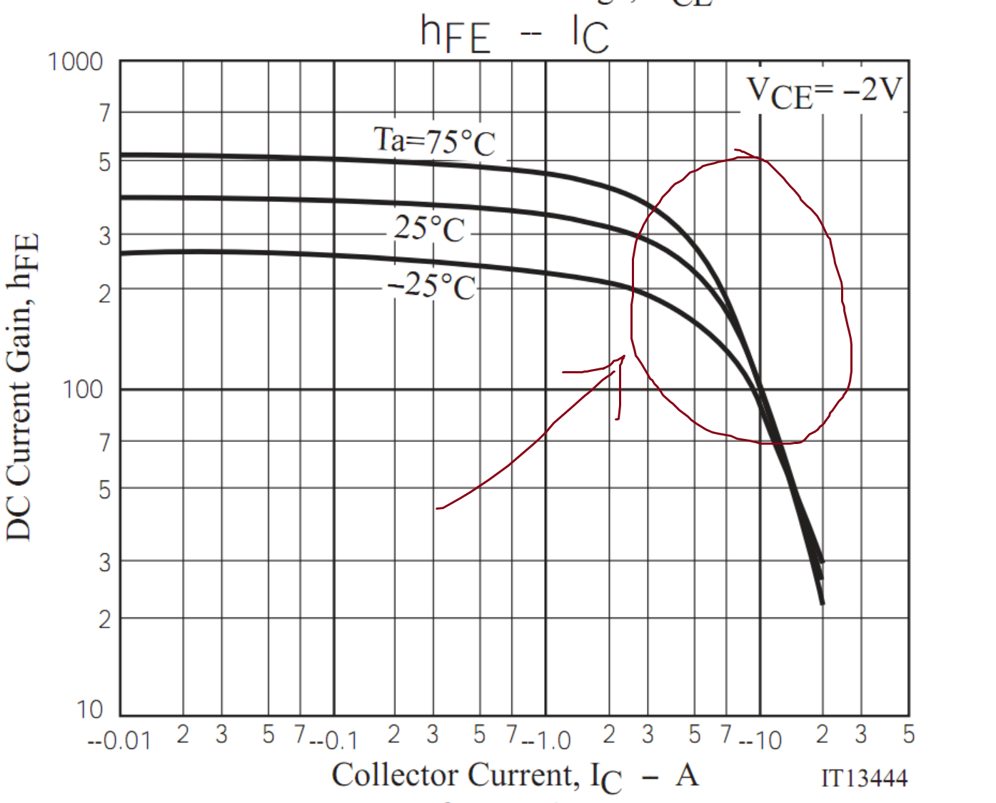

Which hints the datasheet spec of a 0.1 uF capacitor is lower than it should be. I'll ask a silly question: are you sure that's a C0G and not an X7R or something else in the circuit? If it is, then perhaps a heftier part in X7R rated to 50 volts or above could do the trick. Non-C0G ceramics tend to lose capacitance when biased, with the effect reduced at voltages less than rated, hence the >50v recommendation. Mouser is crawling with 1206-sized 4.7 uF at 50 volts so choice isn't an issue.
I'll also bet the 100uF 35v electrolytic is a low-ESR type, in which case you could have a parallel resonant tank with the bypass ceramic. Electros of that size tend to have equivalent inductances around 100 nanoHenries, so with 0.1 uF in parallel the resonant frequency would be not far from 1.5 MHz, and a bit of PCB trace inductance could bring that down around 1 MHz. Remember Q = (1/R) * (√(L/C)), so with L close to the same magnitude as C then Q ~= 1/R, hence the tank would have a Q of 5 with a cap featuring 200 milliohms of ESR.
Looking at the bypass impedance, a simple model of the electrolytic impedance as Zce + ESR + ESL says the capacitive contribution is nil at high frequencies so at the frequencies of interest its form is ESR + ESL. Plugging that in the parallel equation with the ceramic as Zcc, the impedance becomes ((ESR + ESL) * Zcc) / (ESR + ESL + Zcc) and at resonance it simplifies to ((ESR + ESL) * Zcc) / ESR since Zcc and ESL cancel each other in the denominator. With the values shown above the bypass impedance rises from 200 milliohms, as contributed by the electrolytic somewhat below resonance, to 5 ohms at the resonant peak. Active devices switching quickly could excite that resonance, bouncing the supply rail.
Replacing the specified 0.1 uF capacitor with a 4.7 uF ceramic sorts that out nicely since its resonance with the same electrolytic would have Q at a more reasonable 0.7, causing barely a ripple in the bypass impedance.
