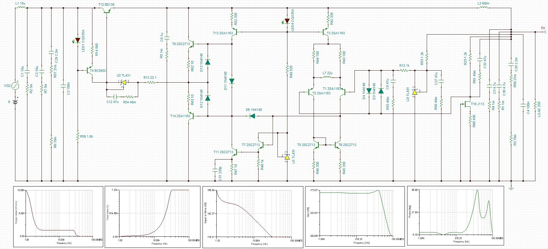

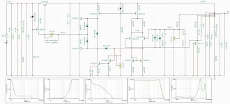

Newer tried discrete opamps, this one is sk99 I sligtly modified and implemented into J.D. 5 volts regulator,, realy don't know if circuit is ok, simulation gives me good result, anybody tell me is this circuit ok? TinaTI sim model in rar archive

This is dedicated thread for a Jung-Didden voltage regulator. There are no good reasons to push another designs here.
And, why do you expect that discrete opamp will have any advantage against opamps from TI and Analog devices, that are results of long accumulated design knowledge and some best EEs in this field? Just look at datasheets and application notes.
Correct action would be to open new thread in the Power Supplies section.
But circuit above is J.D. but with discrete opamp, are we speaking here about opamps? If so, circuit above is one of options, right? Another good opamp for J.D. is SA5534 , good simulation results was similar to post above, real measurement confirmed SA5534 very good for j.d. take a look at post 2871
I don't realy know, just want opinions, never tried any discree opamp. I can confirm what tombo56 say about sound details using J.D. regulator, that paid my attention to this type of regulator. From the first build I noticed diference in sound firstly in digital amplifier sound and later I want it on all my audio equipment. Regulators from op simply deserve all attention.

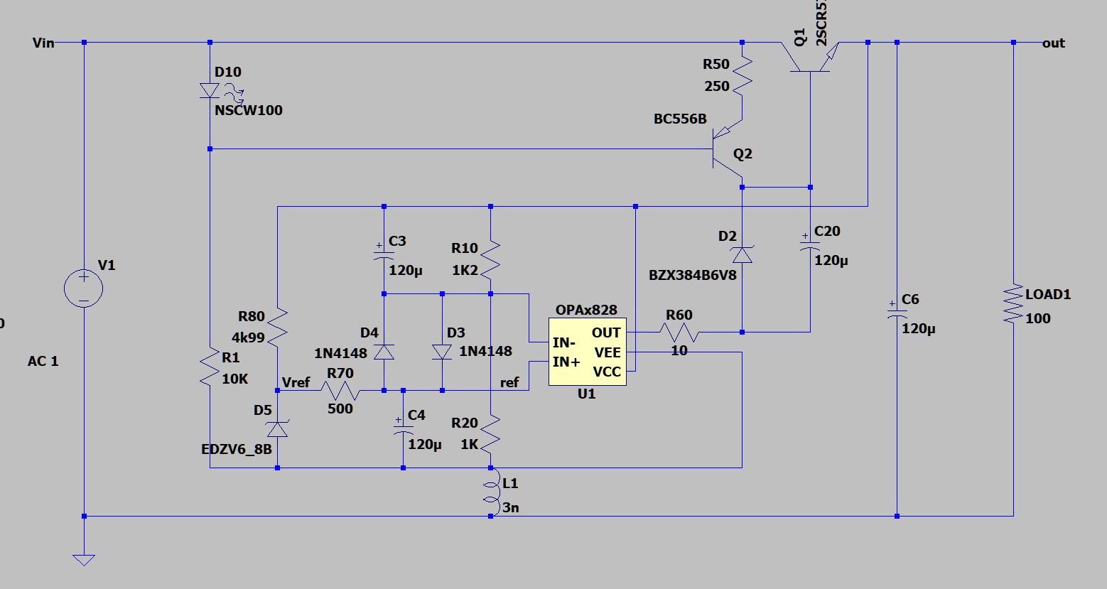

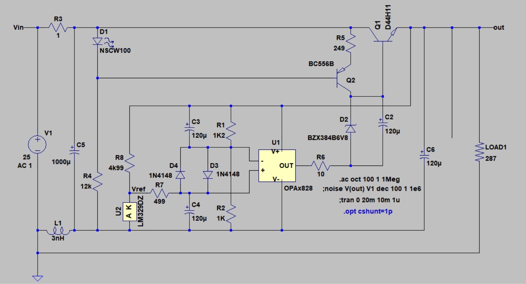

As for the LTSpice simulation, use separate ground line from load resistor to voltage source ground and connect rest of regulator circuit ground with small inductor (3 nH/3mΩ). Add directive ‘.opt cshunt=1p’. That will be enough to get realistic PSRR that would be 130-140 dB max in the LF region.
OK, I did what you recommended with the ground arrangement and adding that .opt directive using OPA828.
1) With the directive it doesn't run. Or if it does it seems to take ages to.
2) With that inductor and without the .opt it does run. But psrr became -56dB between 100Hz-20KHz. The real pssr shouldn't be that bad, I believe. I'm not sure how to change the values to get to something more realistic in psrr.

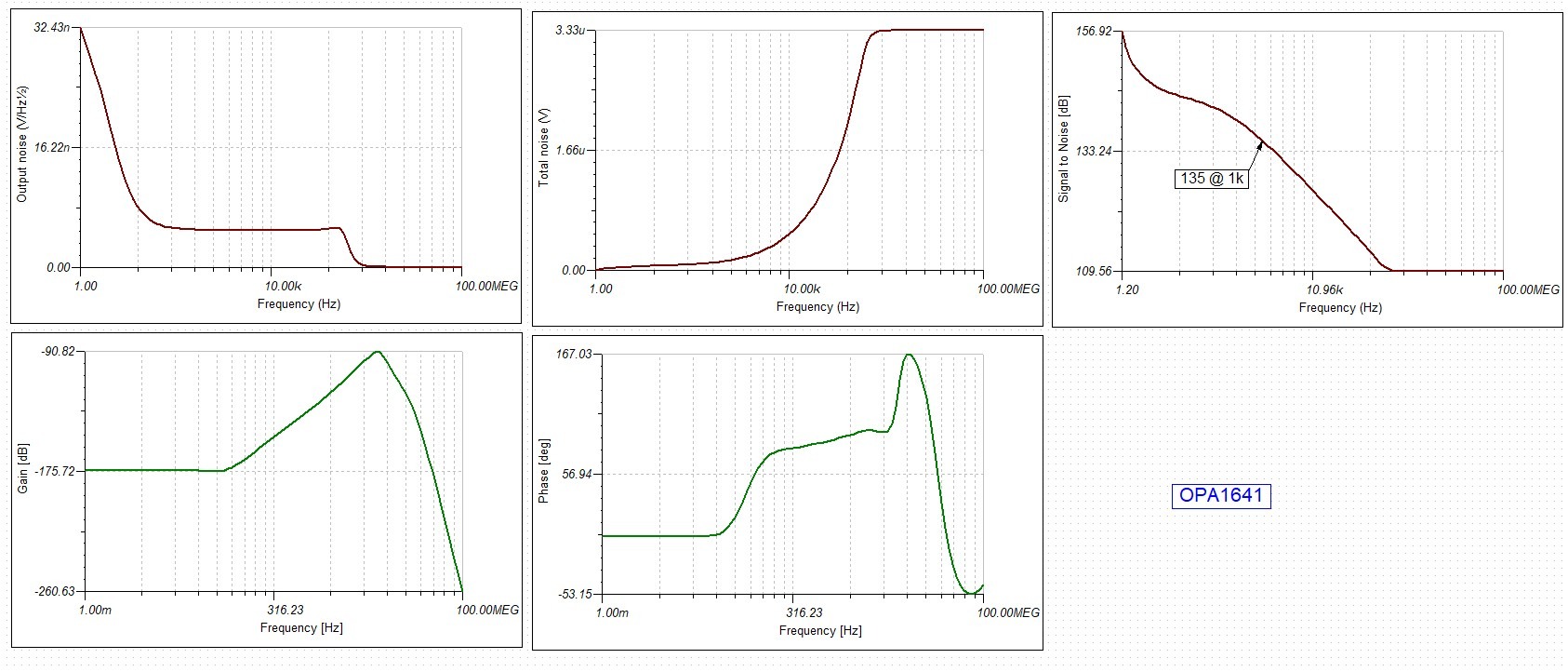

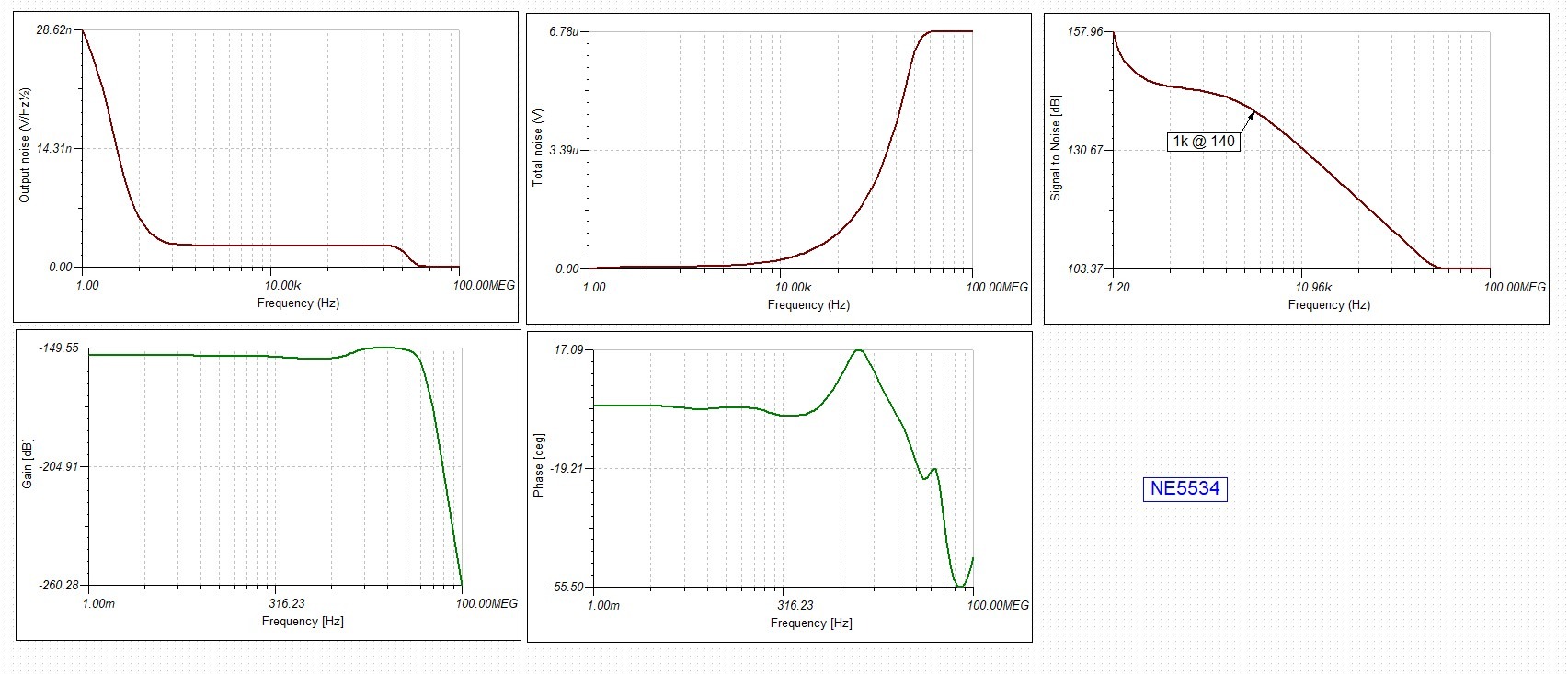

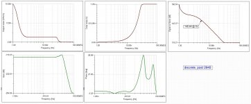

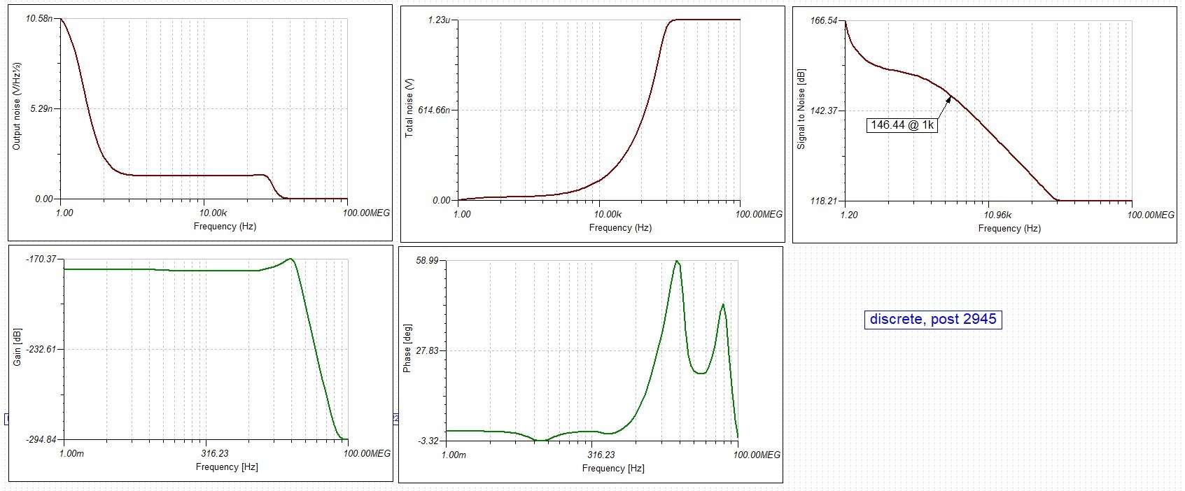

I have tried many opamps in simulation no one gives smooth and linear results than NE5534, right now I have simulated OPA1641 for the first time, its good results but stil NE5534 is smooth and the best? Please see simulation grafs
Something is not right. Did you arrange grounds like at attached picture? I’m getting 125 dB PSRR.
How much resistance and AC ripple should I add to the voltage source to add to the DC?
Just try some extreme opposite values to check, like 1 mΩ/1Ω and 0V/1 V AC ripple.

Maybe NE5534 is better in simulation but not in real world, let's say AD825 is much better and even better than AD825 are OPA1641 or ADA4610 and they are all jfet op amps.
And why jfet?

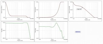

Datasheet of the NE5534 says that opamp is suitable for servo error amplifiers but OPA1641 more for audio purpose, does it have sense and does simulation have sense at all? I rely have no idea why simulation give better result on ne5534 than opa, thats strange, even discrete version give better result than booth, strange.
