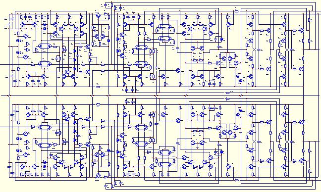

G.Kleinschmidt said:
Dude, I've done this already! Check this out: 🙂
http://homepages.picknowl.com.au/glenk/hybrid2.jpg
Glen
... so super preamp has turned into a power hybrid
... in this latest version
lineup
😀 just kidding
... But what is stopping you from uploading
... latest version of super preamp
... To me, it would not be more trouble
... than have to login to mailbox and send emails with attachments

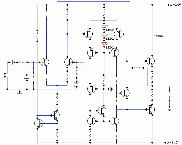

Well, with hope that this won't disappoint you (there is no reason why it
should, because your design is excellent!), I know for very similar design
done about 6 years ago by Dr. Jagodic (boraomega on this forum). In recent
years, several people built flat = LINE preamps based on this schematic
(with minor mods) and it is one of better line preamps I heard so far.
Those designs on his WEB site are mostly his medium class designs but his
HighEnd designs he never published because of commercial reasons. Just few
close friends have access to that collection. Here is the schematic. Sorry
no components values, it will be unfair to Bora if I put values.

Because that Hybrid power amp schematic .jpg took about 50 minutes to "PrintScreen" multiple zoomed-in sections and then tediously put them all together using Microsoft Paint.
My schematic drawing program only saves files in *.SCH format, which can only be read by people with the same software.

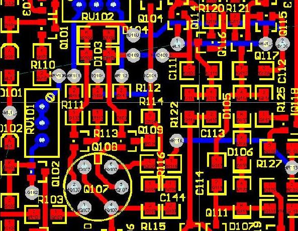

I'll post the final schematic when I'm finished! At the moment I'm very busy laying out the PCB.
Glen
Re: !
That's so close to my design it's not funny! Damn it! Every time I think I've designed something unique, I find that someone else has done it already!
Glen

Lineup, if I zoom out so that it all fits into the screen, it looks like the files I've attached in this thread already - pretty much unreadable.
Glen

G.Kleinschmidt said:A quick peek-a-boo.
A very small section of the nearly finished preamplifier board. The component designators are currently all over the place, but I’ll tidy that up last of all, after adding the star point earthing scheme on the bottom layer.
That's looking really good. I see you've used U404s rather than their SST versions... Is this a local availability thing?
I'm naughty, and often just leave designators off altogether with smaller stuff. I figure I can always print out a mudmap so that I can see what goes where.
Suzy

Lineup, that's basically the window size in of my schematic drawing program. Even if the whole schematic was shrunk down to 1024 X768 it would still be rather crappy.
Thanks, and yes, the U404 are a Farnell part. I've also changed the cascode jfets to individual devices; SST201 (also from Farnell).
Suzy [/B]
It probably would be a bit pedantic to keep all the designators and tidy them all up - I'll be etching this board myself after all 🙂
Glen
Glen
I see.
Guess you could post the full final schematic of Super Amp
at some website, later.
It would be nice to try to understand and explore your circuit
not only for me, I think.
If I get a PDF for download, I would try to make some images from it.
I might need 2 images to cover the whole amp circuit.
