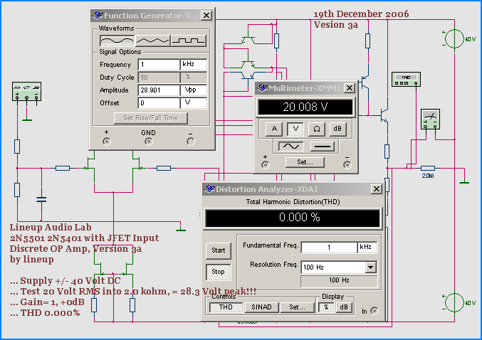

Lineup Original Design - Discrete Op Amp - 2N5551 2N5401
My most promising discrete opamp circuit, so far.
See attachment for circuit simulation test result.
Those 100 Volt JFET used can be ordered here: http://www.ampslab.com/components_fets.htm
Some additional facts of my discrete OP Amp.
Max 100 Volt DC single supply.
Max +/-50 Volt DC dual supply.
lineup
http://lineup.awardspace.com/
Lineup Original Topology:
1. Dual JFET input. JFET current source.
2. Complementary 2N5551, 2N5401 stage. To integrate gain from input stage.
3. Output Diamond Follower Buffer using 2N5551 and 2N5401. Biased with current sources.
Global Negative Feedback from Output to Input JFET stage.
Transistors used (not including current sources):
2 x 2SK373 (n-fet) 100 Volt DS
3 x 2N5551 (npn) 160 Volt CE
4 x 2N5401 (pnp) 150 Volt CE
Gives:
09 active Transistors
12 other Transistors used for current sources etc.
Total number = 21 transistors.
Power Supply:
+40 and -40 Volt DC
Total Supply Current, Idle: 11.3 mA
DC Input. Upper Frequency -3.0 dB roll off at 350 kHz
Bandwidth: DC - 350.000 hertz
20 Volt RMS, Test1:
Unity Gain ( x0.98; -0.18dB )
1.000 hertz, 1 kHz sinus
28.9 Volt peak input into 47 kohm
28.3 Volt peak output into 2 kohm = 20 Volt RMS
Result:
Distortion THD 0.000%
2nd harm: -107 dB
3rd harm: -115 dB
4th harm: -137 dB
Other harmonics are all below -130 dB
