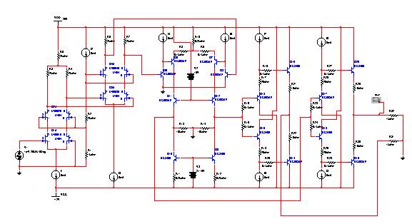

Attached below is a preliminary simulation of a fully differential preamplifier I’ve designed to give 100mVrms sensitivity to the 512+512W rms class A power amplifier I’m building.
The input stage is comprised of two cascaded, cascoded differential amplifiers using precision matched U404 JFETs running low drain load resistance (2k) to keep the bandwidth high and relatively high tail currents (5mA), to keep gm high so as to get a decent amount of voltage gain out of each stage.
An emitter follower buffered and cascoded differential VAS follows. Although not simulated yet, the common mode output voltage of the VAS outputs will be steered to 0V with a servo (as is necessary with the differential op-amp topology). For simulation purposes, I just tweaked the value of the VAS current sink bias battery to get the common mode voltage to 0V. The differential VAS is heavily emitter-degenerated for the best linearity and a pair of “diamond buffers” form the complementary output stages.
Simulation results so far look promising:
Single ended open loop gain is 72.9dB with the –3dB roll off point at 1.2MHz.
Open loop THD driving 8Vp-p (approx 2mVp-p single ended input) into 1000 ohms at 20kHz is just 0.034%
This thing is going to run with a closed loop gain of about 20.
I think I’ve pretty much optimised the design the best I can for the lowest THD. Before finalising the design and starting to layout the PCB I just though I’d just post the design here to see if anyone out there spot any obvious improvements.
Glen

Interesting G.Klein 🙂
I know you are good with transistors (from suzyj guitar preamp topic)
Could you just attach a bit bigger image.
Then I am sure several will be able to tell,
what they think is good or less good.

OK, here it is. With differential feedback applied and the common mode voltage servo added.
One thing I should have mentioned in the first post is that I’m using a differential preamplifier because my power amplifier is bridged design, which has differential inputs. Also note that this is a single ended input to differential output design. Due to the differential feedback, it necessarily has low input impedance (2k).
This preamp is to be preceded with a discrete fet input voltage follower configured op-amp to give high input impedance.
Glen
Glen

1) My Class A design uses a low voltage power supply for the Class A stages which are driven by class A/B stages to track the output voltage. It dissipates approximately 320W of idle power per channel.
Preliminary schematic here:
http://homepages.picknowl.com.au/glenk/hybrid2.jpg
I’ve already deigned most of the PCB’s for the power amp too.
2) I’ve engineered amplifiers much bigger than this and I have a pretty good idea of how much it’s going to cost. The heat sinks are on order.
3) This isn’t a minimalist design. It's deliberately over the top.
4) I’m going to design the boards. I’ve designed boards for a living for circuits a ship load more complex than this, so it’s hardly a problem. The boards won’t be done with a dalo pen or sticky strips either.
5) I'm not asking anyone here put off by its complexity to build it.
With all that out the way, does anyone have any constructive comments, or am I wasting my time here?
Glen

What a beast!
Just one comment (for now - I'm digesting your schematic in small chunks from input to output): Why are you using JFETs as cascodes? I'd have thought an a cascode application, most any old bipolar would do. They don't have to be particularly well matched.
Incidentally, what sort of THD and signal swing numbers are you getting from that?
Suzy
Suzy

suzyj said:What a beast!
Yeah, and you thought you’re guitar preamp was controversial! 🙂
Bipolar transistors introduce distortion when used as cascode devices. Their Ic is equal to Ib+Ie, and Ib varies non-linearly with Ic. Of course, we’re talking only a very small distortion contribution here, but since this is such an over the top design anyway, I figure why not just blow a few extra dollars on the jfets!
With feedback applied I can’t get the THD simulator to read above 0.000% 20Hz-20kHz into a 5k load unless I drive it into clipping at about 10V peak (20V peak differential). This is way above the drive requirements for my power amp too.
A point worth noting is that the THD must be measured differentially, as the nfb acts differentially. To do this in the simulator, I just compined the differential outputs with a dummy differential input amplifer made with a prefect "virtual" op-amp component.
If you measured one of the two outputs with respect to ground, you’ll just be measuring the open loop THD.
Here’s a good primer on differential op-amps:
http://focus.ti.com/lit/an/slyt165/slyt165.pdf
Oh, and to add to the controversy, here’s the voltage follower buffer that’s going to precede this differential preamp 🙂
