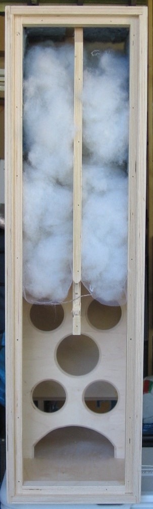

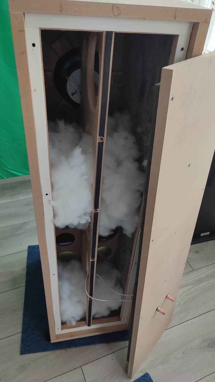

I`ll added some stuffing into my Pensils and I have to admit: it works! Bass is much deeper and punchy, midds are clearer, I like that. High`s do not dominating like before. Sound is balanced, and consistent. Thanks everyone for advise! I have to experiment a bit with quantity of stuffing in the box, but it`s a good direction.
You need to tease the polyfil out more, make it fluffier. And start from the top down like the pic.

Truly amazes me that it was the lack of fluffed/teased poly that was needed.I`ll added some stuffing into my Pensils and I have to admit: it works! Bass is much deeper and punchy, midds are clearer, I like that. High`s do not dominating like before. Sound is balanced, and consistent. Thanks everyone for advise! I have to experiment a bit with quantity of stuffing in the box, but it`s a good direction.

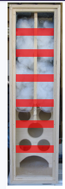

For bracing, a couple of 1x2 criss cross the enclosure would not be sufficient, maybe even 2 rows, front and back?
@Scottmoose
=For bracing, a couple of 1x2 criss cross the enclosure would not be sufficient, maybe even 2 rows, front and back?
Not nearly as good, better than nothing.
dave
I’d still want to brace the front panel to rear as well, as per the photo of Jeff’s Super Pensils in post #22. I certainly did so in my A7.3 and 10.3 Pensils.
And a zillion others as well.
A driver holey brace is something i have considered for an over-the-top Frugel-Horn.
It is not included because A/ the dimensions and “brace” at the top make for a sigificantly stiff part of the enclosure. B/ sort of like the reason it is MIA in most drawings — simplicity, but it would be more difficult, and unlike thePensil where the big difference would be in the Pensil cabinet walls are braced, in a FH itwould be a much subtler difference midTop.
