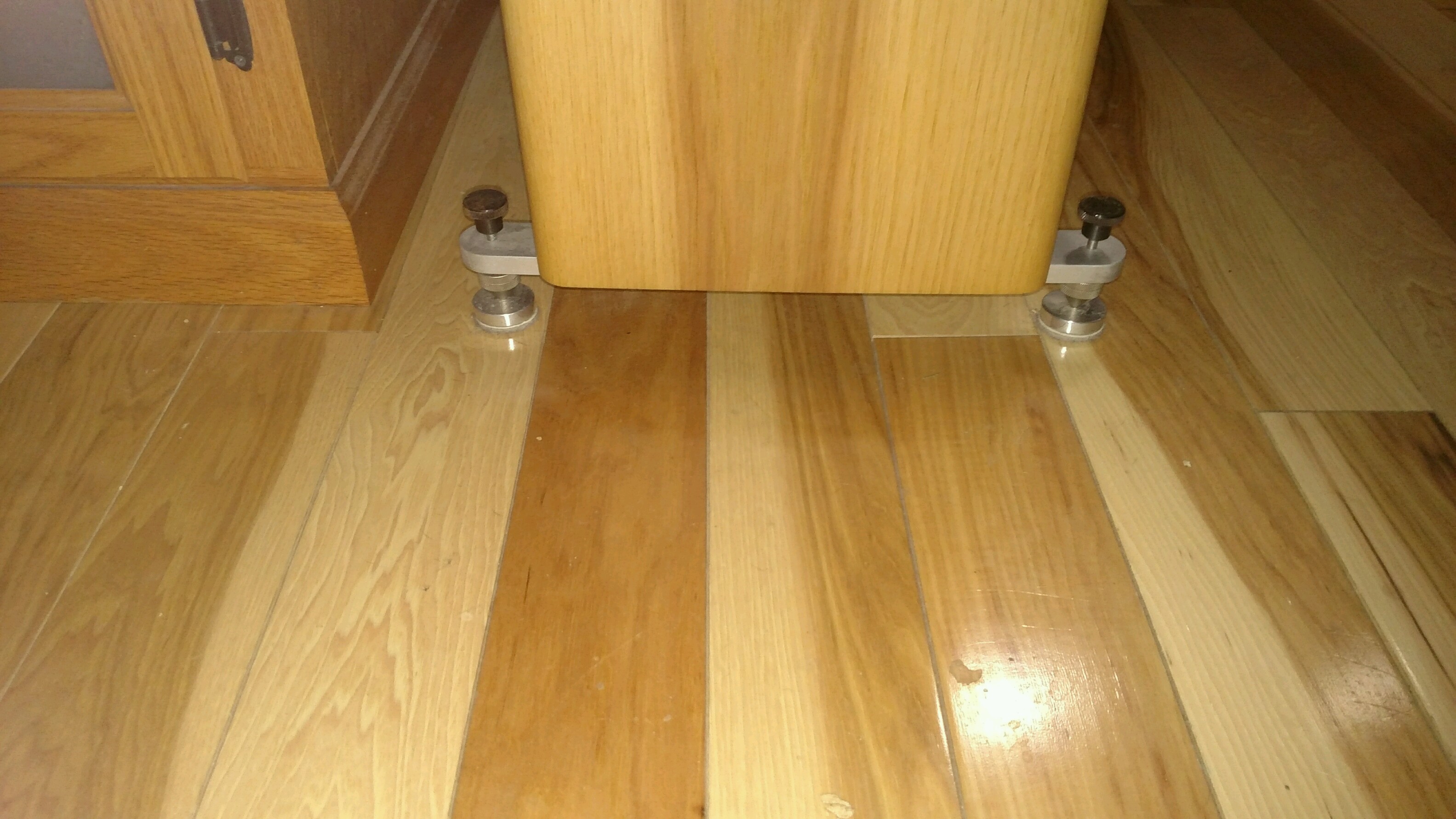

This what I have come up, mostly out of necessity due to the fact that I have hardwood floors.
The felt under the pucks allow me to move them easily (the speakers I am currently running are 48" tall, not sure on the weight, you do not want to lift it yourself.
I can level them ( I am a carpenters son, true to the world means a lot).
Cost for me around $100.00.

I use felt to. Either on the bottom of the speakers, or on something like the picture you have shown. Carpet is a breeding ground for all sorts of nasty small creatures.

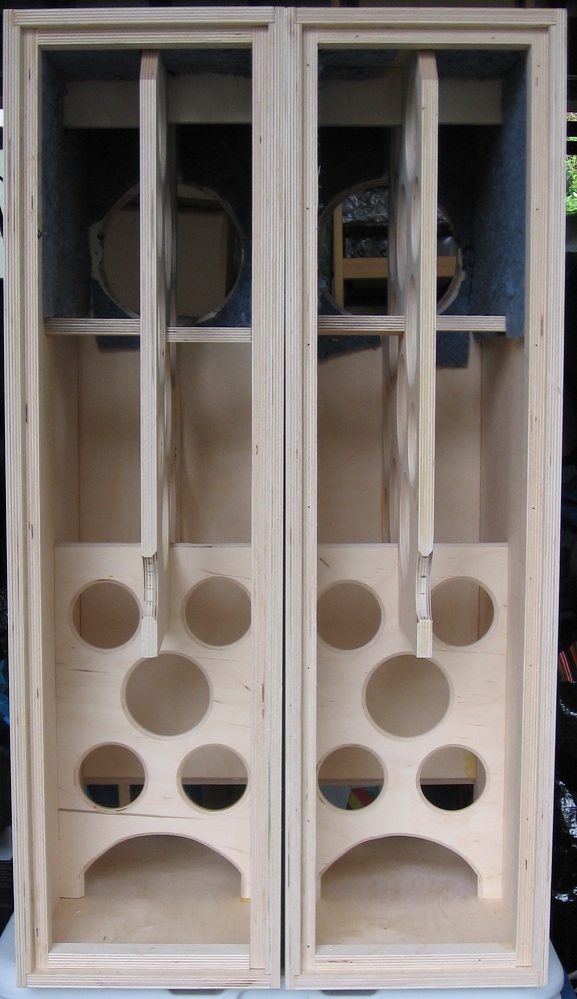

Well finally got back to this project and got all of my panels cut, using Baltic Birch.
After doing my panels the only question I have is the the two side brace heights.
Do not know if it is really critical or not but the original plans did not give a dimension.
Looks to me like they are in the 24" inch tall range, good to go?

Yeah, 24" looks about right. Here's a pic of mine showing the bracing.

Thank you sir.
Your pic provided me with some other info I was wondering about.
Did you put that material on the back as well?
Thanks, Greg

Yes, just to the same height as the front. It's Ultratouch recycled denim, and not strictly necessary for this style of cab.

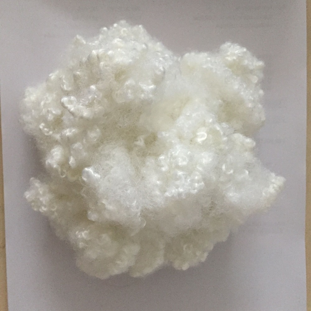

Looks promising! Can recycled cotton insulation be used for the damping, instead of the poly-fiber? Something like this: Metisse katoenisolatie | Eurabo
If you tease it out at least a bit. We used it in a couple of lines, including microTowers.

WoVe,
My understanding is that the felt like insulation material that you have shared the linked for can be used for "lining" the inside of the cabinet, and can be useful for bass reflex type cabinets. For a TL or MLTL cabinet (the Pensil is a MLTL variant), you need the loose poly-fill stuffing, preferably Dacron hollow fill. The poly-fill can be sourced from craft stores or even taken out of pillows. I have attached an image from Google search for your reference - when installing in the cabinet you will need to "tease" this out so that it is more fluffy.
With the lining material you can use a few pieces on the sides and back wall near the driver, to absorb "early reflections", but you still need to use the poly-fill material.

There is much less dense UltraTouch wall insulation that can be teased out and serve the same role as polystuff.

Thank you Dave. I actually have a some of that material too - used it in a P10 Half-Tower MLTL build and it worked out well.
The link WoVe posted has an image of a material that looked more compact and dense, like a felt. I guess it would be more difficult to tease that out. 🙂
