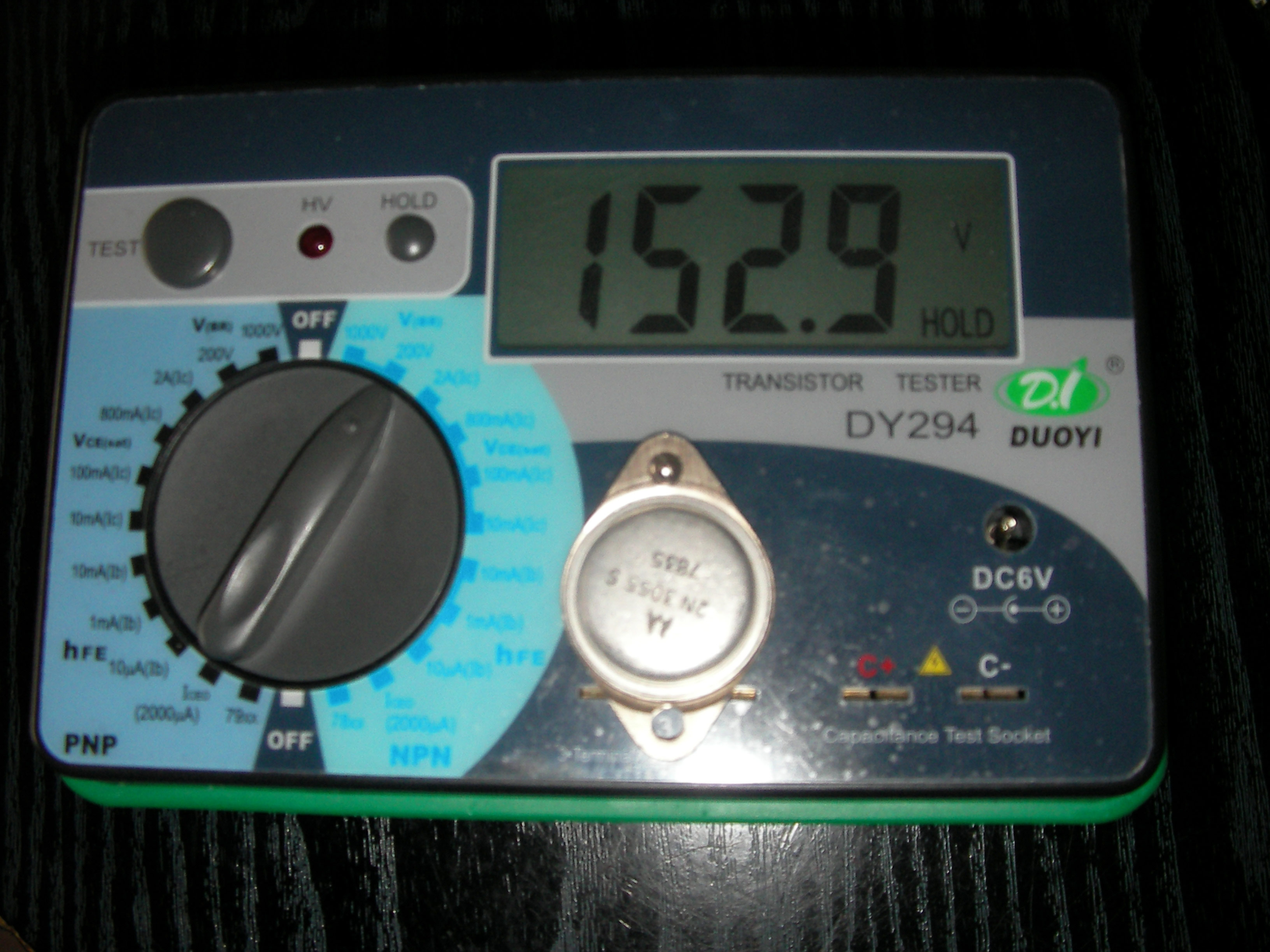

Those 2N3773's look fake to me. I consulted for a company doing counterfeit analysis
and the first step is to see if the markings come off with acetone or alcohol. Also the
font could give a hint.
I would not doubt if all those 2n3055s would pass a 100V Vce if they are from the 1980s.
The H's should be 90 or 100V by spec.
Note also, that from the start they were rated at 60V with the base open, but with a 100 ohm
resistor to the emitter the rating was 70V.

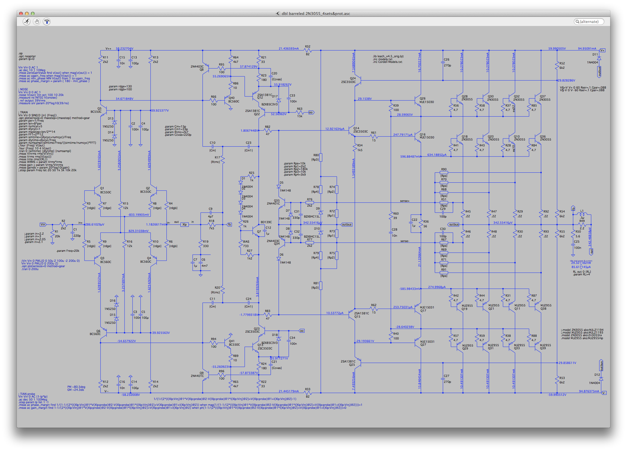

Do you check distortion in the error log? There are warnings there of multiple definitions
of transistors etc., this should be cleaned up. I might have introduced them when I made
the library changes.

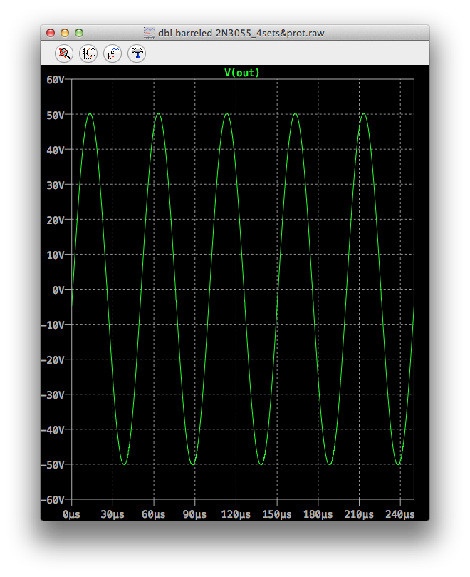

Considering distortion, you don't usually rate an amps power right below clipping the
performance of the parts is so bad at low Vce you just can't expect low THD.
First step was to lower vin to 2.3 for about 49 Vp out.
Next I removed the jumper across the feedback cap, DC offset increases distortion.

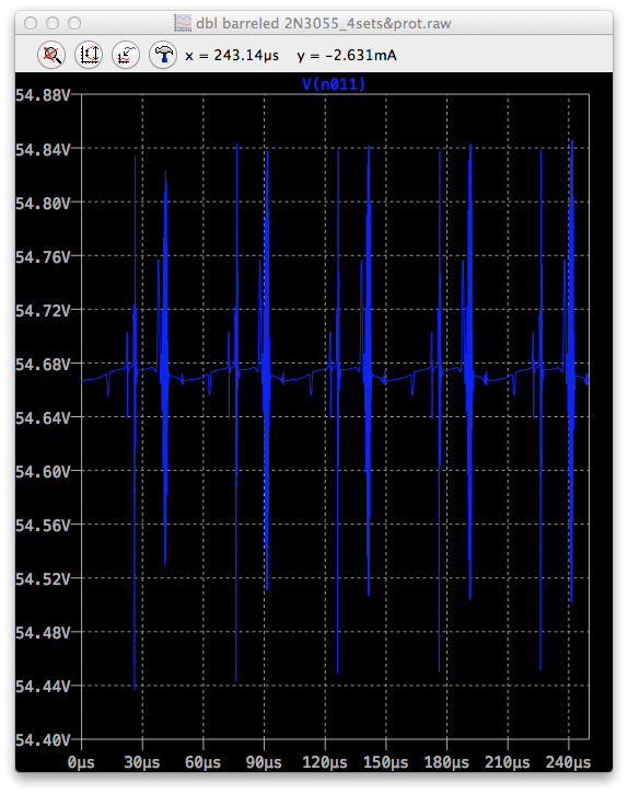

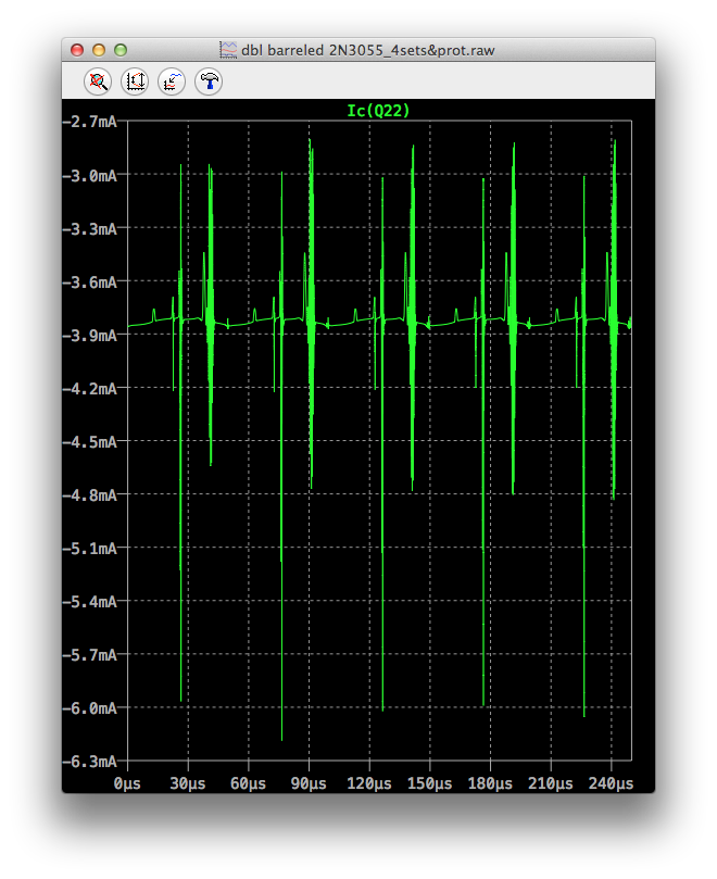

I think that the 220R was high because Leach did not have high current drivers, I lowered
it to 51 ohms, lowered the 330s to 150, added a Self "speed up" cap across the 51R that
gets rid of glitching in the output stage.
Lowered VAS degen from 390 to 100 R. I like to run the drivers and VAS with a decent amount
of current but try to keep the Pdiss to reasonable levels. These changes gave about 1.5W in
the drivers and about .5 in pre and VAS. I rebiased the outputs for about 50 - 70 mA, go lower
if you want to save heat/power.
The Leach amp never had low distortion at HF, I seem to remember .5% even with modern
parts. I noticed that there was attenuation in the FR at 20 KHz and narrowed this down to
the 47pF which I reduced to 10pF. It needs more feedback to clean up the output stage
so I removed the 180 pF, and added 10pF across the feedback resistor. There is still not
enough loop gain for HF distortion reduction, I added .5uF across the VAS degen, this
makes it more like a Self design at HF. All these changes led to a 20 KHz THD of about
.21%, and much less at 1KHz.

Those 2N3773's look fake to me. I consulted for a company doing counterfeit analysis and the first step is to see if the markings come off with acetone or alcohol. Also the font could give a hint.
They are rather old, and I figured they could be from before the fakes were around. But it's not impossible, maybe early counterfeits.
I'll have to try some things to check them out. I have close to 60 of those.
Maybe one of them was slightly used and perhaps I could venture into cutting odd the top, to see its guts. Those don't lie, when they're fake, the guts tell all.
I would not doubt if all those 2n3055s would pass a 100V Vce if they are from the 1980s. The H's should be 90 or 100V by spec.
It's all dependent on when they started making the new ones, so who knows?
I have doubts about those H, but I hope they're legit. The specs definitely was for 100V Vce0 back then.
Note also, that from the start they were rated at 60V with the base open, but with a 100 ohm resistor to the emitter the rating was 70V.
I always wondered what they meant for VceR. It's always higher than Vce0.
Why would they stand better the voltage that way?
Of course, that's the only place to look for that info.
There are warnings there of multiple definitions of transistors etc., this should be cleaned up. I might have introduced them when I made the library changes.
I didn't pay attention to those dupes. They're pretty harmless, but it may imply the wrong one is actually being used. I will have to clean this up.
Considering distortion, you don't usually rate an amps power right below clipping the performance of the parts is so bad at low Vce you just can't expect low THD.
Perhaps not, but it is still a good indication for whatever may be going on.
Most of my sims showed pretty good thd even right before clipping starts, but not for any of the leach amp's incarnation so far.
My bryston clone with 3055s has really nice performance, all the way up.
Of couse once the first hint of clipping appears, thd goes haywire, but that's normal. I usually set the max level at the highest one before the thd starts climbing, and it's almost always very close to the clipping point.
I had tried that, more or less, I think I tried 1.8, 1.9, 2, 2.05, 2.1, 2.2, etc... Looking for how thd evolves. And it's been much higher than pretty much any other sim I've done.

Ok, for comparisons, here is that sim I mentioned for a 4 output device sets, with the protections hooked up.
As mentioned, I didn't alter leach's original topo on the output stages, I only converted the vas stack to an enhanced hawksford cascode.
I hope I gathered all the pieces right so it will run out of the box.
Using cordell's models, and the same 3055/2955 as earlier (tweaked VAF).
The output signal looks fine, and thd isn't too bad compared to our other versions, and this is on 4ohms resistive load.
When going to 8ohms, thd drops a lot.
The thd dropping so much between 4 and 8ohms should be telling something.
But the bulk of the thd has to be coming from those huge spikes. Take a look at those plots, from the vas output (pretty ugly), and then at vas input, from the ltp (blue trace plot).
This really shows how hard the feedback is working to clean up the signal.
It's quite stable, as the original leach, with very comfortable margins, but something is going on inside that isn't so pretty.
And by the way, the bias in the outputs is at some 10mA, and increasing this bias increases thd. Go figure!

I dug out something I forgot I had, and didn't use much.
I'm not sure if it can truly be trusted, but it's giving useful info.
It's a tester called DY294, and among the tests it can perform, it does breakdown voltage, with 2 ranges, 200 and 1000V.
So I tried this out to see how this works.
I tried on a couple of my 2N3771, which are supposed to have 40V breakdown voltage, and they were well above 100V each.
Then tried a couple of those odd 3773s that are potentially fakes, just for kicks, and one gave more than 200V, the next one well over 250V.
Weird for fakes to be so far above specs.
Then the interesting part is the 3055s. I haven't tried a bunch yet, I was curious about those old Motorola marked with an "S". I wish I knew what that S means.
Anyway, I took a photo, although blurry, we can still see enough.
I pressed the hold button on the test to keep the measurement (see attached).
I wonder how trustworthy the reading is, but if it's right and they all do something like that, then I'm in pretty good shape.
More than 150V breakdown on a 3055, not bad.
Anyone knows that tester? used it?

To understand the speed up cap:
Run the sim and display the output sinewave.
Hover over the cap and click to display the current.
Note the smooth peaks to about 30 mA, a good amount of current.
When the driver turns on it forward biases the connected outputs and without the cap
reverse biases (to turn off) the other side through the 51 ohm resistor. The cap makes
a more solid connection, the duration of the effect of the speed up cap is extended with
a larger value. It is clear that the cap has a powerful effect as seen by the high peak
current.
Next, hover to see the current in one of the power transistor emitter resistors, top and
bottom. Notice how the current is a very clean half sine as it should be.
Clip out the speed up cap, rerun the sim and look again at the somewhat distorted
current due to mutual conduction.

Sim can't find 1N4004 model if you changed them all to C then it would use the Cordell.
2N3055 is still a duplicate model.
