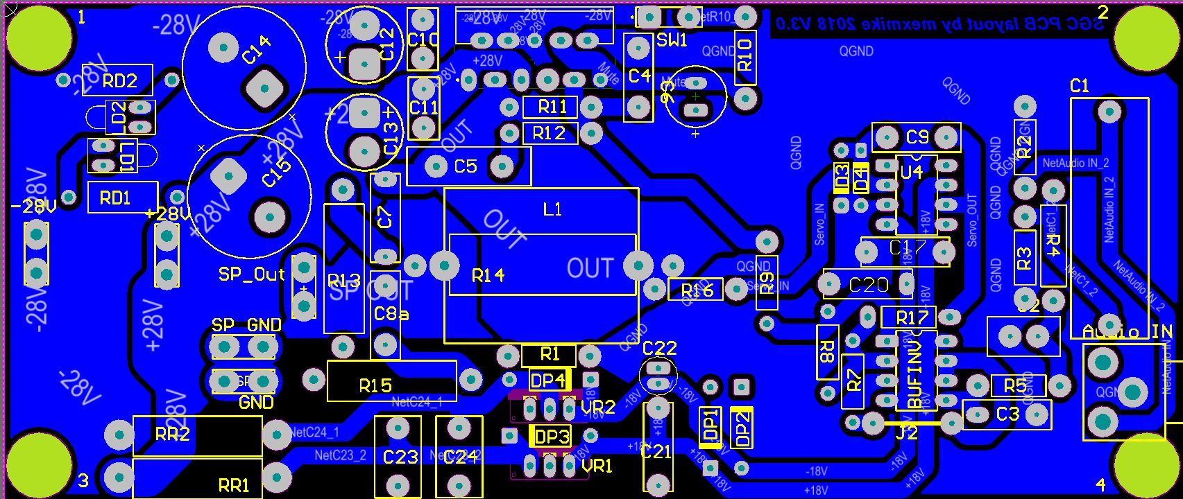

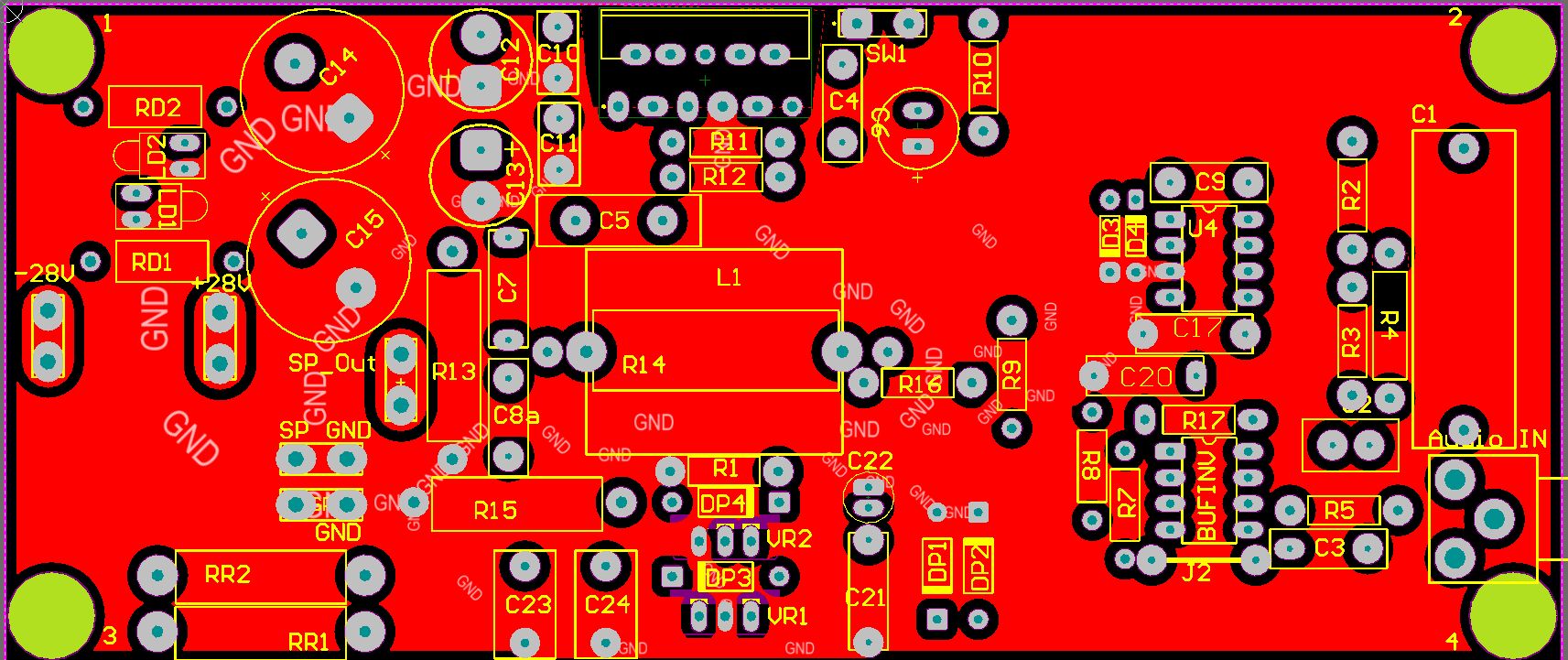

Hi MexMike,
Thank you very much. Thanks for the tip on the L7818 latch-up.
I'm very fond of tube amps, but I don't know how important the Klever Klipper is. Perhaps I can tack it up on a separate board and try it.
Which version of the board do you prefer, the polygons or regular?
Also, are you implementing the mute function?
I was going to add a cheap Ebay UPC1237 delay/dc protection board.
Thank you again and best wishes

I made the mistake of using a Log potentiometer for the Klipper, so nothing happens until the last bit of rotation. I wanted to see if it would be a good amp to use with guitar; adjusting the klipper way ahead of rail voltage to suit. With normal music input, it sounds like the signal is getting attenuated to me, so I decided to forgo it. Bob Cordell has a 1k resistor R1 at the Klipper. It just appears to attenuate the signal, so I omitted it to keep the total resistance of 10.1k at that point in the circuit the same, with or without Klipper. You could maybe use a header there and switch on and off as you choose.
I think the polygons are better; less copper to etch. Just be really carefull of the traces at the LM3886 and some of the smaller caps, they are close. Maybe the gurus can maybe give some input regarding the two versions of my layout, as I am not an expert. The printout is for laser toner obviously.
For the inductor, I went for as close to the 3.3uH as I could get; somewhere near 2.2uH. I used the same inductor design as per the SC200 article. This is basically 1 meter of 1.25mm dia copper wound on a 10mm ID bobbin, 8mm wide. First 7 wraps, then 6.5 wraps. I found a cardboard tube exactly that diameter, did the first 7 wraps and then poured a little superglue over the coils. let it dry, unstuck my fingers and then gingerly did the second 6.5 wraps. You can omit the finger sticking part if you like😀 The 10 Ohm 5W resistor fit perfectly inside the tube. I then had a gash piece of plastic tube that fit exactly over the inductor wraps, followed by more superglue just to keep the inductor nice and solid.
I always use the mute with a switch as I'm too chicken to risk my speakers when testing. I first use a tiny PC speaker before using my Elac and I like to have the switch close by in case something goes tits! I also bought some cheap speaker protection which work great! You can use the 15-18V from the onboard power if you want but I prefer to use a transformer with the additional low voltage windings. for that.
Hope this helps.

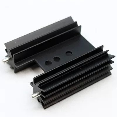

Hi MexMike,
I noticed that you are using the metal-backed LM3886T with mica insulators. What size is the insulator? Do you have a source?
I have been searching the Google with nothing clear. Mouser, Digikey, etc haven't been too helpful.
Thank you again - ziffel

Hi MexMike,
Farnell part No 520-238 fit the Lm3886T. Ive used them in several Neurochrome audio builds.
Hi MexMike,
Actually, I use the mica insulators for the TO-3. I also could not source the exact mica insulators easily.

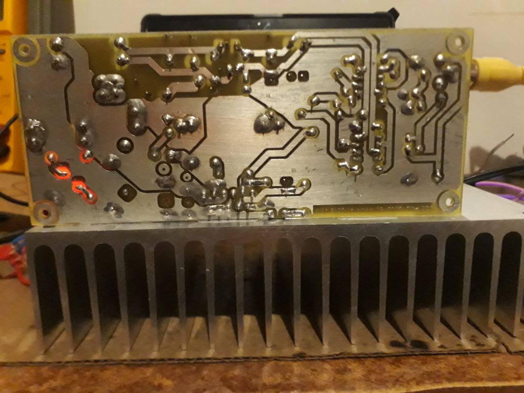

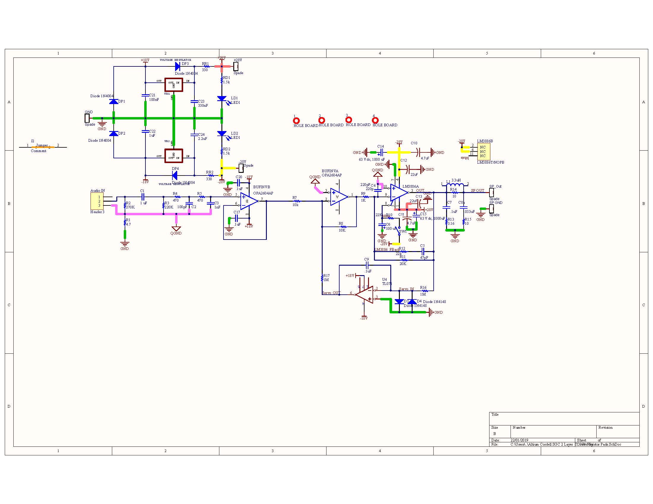

Trying to follow tomchr, 00940 and other kind contributors to my betterment, I have completed one more version of the Cordell SGC; again without the Klipper and this time with the recommended two layers. I managed to use only four through hole vias (keep dropping the little buggers).
Bobs circuit uses a OPA2604 for the Servo, but due to the lower DC Offset, I originally went for the TL072. This time I swapped out the TL072 for a TL071 due to the unused portion of the IC. The DC Offset is still low at 3mV.
As usual I had major problems trying to keep the transfer aligned going through the laminator; not sure what I need to do to improve my alignment! I definitely need to improve how I feed the board through on the second pass. Double sided PCBs amongs other things are definitely my nemesis.
The Ground Plane is on top. The bottom layer has VCC, VEE on the LH side, with the Quiet Ground on the RH side of the board joining the Top layer at R1. I also added a couple of rail voltage indicator LEDs.
My ears can’t tell the difference between the single and two layer versions (maybe both are equally bad layouts ha ha!).
Please feel free to criticize. Hopefully I’m getting closer to a final version and can move on to my next project.
Thanks in advance for any input.

I currently use toner transfer with this modified Apache laminator purchased from ebay...
All steel laminator modified for automatic single-pass PCB toner transfer. | eBay
It does a great job and works as advertised; 6 minutes to transfer without intervention. I do however have problems lining up the second side of the board. How do you get down to 0.25mm error between sides?
Do you do one side at a time or both at once?
My problem is always with aligning the second side!
Cordell Super Gainclone (without Klever Klipper) PDF Prinouts for my two layer board.
-Board Size is 152.048mm by 64.262mm
-Top layer mirrored for toner transfer.
-Pads on layers with no connection have been removed to avoid alignment problems.
-It is my understanding that the NC pins are truly NC and for that reason, I have used them when they get in the way of a track. I found some evidence here:
Simple LM4780 question... and decided that the same may apply to the LM3886 and just went for it. Everything works so it is what it is.
-Paper size is A5.
-The traces at VCC, VEE and Speaker Out are close and need careful checking BEFORE removing toner whilst etching.
-If flux is used for soldering it MUST be thoroughly removed from the board before power up as appears to become conductive after some time. I'm not sure if I've got my facts right but I've had problems in the past that made me think that a board had failed, only to find that cleaning solved the problem.
Its still a work in progress and there is much room for improvement
-Paper size is A5.

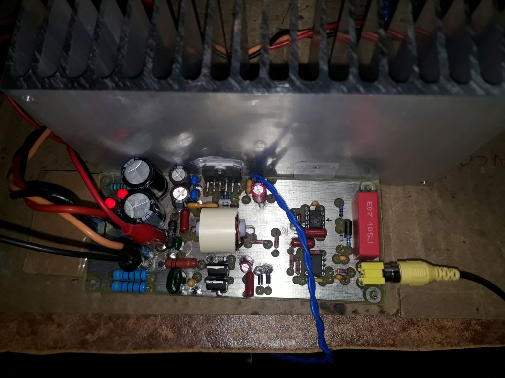

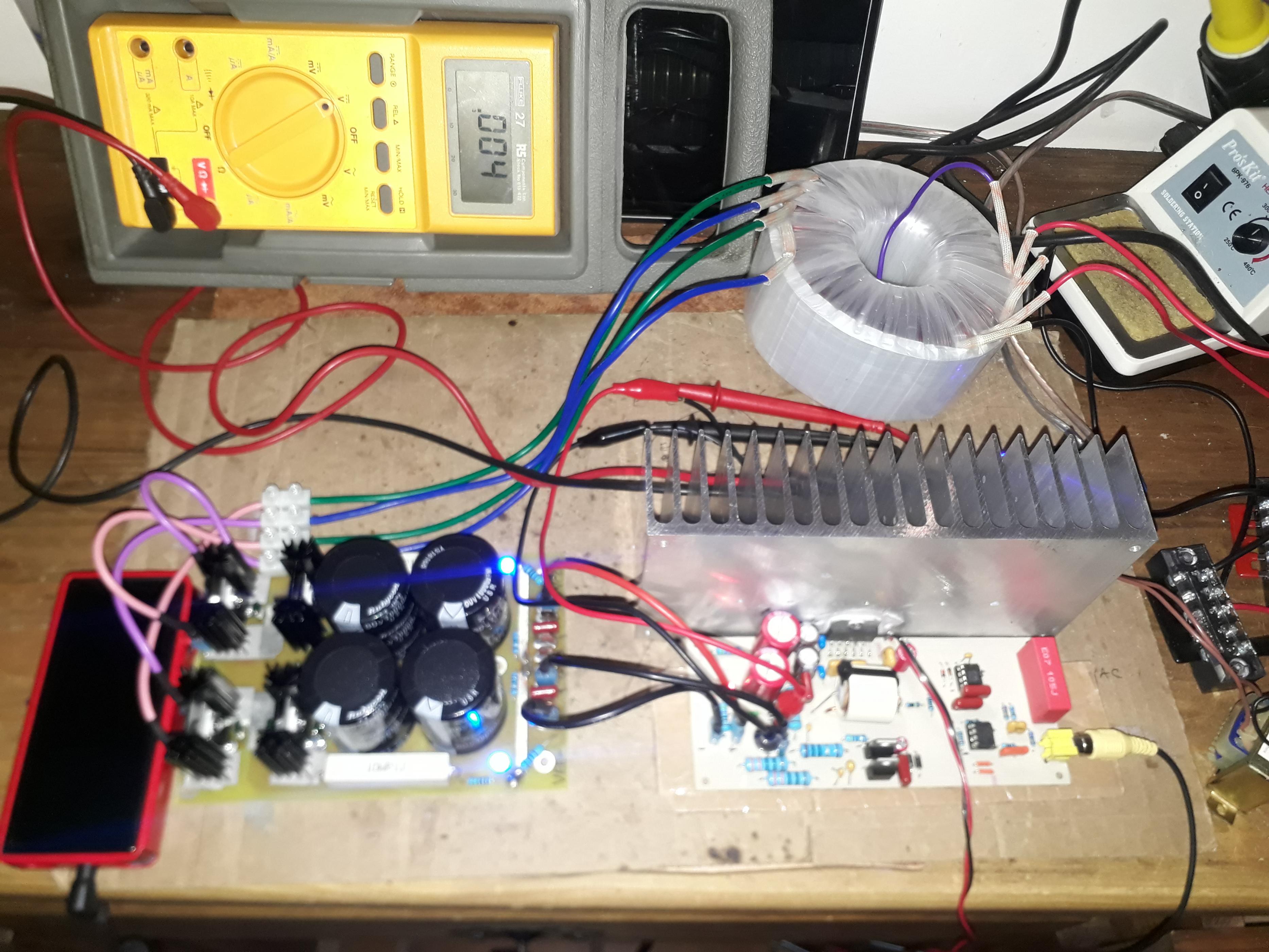

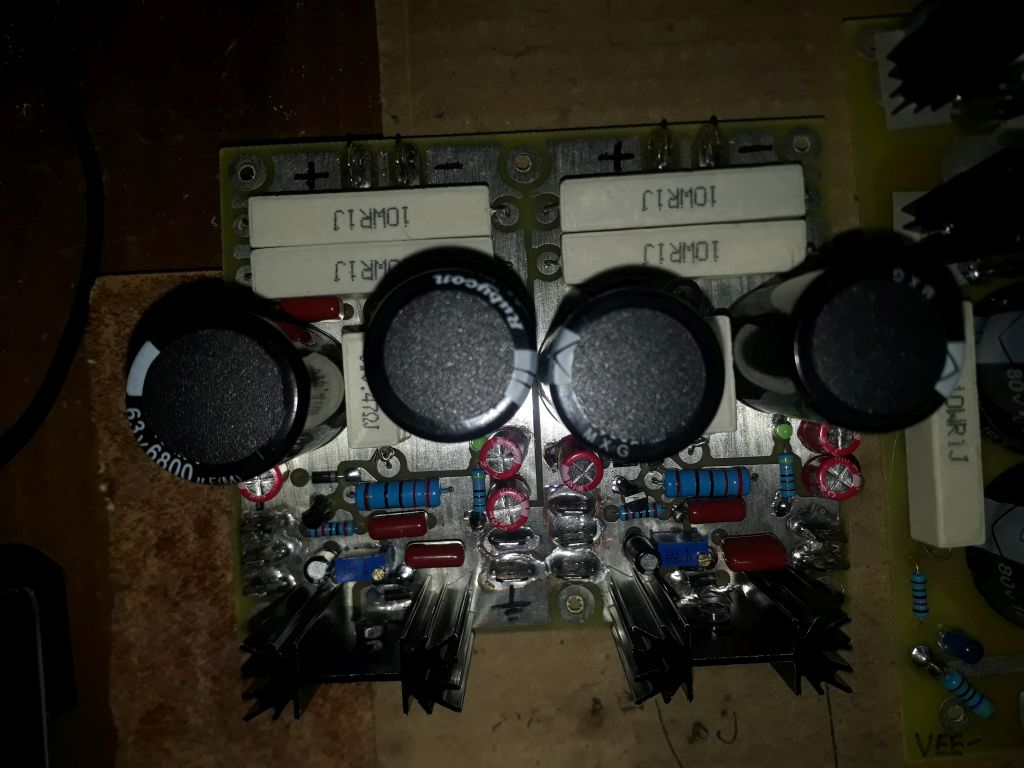

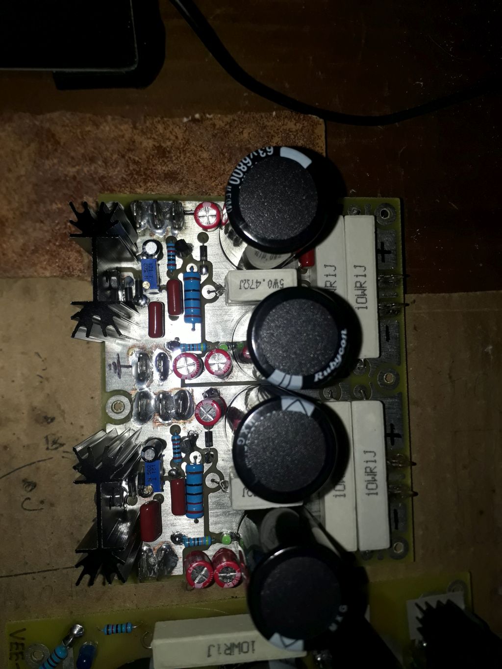

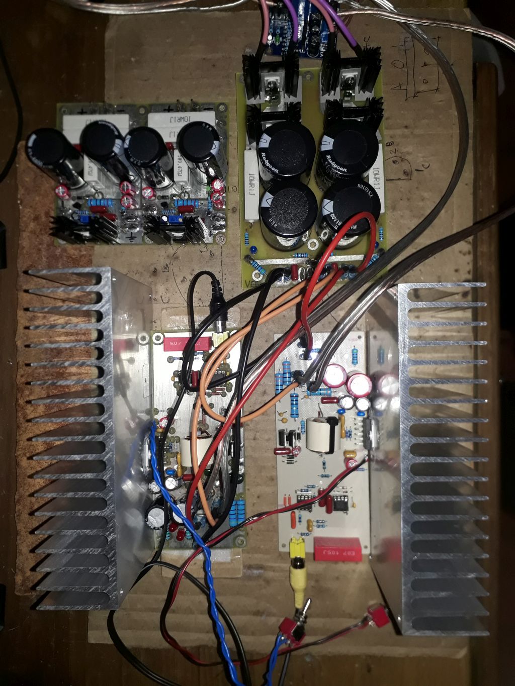

Some photos of my Cordell Super Gainclones. One is single and the other dual layer.
I’ve shown two power supplies in the photos. The reason being is due to a slight calculation hiccup on my part when ordering the transformer. The manufacturers spec for the Antek Toroid AS-3222 300VA of 22V output for 115V input would have been fine for my 4 Ohm speakers, the rectified voltage would have been at the top of the range at around 30V (ref tomchr). Unfortunately, I forgot to take into account that my local voltage is a little higher than US voltage at around 129V, so I get around 34V rectified instead of the 30V that I need from the CRC Power Supply (Class A amplifier).

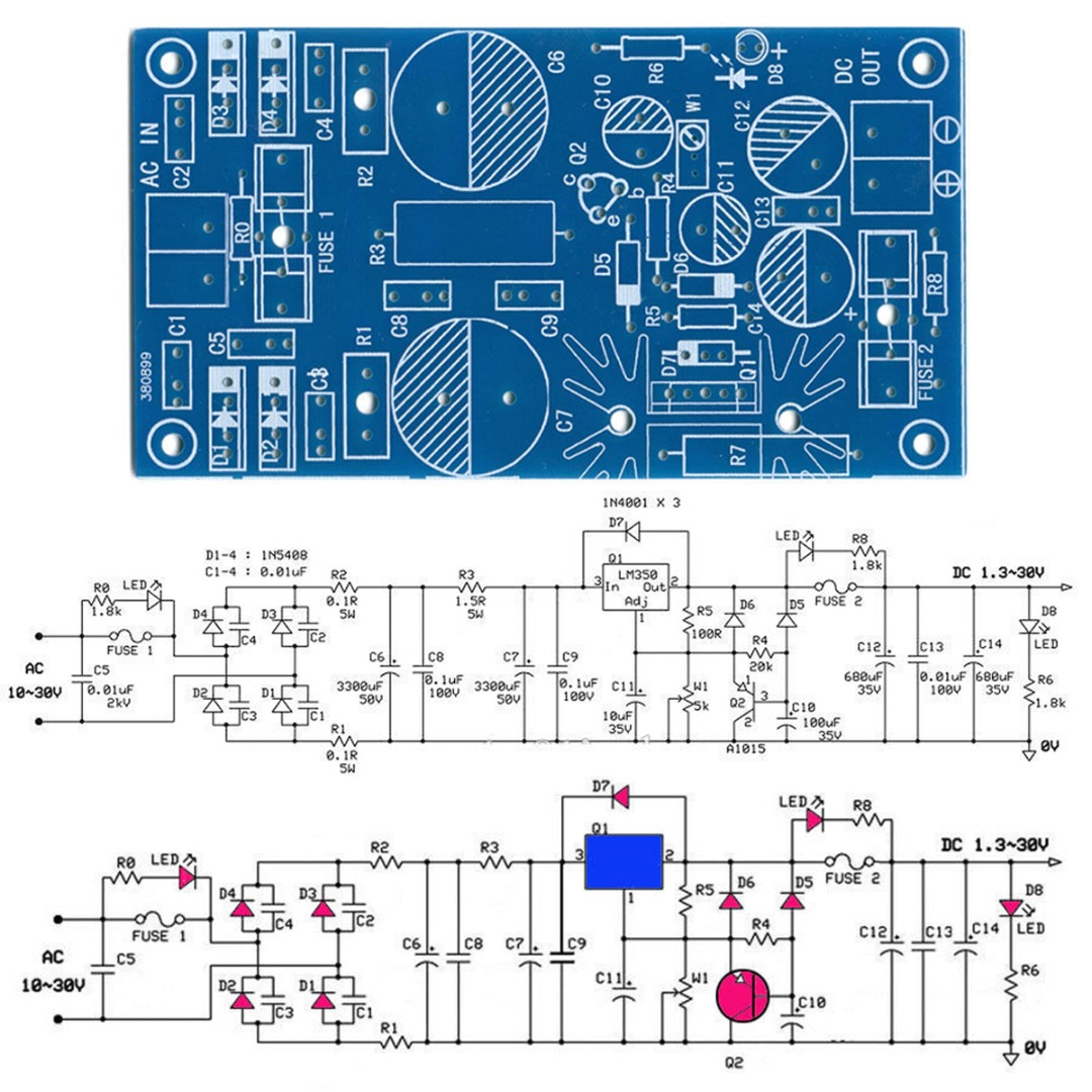

I thought I could use a regulated power supply to drop the voltage. I used the Ebay “Low Noise Distortion Power Supply PCB LM317 LT1083 LM1085 LM350 Supply Bare Kit” (diagram attached) as a template for two side by side positive supplies. I omitted the fuses to save space as the chassis will have its fuse! The supply works fine; zero ripple, slow start and easy to adjust. The only caveat is that I used LM338’s. At max volume, the rail voltage drops to 26V. Both the CRC and regulated power supplies use 0.1 Ohm resistors in series (Dohh!!! I do have one more 0.235 Ohm in the regulated supply. The CRC Power Supply, of course, doesn’t bat an eyelid! I could piggyback two LM338’s but the real estate in my new chassis is severely limited so that’s out of the question.
Next stop will be Chinese LT1083’s. One of the suppliers at aliexpress seems to get good customer reviews for their chips, so I’ll give them a chance before I buy another transformer!
I might bypass the input filter resistors on the LM338’s and see if the the difference in voltage drop is workable. I don’t think it’ll affect the LM3886’s too much.
I do realise that 3V is required for “Line regulation” so may play a part in my problem. I’d also thought that the voltage drop could be put down to the LM338’s reaching their current limits trying to run two LM3886’s but am really not sure of the cause. I guess I should measure the drop directly across the resistors as well.
Any other reason for voltage drop would be much appreciated.
Ive just simmed the circuit. It looks like the resistors are dropping too much voltage to leave room for regulation. If that is the case, I'll remove the resistors and use 25-28V for the LM3886's into 4 ohm.
I'll do a physical tomorrow. Hopefully that's all it is!
the only problem for the lm338T is the power dissipation , but it is an excellent voltage regulator. I would not bother with any Chinese LT series.
