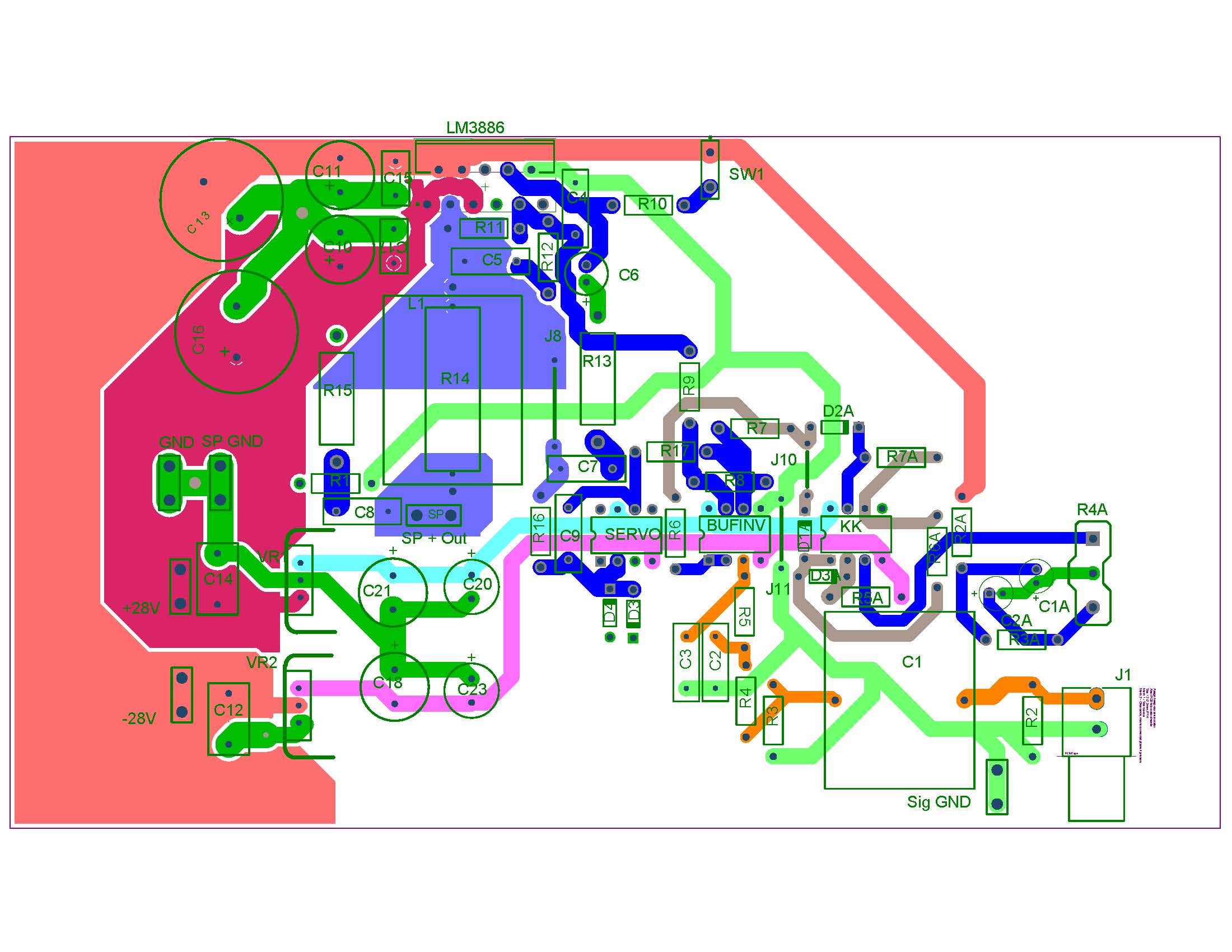

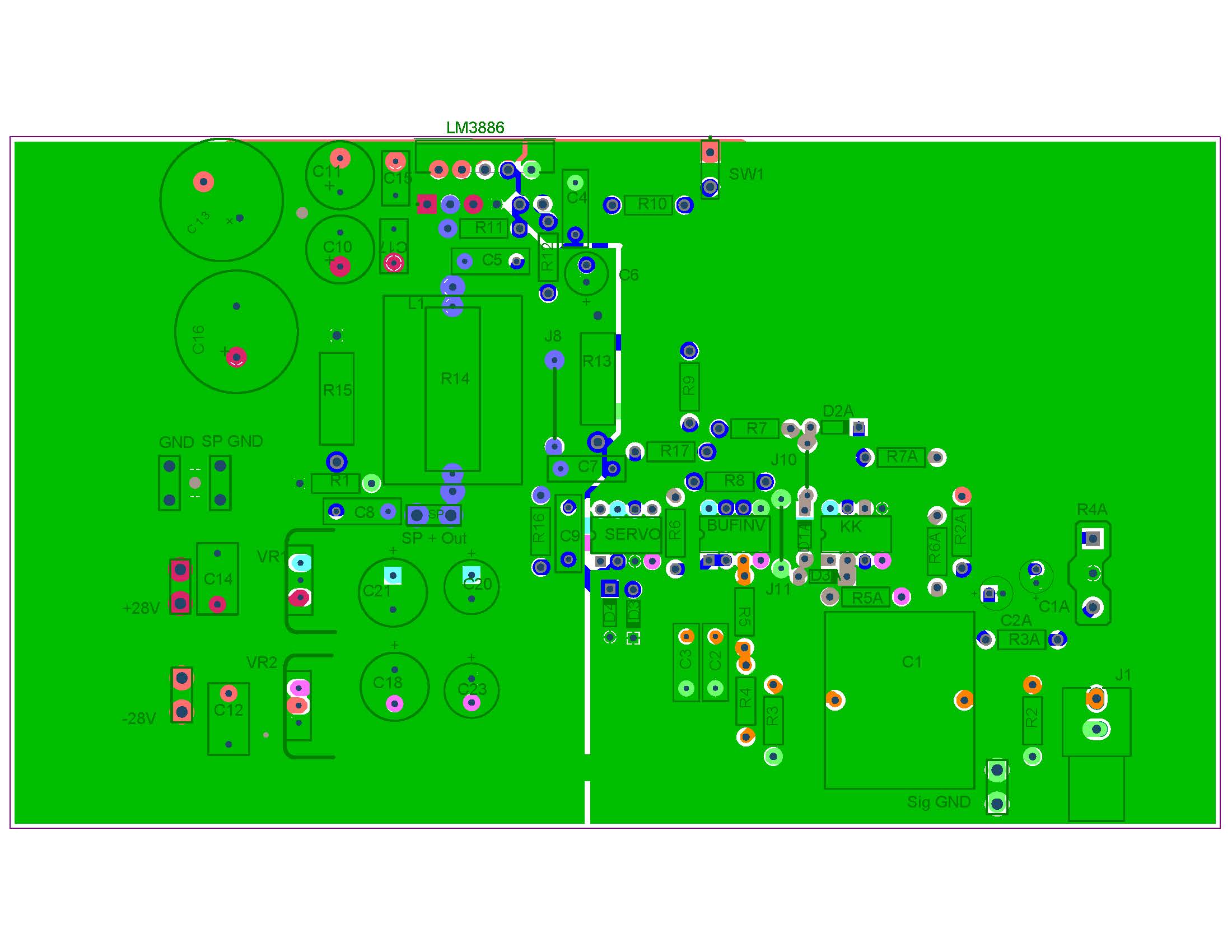

Yes. If you leave the top copper as a solid plane and drill out (countersink) the copper around the pins where you don't want it, I suggest connecting the plane to ground. I would draw it in the layout tool as a copper pour.
The only drawback of home made two-layer boards is that you don't get the thru-plating as 00940 mentioned. You can buy rivet kits that allow you to make your own thru-plated holes, but at that point you may as well send your layout to China and get a couple of boards made. Outfits like Seeed Studio are dirt cheap. I haven't personally used them, but many here seem to have. Alternatively, OSH Park in Oregon is good. They handle their production in the US.

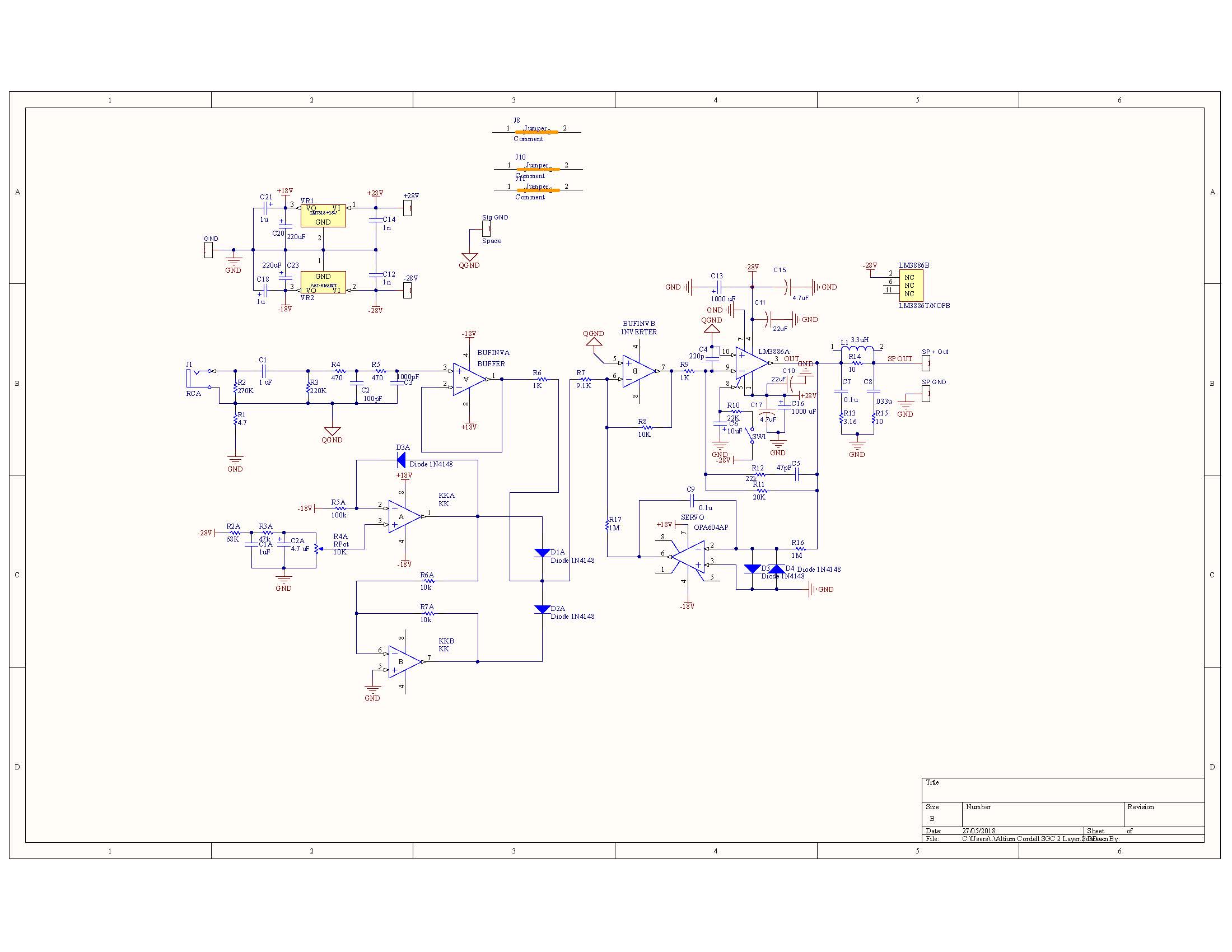

Hi Tom and all contributors to my Cordell SGC layout project.
I’ve had another go at the layout using two layers as recommended. I went for the bottom layer as ground though Tom!. Yes, I’m still a beginner!
I couldn’t figure out how to solder under the components that had the pins underneath them (never used vias before!). If I DIY the board, then they’ll have to be solid wire vias next to the offending items, I believe?
I’m really not sure about the power planes! I imagine they are in the wrong places, wrong size, missing etc. Hopefully you’ll be able to set me on the right track.
I’ve separated the ground plane into two halves with one track at the bottom joining the two halves, trying to keep the lower power signals on the right hand side of the ground.
I’m confused regarding the quiet ground connection from R1 to main ground next to the Speaker Ground, which is on the higher voltage/ current side of the board. Is that in the right place? It looks like my quiet ground net is all over the place!
Please have a look and let me know if I’ve made any progress regarding your input.
If I can get the thing to work, then I’ll probably get the board fabricated by the pro’s using normal vias at the component leads.
Thanks again.
Mike

Different design objective
excuse me,
the Klever Klipper is really worth to realize it?
another way
Audio Amp Power Limiter
These circuits have different objectives. Rod's limiter is for speaker protection. The Klipper is a soft-limiter to improve audio quality and overcome the issues with overdriving the LM3886. There is a chapter in Cordell about this and the title says it all; "Clipping Control and Civilised Amplifier Behaviour".
I got some feedback from Bob regarding the Klipper.
"I'm glad you like the Klever Klipper. Quite awhile back I auditioned the SGC against a 35 W tube amp I built. People preferred the sound of the SGC with the Klever Klipper turned on, and frequently confused the SGC in that mode with the tube amplifier when they did not know which amplifier was playing".
That's why I am trying to get this design to work. I love the sound of tubes!
