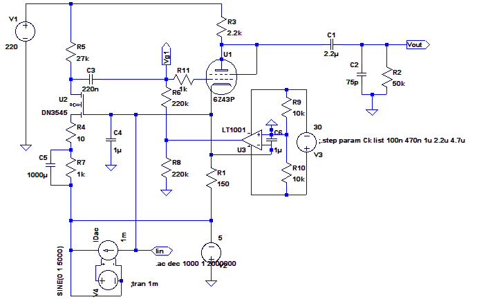

can you upload your LTC file please , to take a look
It seems a "kiss" version as i like
Here you go.
Hi
@Tazzz,
Isn't your schematic a bit like the I/V converter used in Eric Janueda's system High End Audio - Jundac One
Well, I am quite sure it is a very efficient circuit, but our game was to make the signal to cross only valves 😱 The super common gate schematic can also be built with JFET with better results by far. That's a very simple toy with great results, we had no pretention saying this is the best I/V in the world (which surely is not).
@Regal, special for you:
The opamp ensures the cathod is tied to 0V (-2µV in the simulation).... but it means -5V PSU + +-15V for the opamp, complicated PSU unit. Still, signal does only go trough tubes 🙂

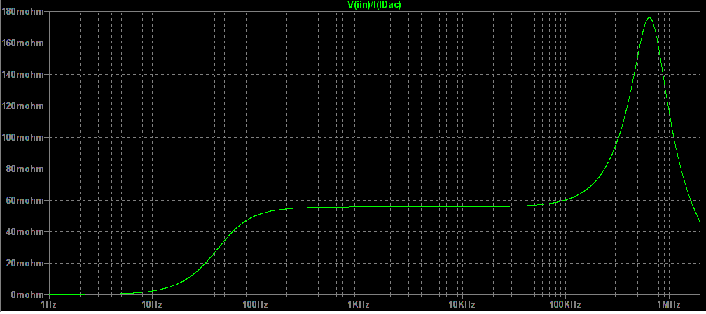

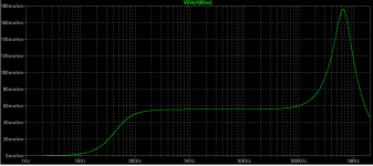

Hi again Chanmix
Nice impedance curve but the version without AOP is better
for phase's curve
Best IV converter surrely not but FREE design for sure
and simple , no exotic or esoteric caps , no expansive valve,
no Xformers (expansive or not) except for power supply
we don't spend much money to get a lot of fun 😀

Hi again Chanmix
for phase's curve
Mmmh isn't the phase important only at output ?
There is a power button for pleasure 😉
greg
Exactly , i'm stupid , I stayed on the curve of Vin as an Eeyore
Forget it

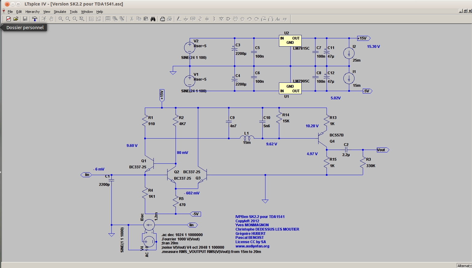

Hi all
We also work on a solid state version for TDA1543 and TDA1541
The IVPBen works just with different voltage
I listen the TDA1541 version everyday integrated in my Philips's drive
Have a look on this here Audiyofan.org • Afficher le sujet - Comvertisseur super kiss pour 1543
see the other page for more info, but in french 😡
the scheme
the scheme
