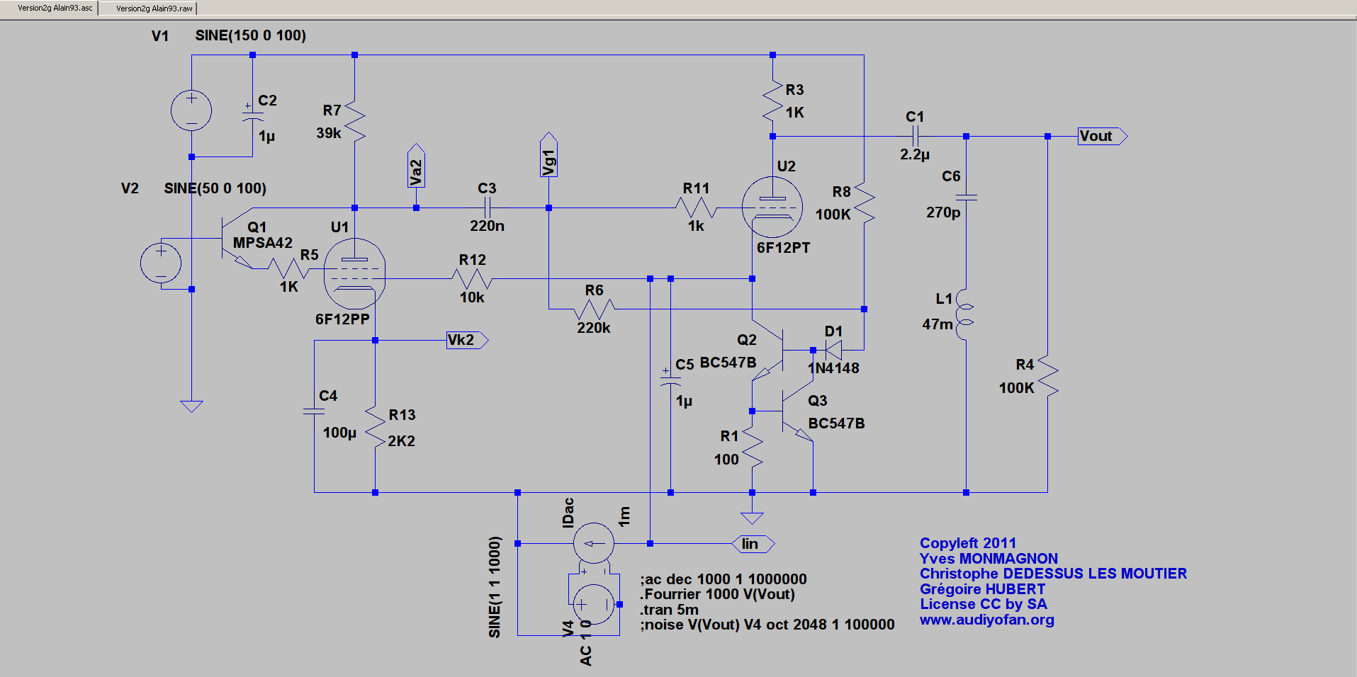

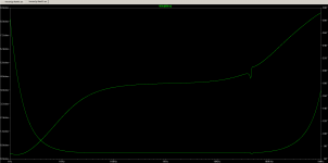

Hi Regal & Tazzz
The scheme of Regal is nearest my first version of IVTCY
indomptable version in fact , with Chanmix & Yves07 we work
on the "super common gate" project to go more in detail
This following capture is my actual version , full tube, with
a notch filter around 44.1 Khz
my power supply is the second (rev 2) in the zip file
the IVCTY the "rev2g alain93" also in the zip file
I listen it every day in reality without any problem
I forgot, for the input impedance the curve is the "U"
Enjoy

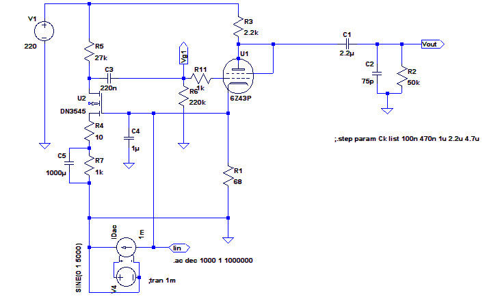

Oh ... The schematic you are working on is quite old, the current source on the pentode's anode led to too much instability.

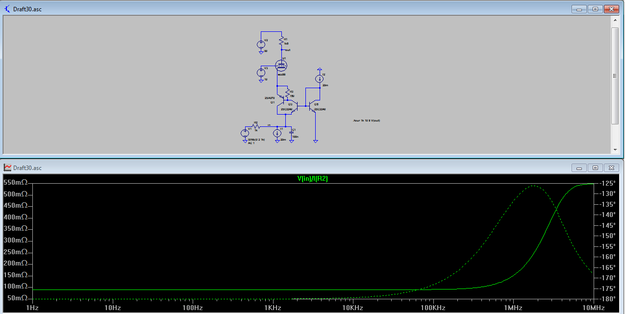

Here is a even more simplified version, the input impedance as seen by the TDA1543 is less than 0.1Ω
This can work with the full tube version. Give it a try with a TDA1543, it's cheap and the result is ... surprising 😀

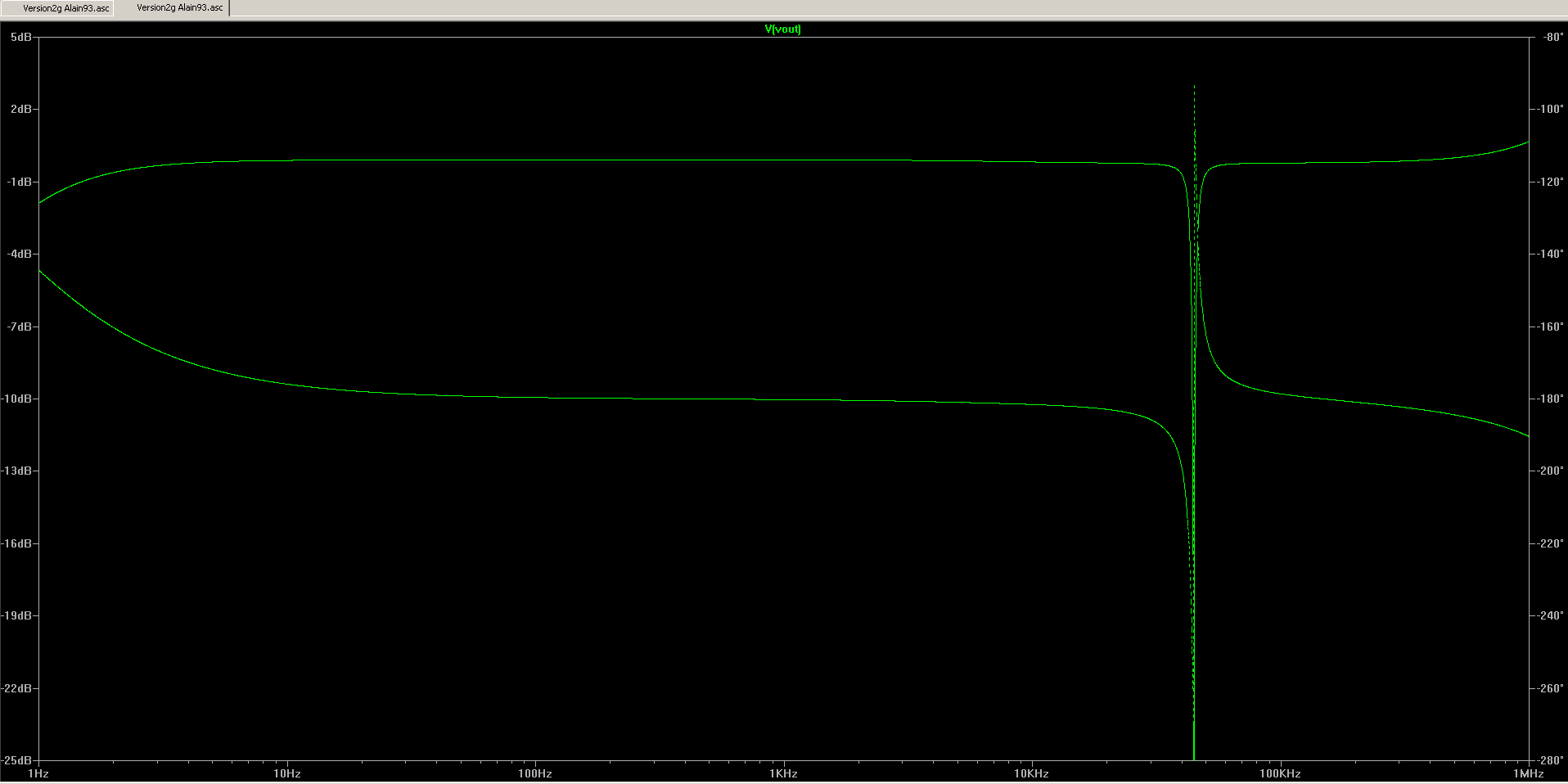

Hi Tazzz
Your input impedance is too big in front of a simple AOP 😱
What's your voltage for Vin
For the model of DAC look at ours scheme, the version voltage generator and
resistor is less accuracy than a current generator drive by a voltage generator
In mind we prefer for the input impedance a rising edge for low frequency
to prevent 50 hz disturbing

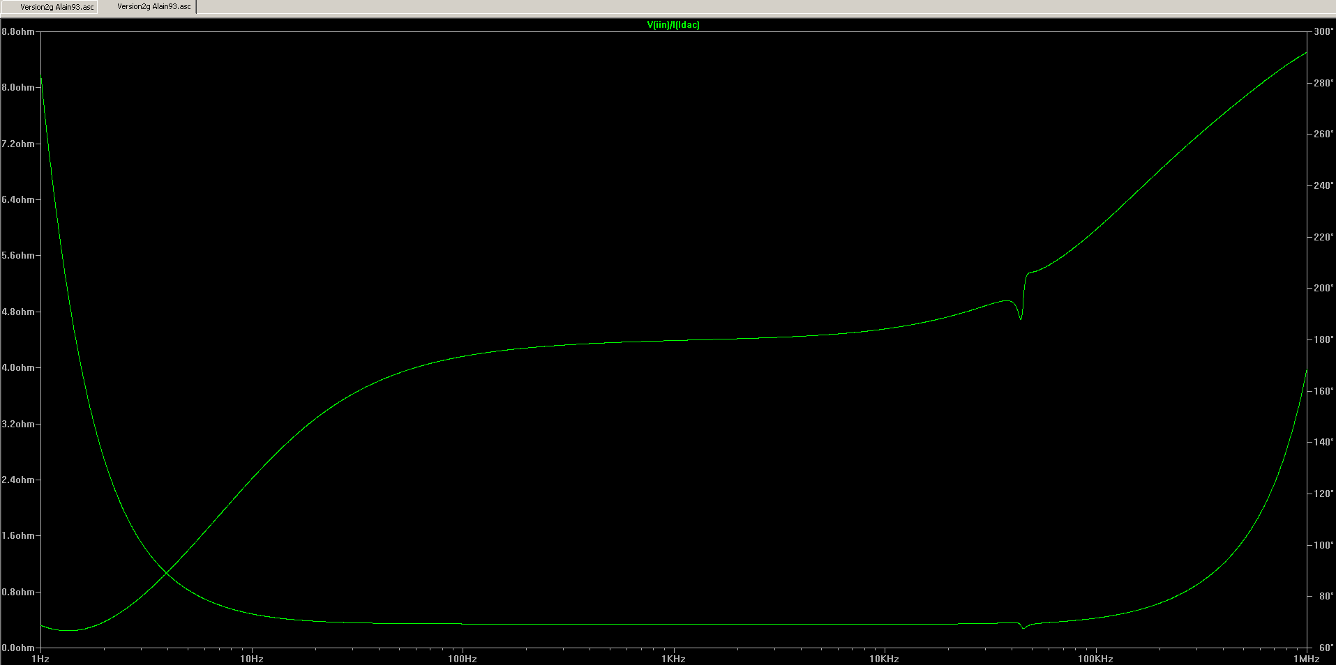

Hi Tazzz
If I'm not blind the input impedance of my circuit is about half of the one you posted from 10Hz and up and its very linear with frequency.

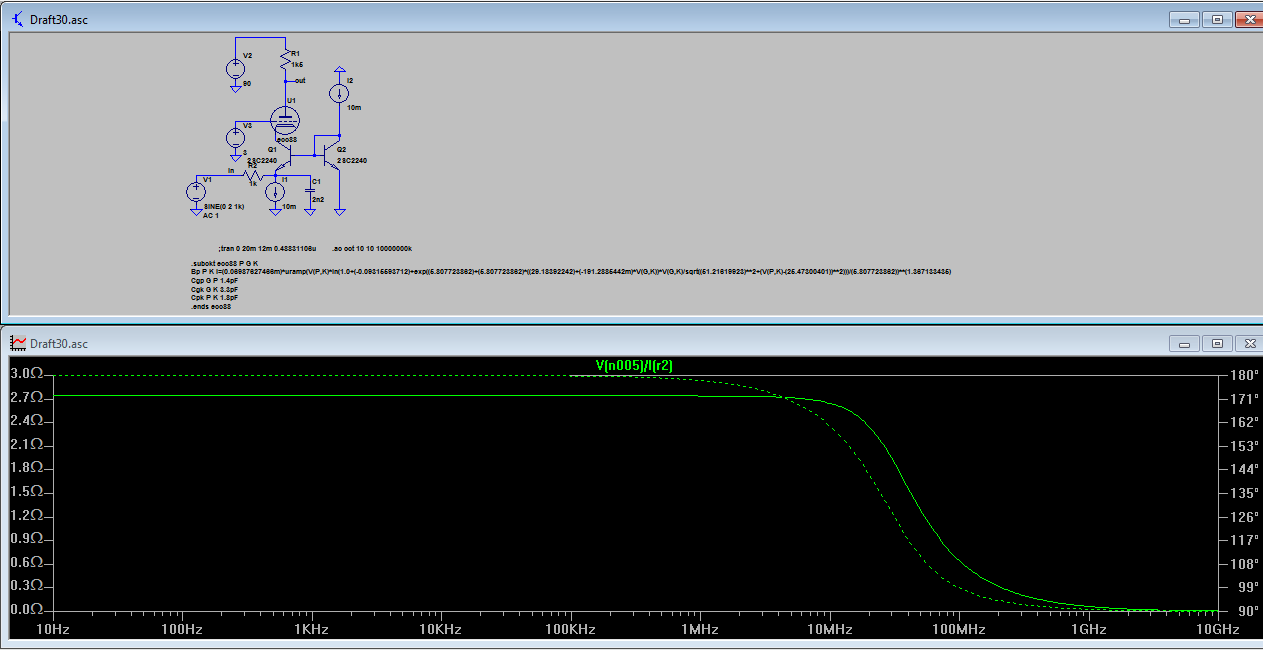

The voltage at Vin (the bjts emitter, what the dac would see ) is close to 0V DC and AC at 1Khz is +/-6mV. Most dacs are poor current sources having an output impedance in the region of 1Khom or so. So a voltage source + resistor is a good model.
I used 4mA P-P and 1500R I/V for 2VRms fullscale.
Sorry but i see 2.7 ohm on your bode up in this post
12 mv AC P to P divided by 4 ma also give 3 ohm
The goal is to have the minimum AC voltage
The input impedance of my topology is about 0.4 ohm , the "u" curve
the "S" curve is the phase

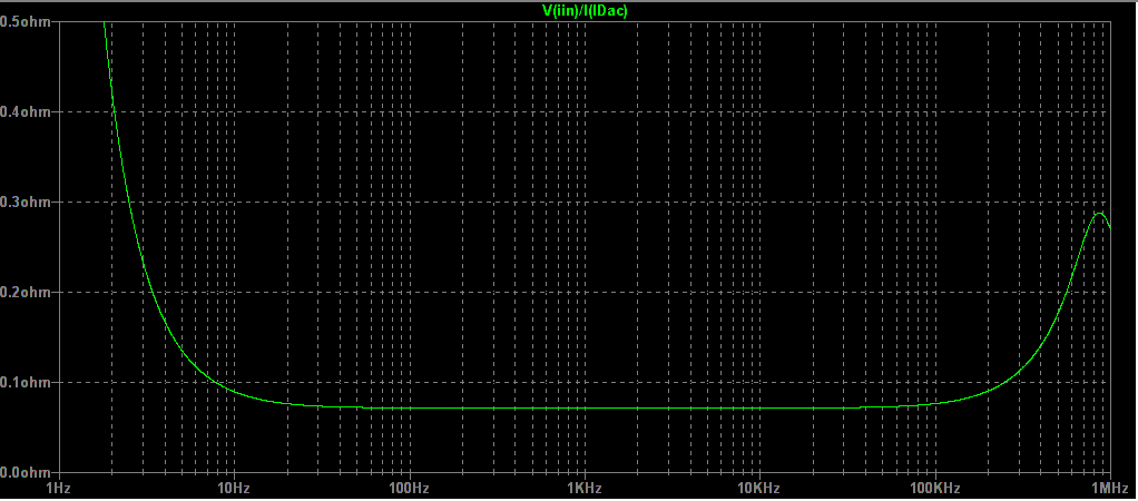

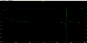

Hi Tazzz, I don't get it. The bode diagramm above shows the input impedance being lower than 0.1Ω from 8Hz to 250kHz. This is pretty much 30x less than the graph you showed. Did I miss something ?
I see I was looking at the S curve as impedance in your plots. In my experience <10Ohm is usually low enough for most dacs hence I'm not so worried about it.

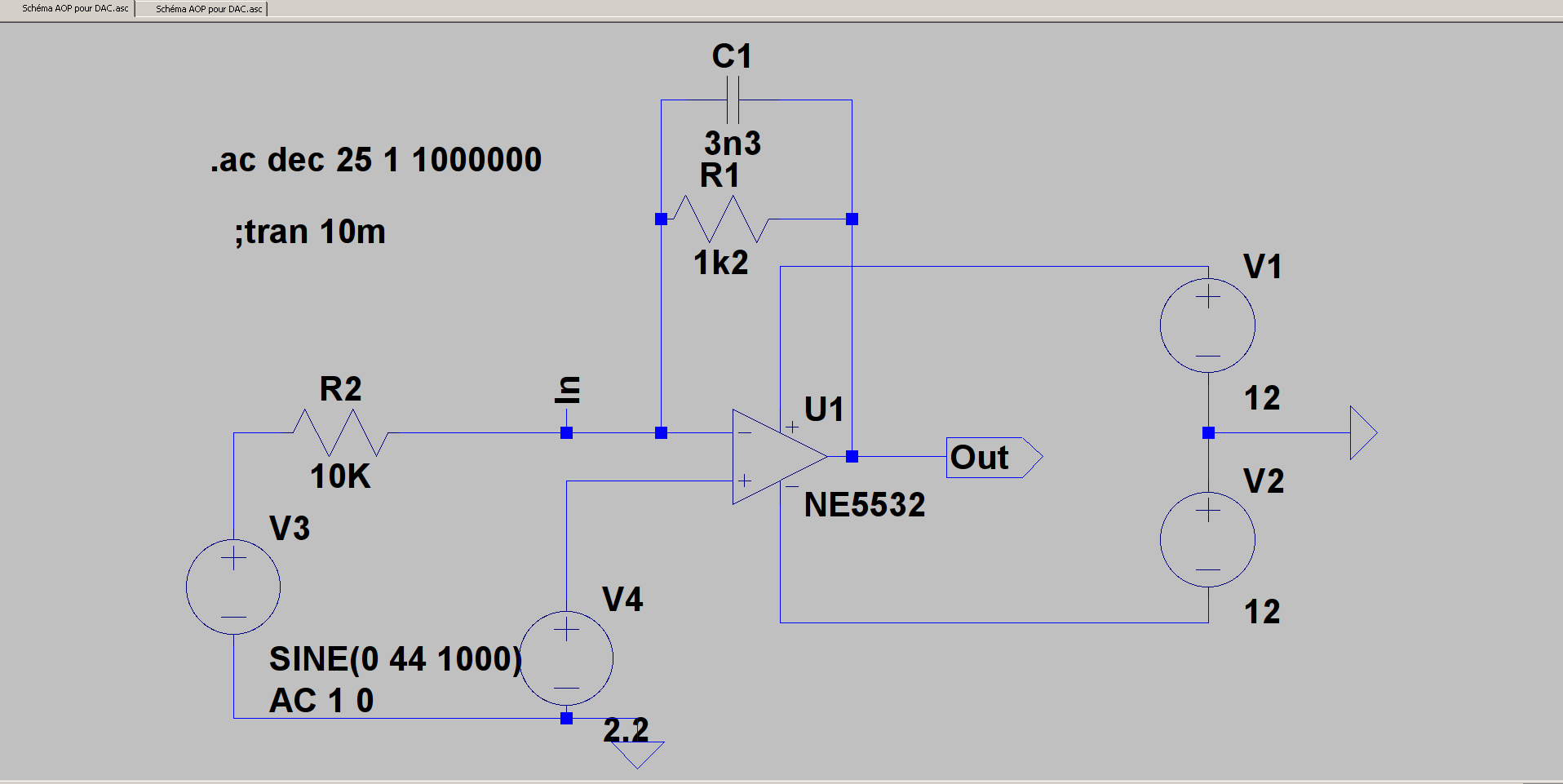

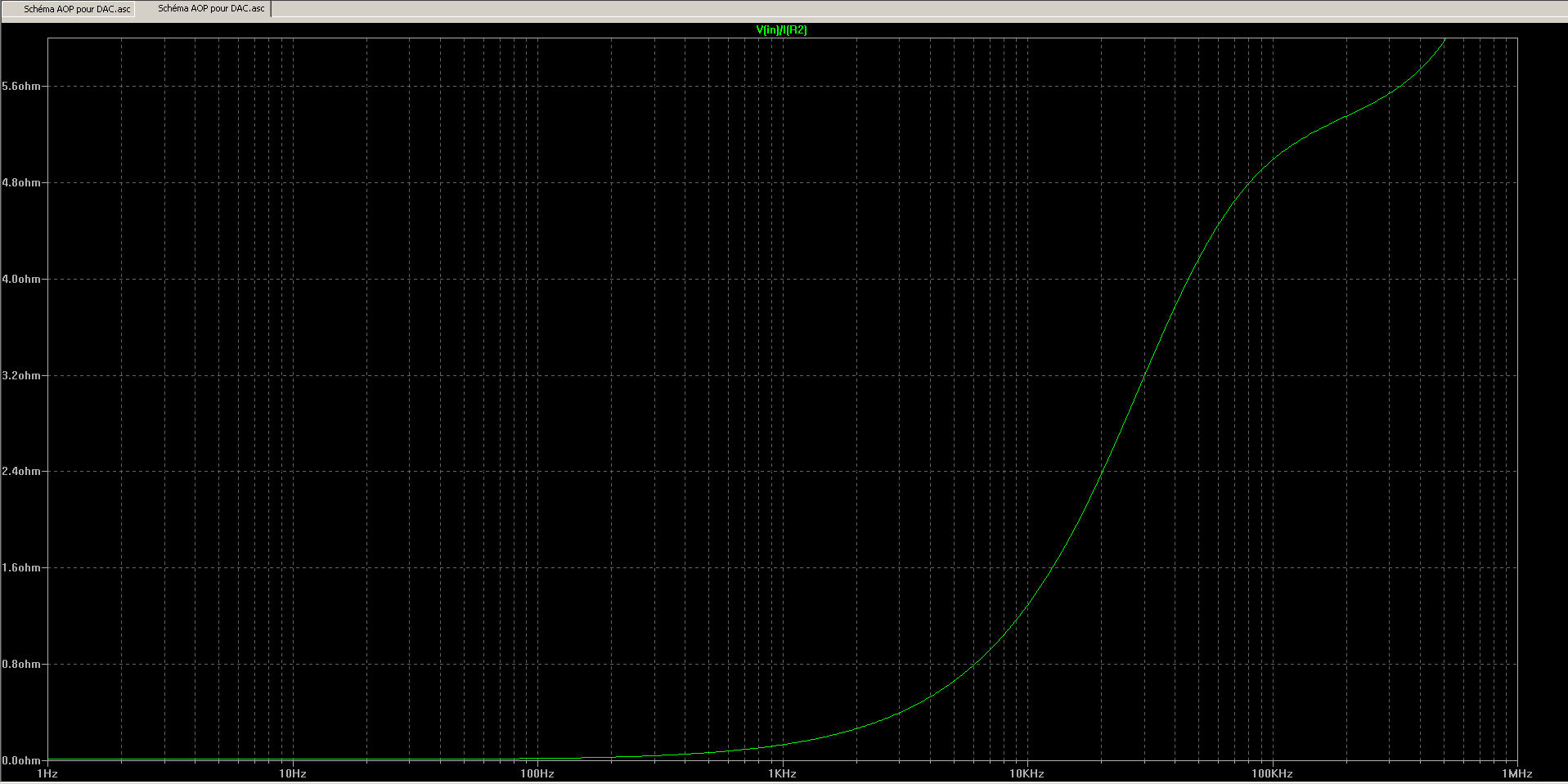

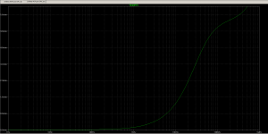

Input impedance VS voltage compliance determinate the
level of distortion , a level < 1 ohm is the begining of our research
to make better than AOP who is generaly used
The AOP problem is the rising level of his input impedance with high frequency
2 capture to show that point
you can see that AOP are better for low frequency
but after 😱
I simmed the latest version TDA1541 version and it is quite impressive. If I am reading the TDA datasheet correctly the settling time is .5 uS, which would mean the steps coming out of the DAC correspond to a 2mhz frequency, so I extended the sim to see past 1mhz and the input impedance goes lower which is great!.
I think you guys are really on to something special. The concern is holding the 0VDC input, I believe it was Ove who found that the TDA1541 needs precise 0.000DC input, he went as far as to use a simple Jfet current source to null the DC offset that is inevitable with passive I/V.
With the tube cathode are you guys seeing a stable 0VDC at the input? I imagine the Mofset helps with that? Or are we waiting for someone to build this stage? If that is the case I think I may throw my hat in and start ordering parts, unless you foresee another evolution of the design?

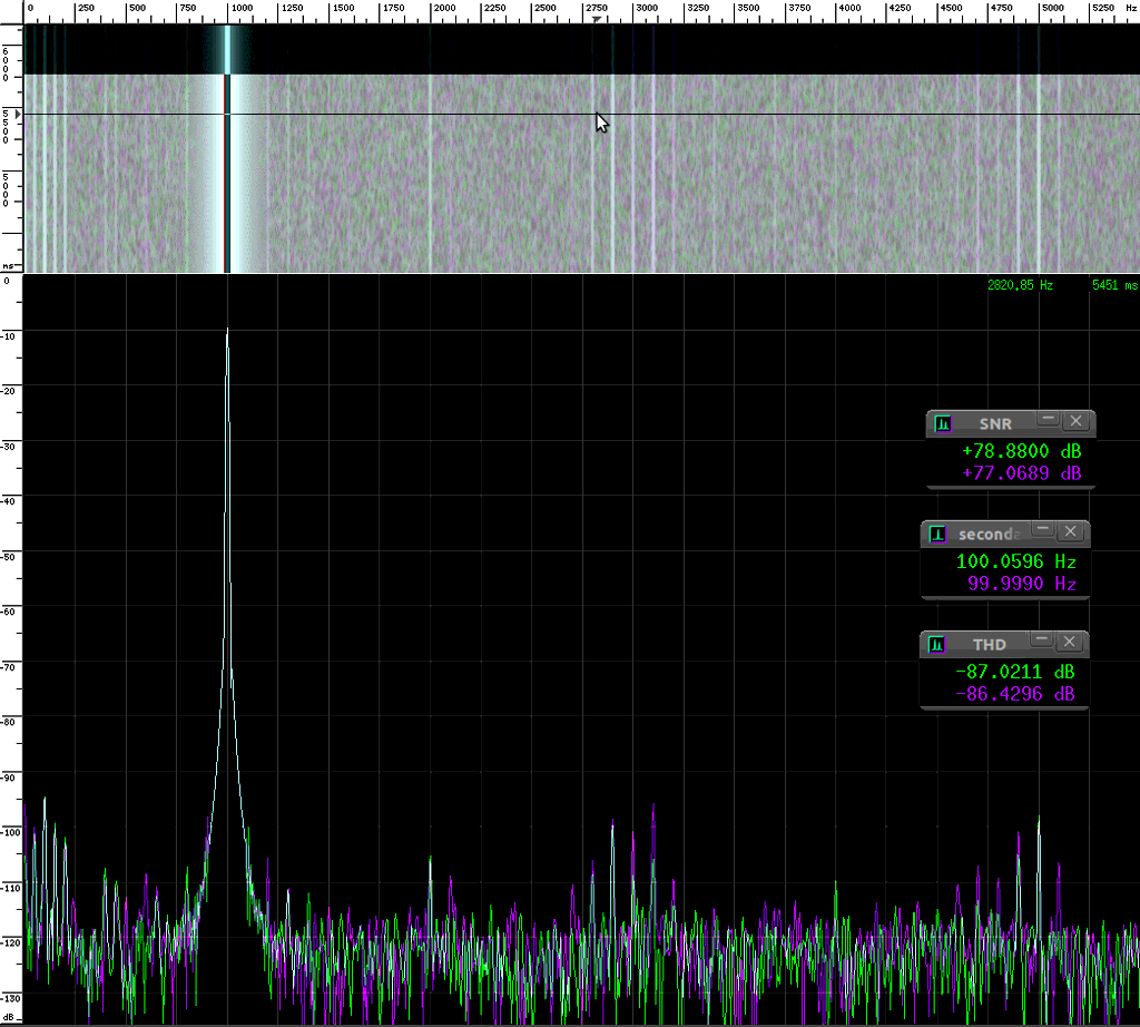

For the TDA wich is my primary concern a lot more than 10Ohm can be acceptable. But for the discussion i did this see attached schematic.

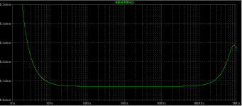

THD is 0.000333% Its still open loop and the input impedance is <100mOhm from 1Hz to 400Khz its not thoroughly optimized but I did change the operating points somewhat.
Note: C1 is a RC link to limit hf peeking as the transconductance in the sziklai pair drops of with frequency making the input impedance look inductive. But it should be possible to keep the impedance below 1ohm up over several Mhz without to much effort.
