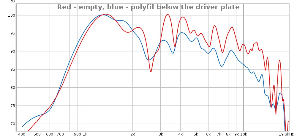

The more I think about it, the more I agree. It was an experiment, that kind of failed. I wonder where the dips come from, to which dimensions are they related. The funny thing is that with a bit of EQ, it did not sound too bad to me. Maybe I should have my ears checked🙂
I would suspect reflections from sharp turns. These will always occur at sharp changes of shape.

So this is mine 20 cm paraline with and without stuffing. I cut a piece of 2 cm thick leftover roughly in the eye shape and clamped inside. I think this is becoming useable🙂

I realized I forgot to install the cone below the compression driver, so that is most probably why it looks that awful now - or a part of it. I have one idea I would like to try - if the dips are resonances, how about dividing the internal part into a larger number of folded conical horns? That could improve the situation a bit. It would be accomplished by adding radial divisions below the driver plate and parallel divisions below the slot plate. I am pretty sure this has been done before - it would be a sort of a folded multicell horn on a smaller scale. With 3D printing it should be possible.
So my next steps are to add the cone and also print a new driver plate with the radial divisions to see the influence. If that will improve the situation, maybe it could be worth it to print a new one in full "multicell" style.
