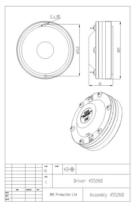

I guess I'll take a stab at reverse engineering this thing.
Based on the math that Tom posted, my hypothesis is that the line in the Paraline is 0.25" tall. Next, we need to figure out the dimensions of the 'eye' in the Paraline.
From the pictures at VTC, I believe they've opted for the neodymium version of Danley's favorite compression driver. So instead of the BMS 4550, they're using the 4552ND.
Once we know the compression driver, we have a fairly good idea of the 'eye' dimensions, because the 4552ND is 8.5cm in diameter.
I think it's hard to appreciate how *small* this thing is! When I first looked at the pictures, I'd assumed that the compression driver was the size of a B&C DE250. But it's much smaller. In fact, the foot print of a single Paraline isn't much larger than a compact disc!
I think this makes sense in the context of how it's used. If you're using two or eight or sixty four compression drivers, neodymium is the way to go.
