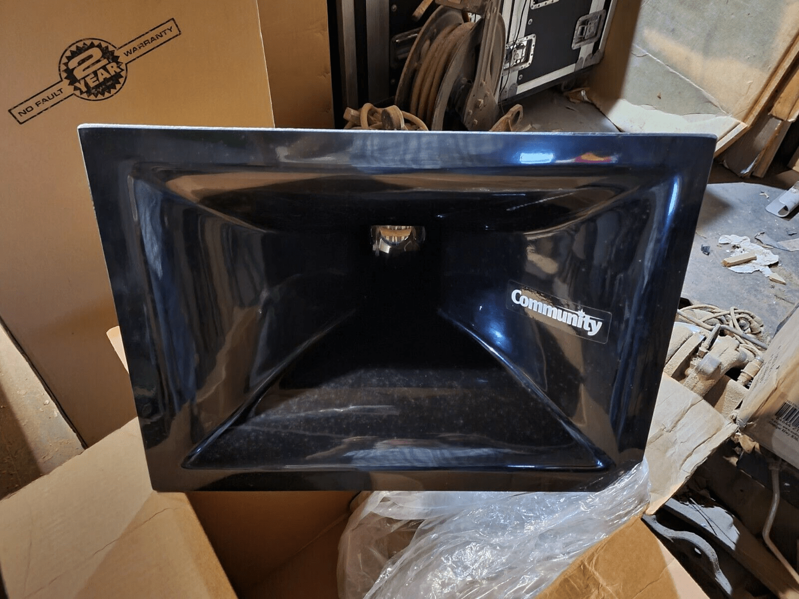

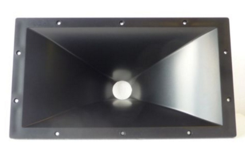

I really appreciate the offer, but I think that horn will be too narrow up top. I have an expo horn that runs down to 400 and up to about 14k with the DCX50. It doesn't have a diffraction slot, which i like alot. Its about 18" x 10" here in the pictures -

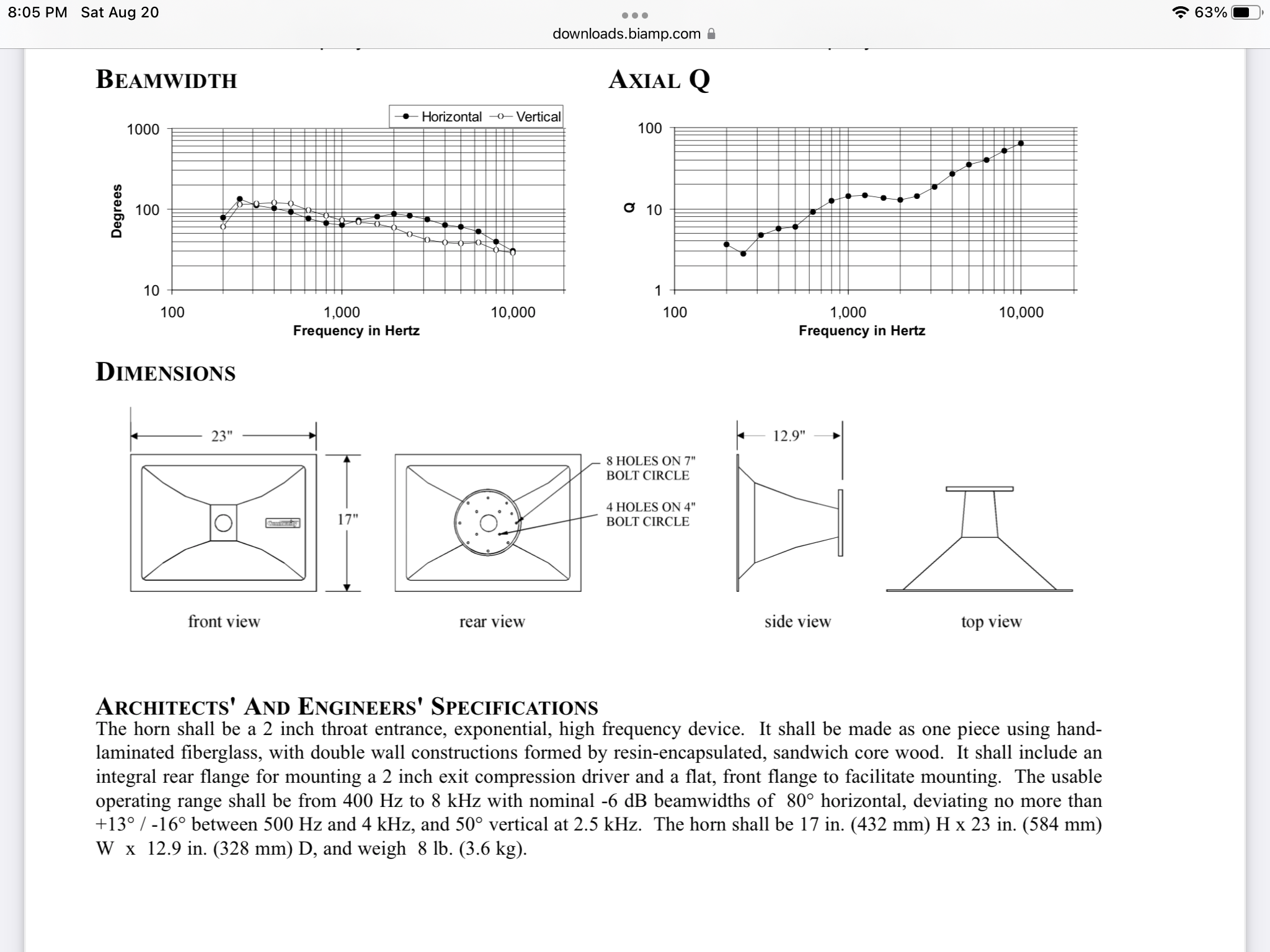

Those are the actual ones! Where are you located profiguy? $120 apiece plus $35 each shipping…..seems like a good deal to me and seeing as they‘re only a hour away ive almost gotten in the car to go get them a couple times, but you can have them (if you want ill send you the link) seeing as your ready to rock n roll ! 😎
Looks like it works well from 400 up until 8k then goes away quick to 30x30 deg coverage up to 10k then probably down to 20x20 after? but isnt any 2” horn going to do that?
