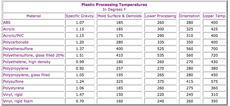

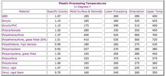

Your conjecture ignores that unpressurized water will not rise above 212 degrees, and the lower processing point for PVC is 290 degrees- at 212 it will be nearly as hard to bend as it would at room temperature, and will not permanently take a set- no thermoforming.
Even Vinyl requires a temperature above water boiling to begin to bend, though that surface temp can be reached in an enclosed auto in direct sunlight.
An oven resulting in plastic temperatures within +/- 5 degree F of the "orientation" temperatures are required for smooth thermoforming.
