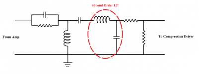

If you can't measure right away, here's a tip:
A first order crossover set at 20khz will get you close to flat.
This is because the 'natural' response of the compression driver is falling off across it's entire bandwidth. So when you combine a first order at 20khz with the naturall rolloff, you get close to flat response. For instance, in the pic above, a 1st order at 20khz will be down 27dB at 1250hz, which is just about right.
Many of my Synergy horn crossovers have been a total of one cap and a resistor or two.
Instead of putting in a first order high pass at 20KHz to level the frequency response, I'd recommend using a second order low pass filter set to around 16KHz. This will boost the high frequencies at the expense of lower impedance. This method is used on some of the Synergy horn passive models. The major advantage of this is you don't have to cut down to the output level of the compression driver at 20KHz; you actually boost the output at 20KHz.

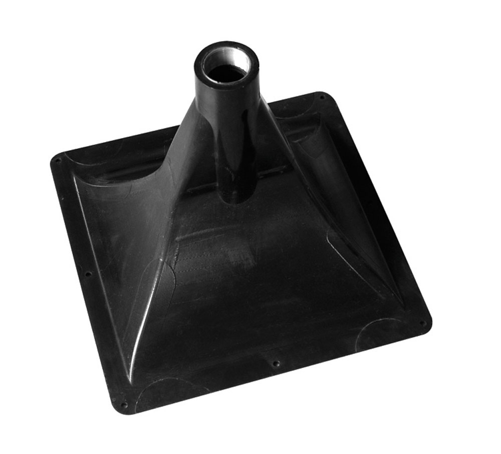

In order to reduce diffraction, we want the smoothest possible transition from one angle to another.
Quick 'jumps' from one angle to another generate diffraction. An extreme case is the Mantaray horn, which sounds famously bad.
The Danley horns have several 'zones' which may generate diffraction. The first and most serious is at the throat. The transition from the exit of the compression driver to the horn happens over the space of about half an inch. So you have a change in angle from about ten degrees to fifty degrees that happens in one inch.
The QSC waveguide looks virtually identical to a conical horn. But the devil is in the details; the transition from the exit of the compression driver to the baffle is absolutely seamless. There isn't even a *hint* of a sharp edge here. It's basically one long spline, from compression driver exit to the baffle.
Will it control directivity down to 500hz? NO.
Does it generate HOMs? Yes, but nowhere near as much as a conical horn.
Another 'nice' thing about the QSC is the build quality. I've bought so many horns, and it seems like at least half of them have a mismatch a the throat. A gap of 1/8" of an inch might not look like much, but it will absolutely ruin your high frequencies. Will make the horn virtually unlistenable. The QSC is molded perfectly, no shrinkage, no gaps. (The 18Sound waveguides are also very well built.)
IMHO, it's really difficult to match this level of build quality when you're building things by hand. At 5khz a variance of an 1/8" makes a difference.
As for the exit angle of the compression driver, I've personally never worried about it. The QSC has an entrance angle of zero, and it sloooooooooooooooooooooooooooooooooooowly transitions to ninety degrees. You can see that in the walls of the waveguide; there's a very very gentle curve there. Compare that to a conical horn, where the walls are perfectly flat. The Celestion CDX1-1425, which the QSC was designed for, has a negative exit angle. IE, it has a converging wave front.
Not saying that the exit angle isn't important; it's just a variable that I can't control unless I start building my own waveguides again. And personally, I think that the consistency and build quality of the factory waveguides provides more benefits than I would realize if I made DIY waveguides with an entrance angle tailored to match the exit angle of my compression driver. And my compression driver is negative, which makes things a little trickier.
