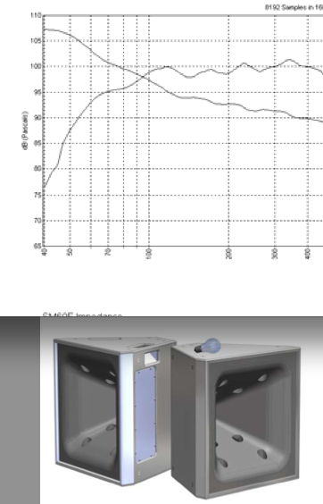

How low can a synergy go? for example when use it with a tapped horn, and for pure hifi..
Kees,
LF response depends on the horn angle and depth, narrow deep conical horns go lower than wide angle shallow horns of the same mouth size.
Many of the DSL Synergy horns use bass reflex ports to fill in the response below where the horn cuts off, the little SM 60F -3dB point is about 90 Hz, so many TH could be used below it.

Thanks for the information.
my tapped horn is usable to 70 hz, but also this can be reached with this idea?
I now low freqenties below 100 hz things get very fast very big. This moment i use open baffles with a T-TQWT, it do very satisfactory, but as hobbyist you now I like to experiment, but I am more a amp designer, speakers are a little new for me but with hornresp and more of such programs it is great help...
