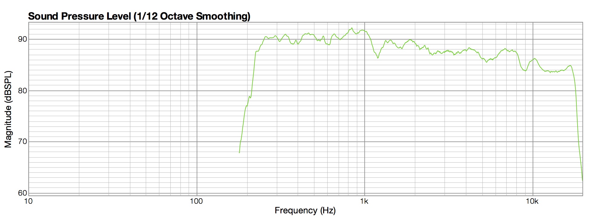

I just had a minute to do make some rough and ready measurements of the Fostex T50rp + cardboard box triangular horn shown above.
Holding the box with my legs I took a bunch of measurements with an uncalibrated WM61a mic, moving it around about 10-15 cm from the throat. Don't have a turntable setup right now.
First up I have some unnormalized plots -
and now normalized to the first measurements (which is not necessarily exactly on-axis -
I would say that it's holding up pretty well in the range I'm interested in (< 10 kHz. The interference effects should be less severe further into the room (less steep angles of incidence from the diaphragm and horn walls).

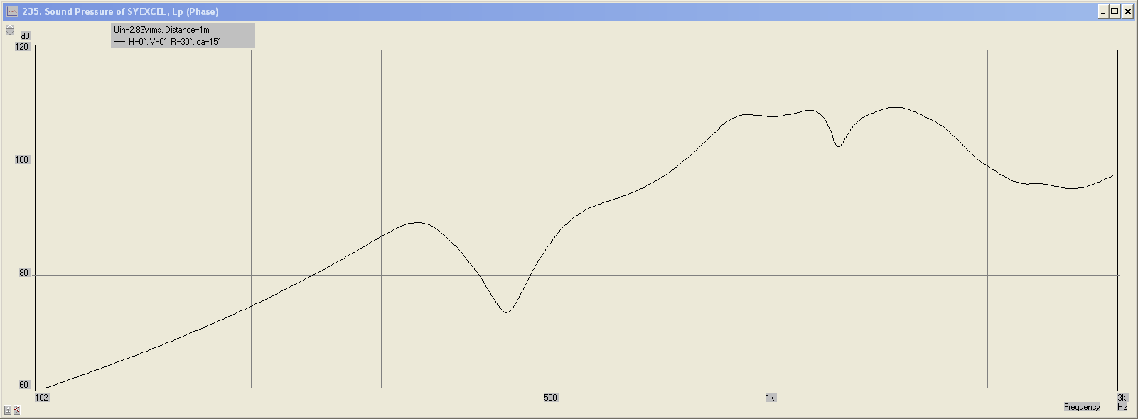

Here is the variant with the driver connected to a dummy node:

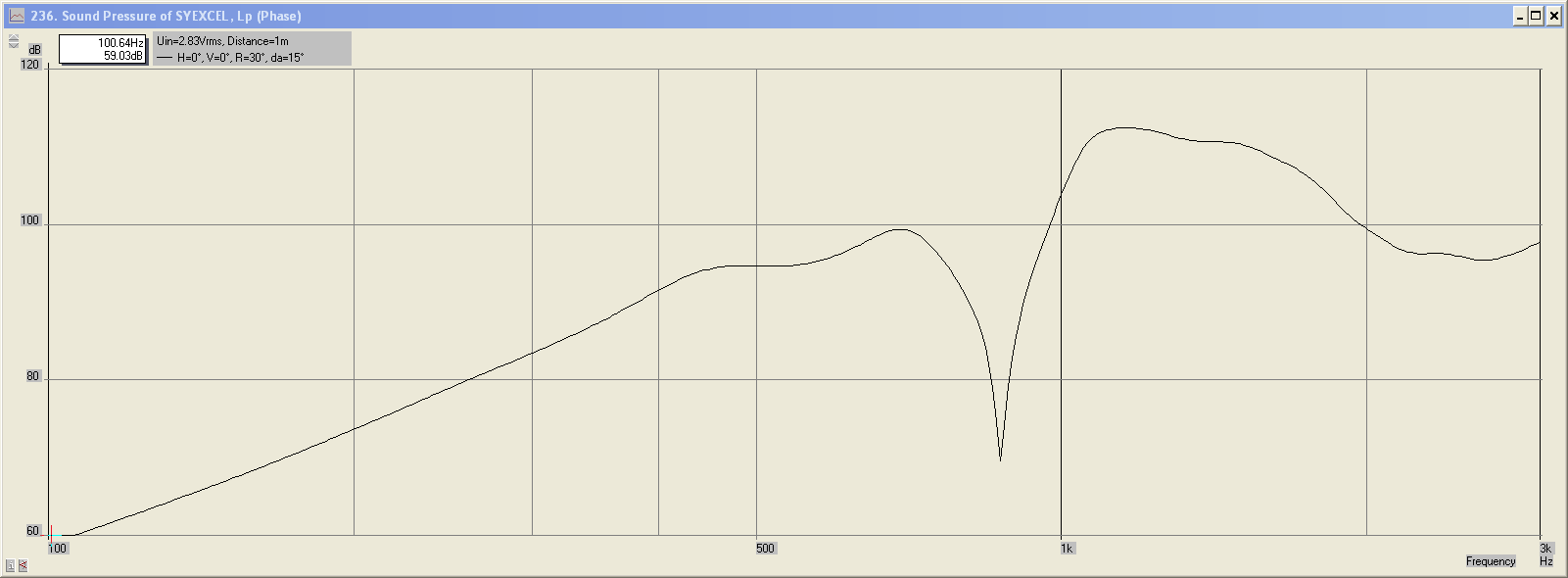

And here is the one with the driver removed:

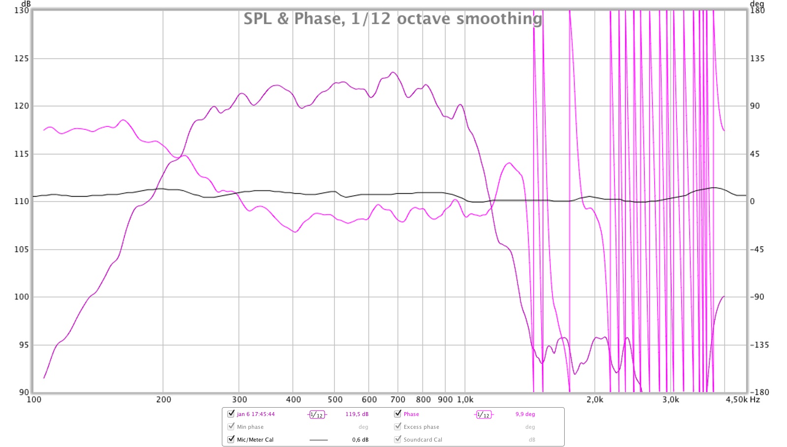

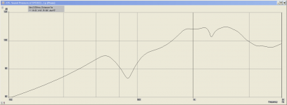

I am experimenting with a rather large synergy horn, 250hz horizontal directivity, 84°×54° using the B&C 5MDN38 and DE250, BMS 4550 or faital HF146.
My first prototype is quite promising, although I only use one mid. The mid entry hole is 40×13mm starting about 60mm and ending at 95mm from the CD mesh along the horn axis. I will try different placements and shapes of the entry hole to see how it alters the response around 1 khz. The mid chamber is ~0,6 liters minus the driver.
I dont know if it has been discussed but I assume that the mid entry holes should not have a distance > λ ∕ 4 amongst themselves. Or is this only a necessary condition for the CD-mid distance?
Assume I aim for a crossover frequency of 1,1-1,2khz, the distance between the diagonally placed mid entry holes should be no more than 75 mm from each other? c-c distance or distance between the farthest edges?
Regarding crossover frequencies, should the mid be tailored to roll of acoustically at intended frequencies or is desirable to have somewhat of an overlap and then cross electrically?

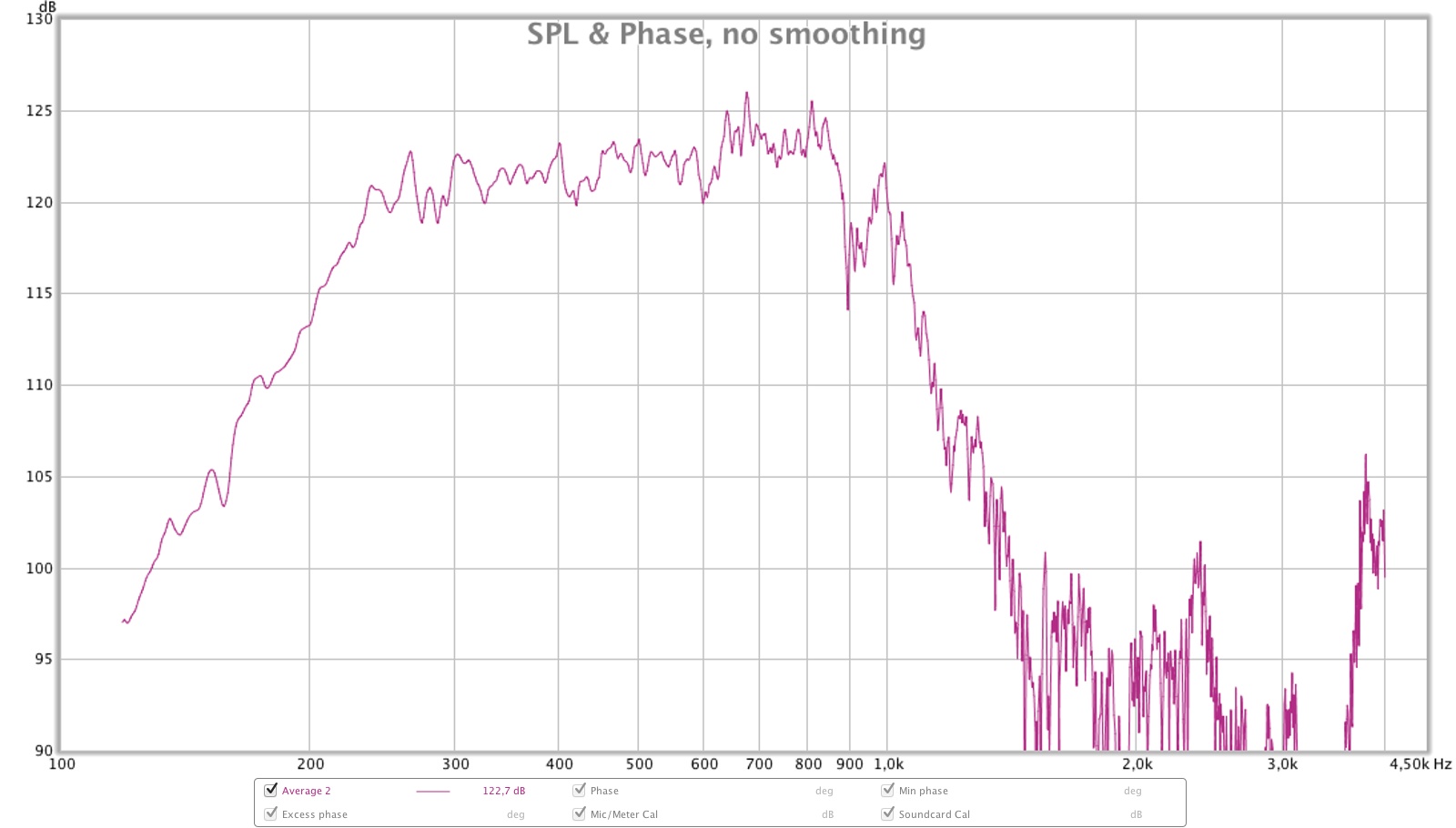

This is taken about 1m from horn mouth w. smoothing
This is average from 0,5m, 1m and 2m, no smoothing
With DE250, no mid LP filter 200hz HP, 1,1khz HP DE250, no delay/phase adjustment

Thanks for the DE250 model; I hadn't found that one. I did a similar thing as you modeling each driver separately then using ACD to simulate a crossover. It seems relatively easy to get good results that way, at least in simulation 😉
Akabak recommends using the "OFF" keyword to switch drivers off so you can simulate them separately. Here is an excerpt from the manual

Ideally the mid/high and mid entry holes should all be within 1/4 wavelength.
If the distance between the mid entry holes is greater than 1/4 wavelength off axis response will not be as smooth.
Some overlap is desirable, as an electrical crossover will attenuate the upper mid breakup and lessen excursion of the HF driver.
Your combined response curve looks very good, other than the dip at the 1100 Hz acoustical crossover. Using a mid HP filter, out of band EQ, or delay, or combination of those will probably eliminate the dip.

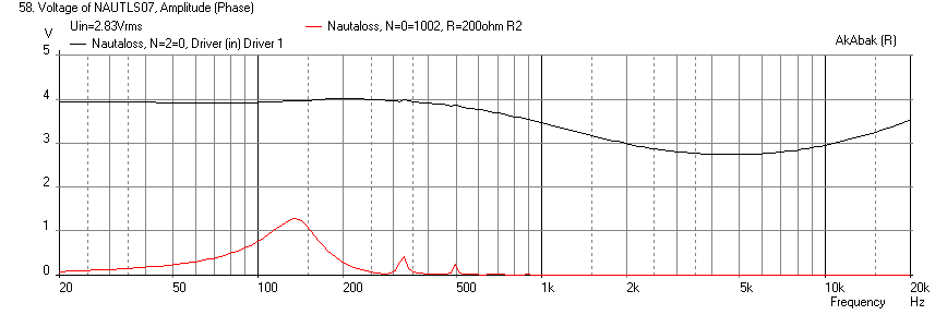

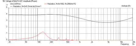

AkAbak accounts for driver-to-driver interactions
I have confirmed that Akabak does indeed account for driver-to-driver acousto-electrical interactions. In a multidriver cabinet and I simply connected a resistor between the positive terminal of one driver and ground and the negative driver terminal to ground. When you simulate the SPL you see that there is a clear and controllable damping effect of the driver that is connected to the resistor: the response depends on the resistor value and the voltage generated by the driver (driver becomes a dynamic microphone) on the resistor varies with frequency. You can use it as a passive radiator with variable damping in fact. Pretty cool.
Below is the voltage of the driver connected to the amp (black) and the resulting voltage developed across a 200 ohm resistor from the driver that is not connected to the amplifier (red).
