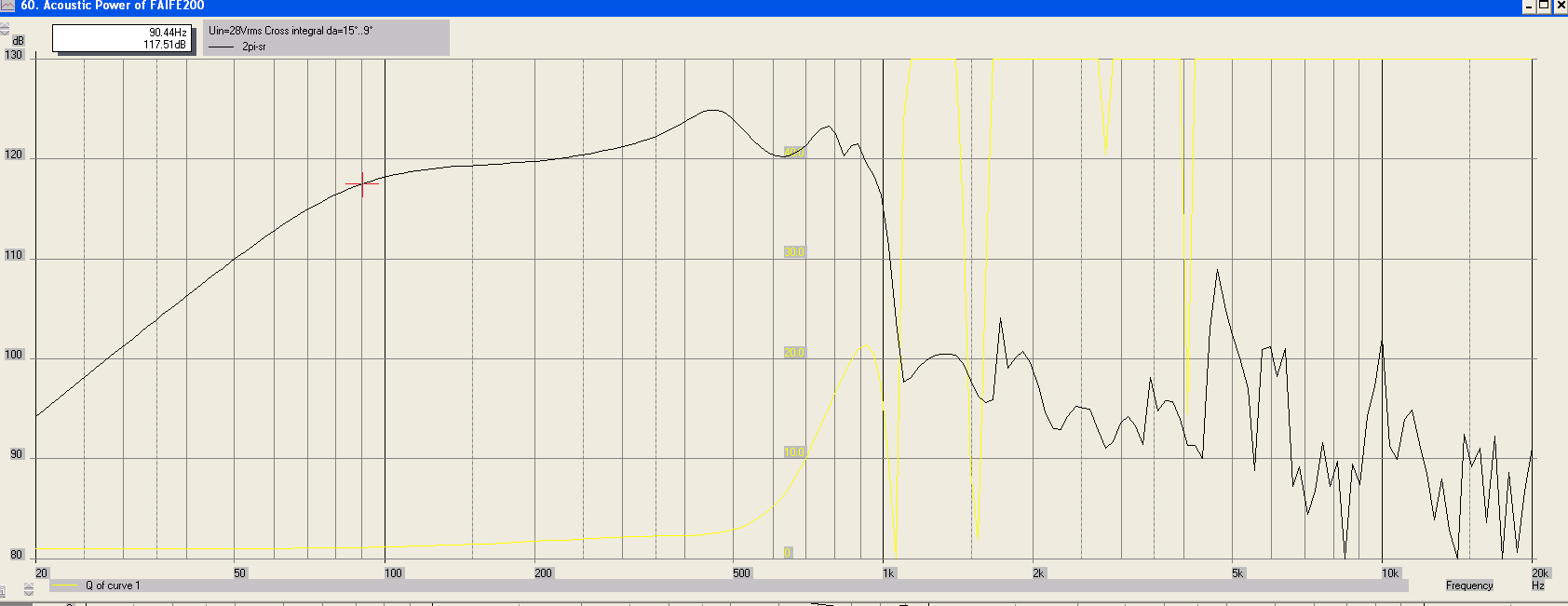

A rough sim of the Faital 8FE200 4 ohm in series hitting Xmax @ 90Hz; 117,5dB with port velocity >17m/s
It looks very promising🙂
How do I inspect the phase response in relation to the cancelation notch. Should I just view the minimum phase at the mid-port?
/Thomas

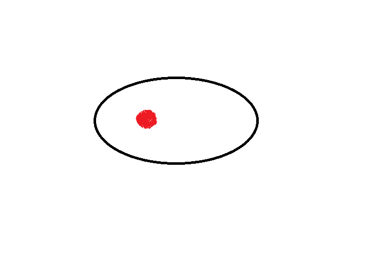

that is your choice, and your project
basicly, the problem is that for such a relatively big hole the acoustic centre cannot just be considered like a small point ... it have be considered like a small area
the average distance to 'acoustic centre' is the edge of that area, hence the red dot I suggested
For the purposes of performing calculations and simulations, using a single point is the most practical approach.
You must also consider the acoustical size of the wave lengths involved. The frequencies that come out of that port are acoustically large compared to the size of the port. If the acoustical center was off to the side like in your red dot graphic, the pressure would be significantly higher at the red dot than the middle of the port. As long as laminar flow is maintained through the port, the acoustic center will be self-centering and follow the path of least resistance. Either way, we might be getting too picky here. What's the difference in length from your red dot graphic and the center of the oval? Probably not enough to make a significant difference.
when looking at mid port in pics of SH-95, I would guess at something like 2cm or 1" difference in how we look at it
but if using the same when placing the hole, what difference will it make then :bawling::headshot::clown:
Thank you John, for revisiting the laws of (fluid) flow. It makes a lot of sense!
