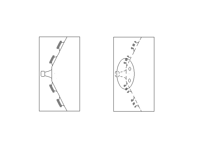

Anyone used a 2" compression driver in a synergy horn? Crossed at around 600hz, midranges covering anything from 140hz to 600.
I have two large phenolic drivers that i can use up to 6000 hz or so. Super tweeter above.
Soooo.. what cheap drivers can i use?
A couple observations:
1) where will you put the super tweeter? If you put it on top of the horn there's going to be a big discontinuity in the directivity.
2) in a unity horn we're basically building our own compression driver for each frequency band. So the efficiency of the midranges can end up much higher than might be expected. For instance, the midrange array in the Lambda Unity is more efficient than the compression driver in the Lambda Unity.
Rvrasvan, where do you put the level for cheap? According to Earl Geddes, modern compression drivers are a commodity, and any competent 1" driver can cover the range from about 1K on up. At least the differences between them would be much less than grafting a tweeter to a 2" waveguide. I would think it pretty easy to find a suitable 1" driver on the used market.
Or one could say the the efficiency of the HF driver is less than expected, because the constant directivity of the waveguide does not compensate for the power fall off of the HF driver. With a passive crossover between HF and Mid, the bottom range of the HF driver is effectively padded down, along with the mids. With an active crossover, one can boost the range above around 5K, and probably get away with the same amp power on HF and mids, because there is not that much musical content (signal amplitude?)above 10K anyway.
Sheldon
Basically the reason that I've never considered a 2" compression driver for a unity is because the midranges ARE a compression driver. This might not be immediately obvious, that the midranges are basically equivalent to using *four* large format compression drivers on a single horn. (This is also the reason that I gravitate towards very small midranges for my Unity horns. I get so much gain from the compression chamber, I don't need large midranges)
These spekers will be used for party's so high output will be important. Covering 140 to 6Khz with a point source seem to be a good ideea. The Seleniums are reated at 75W and they can be crossed as low as 500hz. This gives more room to play, and a wider variety of drivers.
In the future i will try to use a 2"coaxial drivers 😀. But they are not that cheap!
noone says you cant be creative
we havent yet seen the optimal hifi unity 😉
btw, tweeter is not a compression driver, but a complete small tweeter horn, and could be the new FaitalPro FD371
