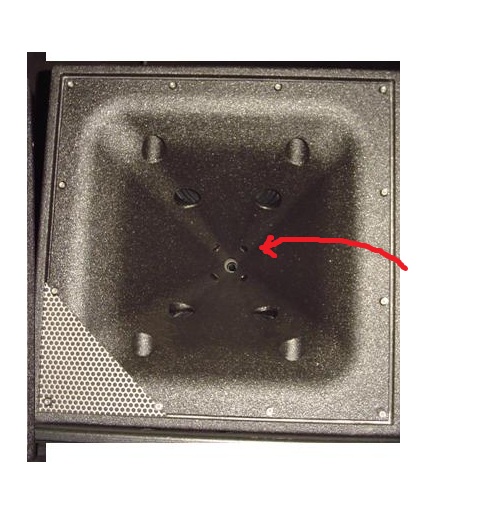

Like in one of my posts above, I want to seal the rear of the 3FE20 just like Danley sealed the rear of the BMS 5CN140 used in the SM-60F. See that attached picture. I copied the section of interest and outlined the cutaway chamber in red. It looks like getting to around 600Hz with the 3FE20 will be possible.
well, yeah, ok, it is ...and its a BMS...I think they have a new one
but the 4 small holes around the tweeter hole means the DC must be 'decoupled' from the cone with a tube or something
I dont think a coax will be needed in a unity for home use

In the DSL SM-60 pictured in posts 656 and 655 the side mounted drivers cover the low range (-10 at 52 Hz), the 5" co-ax cone covers mids, the co-ax compression driver covers the highs.
If really high SPL is not needed, a single co-ax can be used to drive a Synergy horn.
