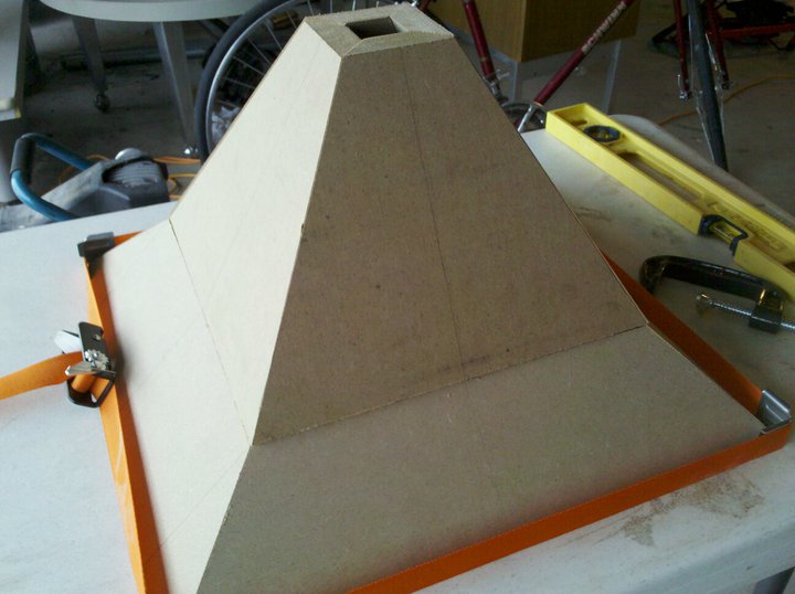

Sawdust
I started making sawdust this weekend. I ordered eight of the GRS 5SMB-8 mids and two Selenium D220Ti. I chose the GRS mids for a few good reasons: they have a lower inductance and lower QTS than both the Pyle and Misco, and they model real well... oh, and they're crazy cheap! Even if they don't work I'm only out $40 for all eight drivers. The only parameter missing was the VAS and I modeled it within what I thought was a realistic range and it only changes the low cutoff by about 50hz as well as the shape of the roll off.
In the true DIY spirit I dove in head first. I haven't decided yet if I want to just do an active or passive crossover. I've never designed a passive, but I've got the measurement equipment to do it. I'll build one of the horns completely, test and tweak it until I think it's right and then build the other one out. I'll probably start a build thread once things get rolling.
