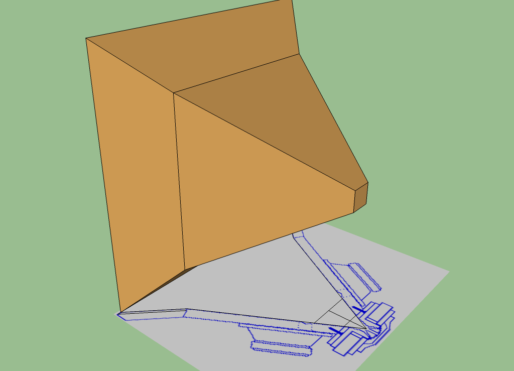

One other comment. If you do a Unity horn with ribbons, one option is to put theme somewhere OTHER than the apex.
The whole idea of a unity is that we DON'T have to drive a horn at the apex. There is nothing stopping us from driving a horn from a point down the throat.
For example, instead of using a single NEO 3 at the apex of the horn, you can use *two* NEO 3s, and sandwich them face-to-face.
If you are following me here, you'll see that the "NEO 3 sandwich" would have a gap of zero inches on one edge, and perhaps one inch on the other.
By making the gap in your NEO 3 sandwich very small, you push standing waves up in frequency, to a point where they're inaudible.
Of course, this begs the question, how do you mount two square ribbons to the edge of a pyramid-shaped horn?
And the answer is that you simply create a very shallow cavity in front of the part of the diaphragm that doesn't fit on the pyramid. As long as the depth of that cavity is very shallow, the standing waves will be above audibility.
It's the same idea as what I did with a single ribbon, but instead of using a throat that's 1" in diameter, the throat of the horn is just a fraction of an in inch.
The horn would look like this from the outside (IE, there's basically no throat - it's a fraction of an inch.)
The horn would also be simpler to fabricate, since it's a simple wooden pyramid with two ribbons slapped onto the sides at the very top of the pyramid. While the idea of running dual tweeters may seem non-intuitive, it will totally work as long as you keep them very close together. With a gap of 1/4" you wont get interference until 14000hz, and in the real world, I'll bet it wouldn't happen til 28000hz really. And obviously, dual ribbons increases power handling and efficiency. If you *did* get interference, a simple fifty cent inductor can roll off one ribbon above 14000hz, and would eliminate interference while retaining high power handling and efficiency from 1000hz to 14000hz.

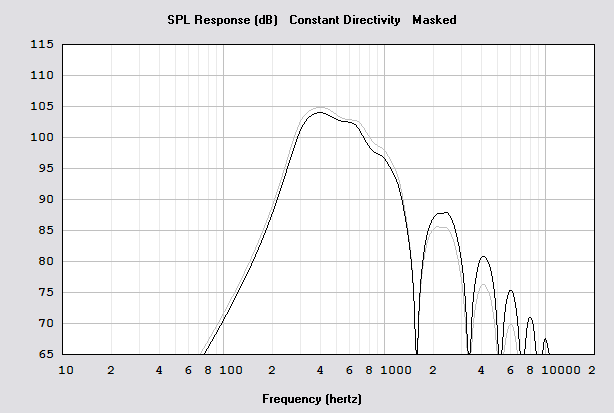

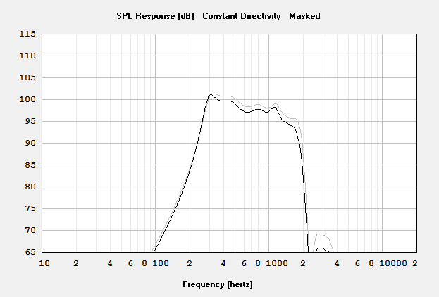

Looks like Paul Spencer convinced Parts Express to test them, and it is indeed a good candidate
Looks close enough to me, theoretically just needing a bit more shelving [Pyle in shadow]:

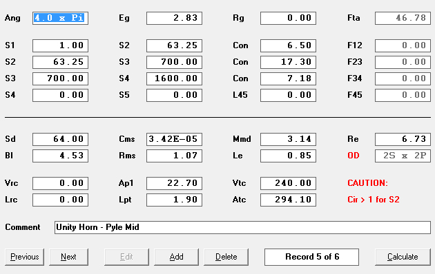

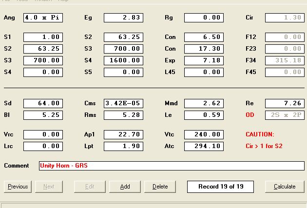

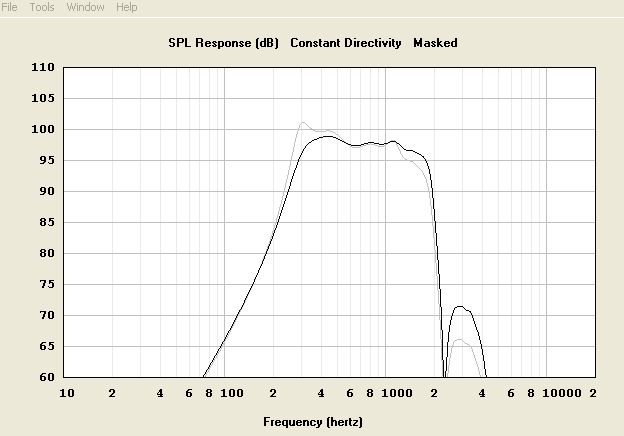

A few days ago I asked for T/S measurements of the GRS 5SBM-8 5" sealed mid and now they are listed in the answer section.
I plugged them into Hornresp and 😱 Isn't that the prettiest plot you've ever seen (Pyle in gray, GRS in black)! Now, they've got a metal grill that would need to be pried off, but I can deal with that at $5 a pop.
GM - would you mind posting your Hornresp input parameters? The overall shape looks similar to mine, but there's definitely some differences. I'd like to see if I've got something wrong.

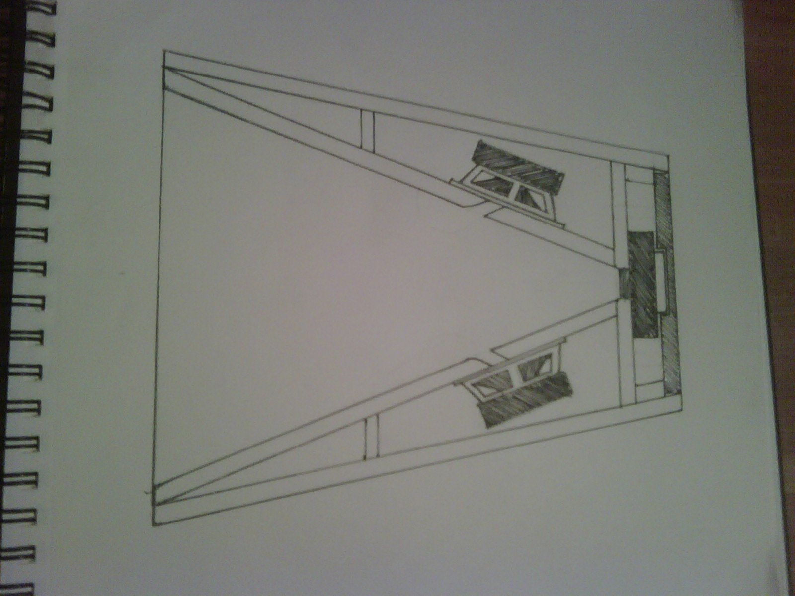

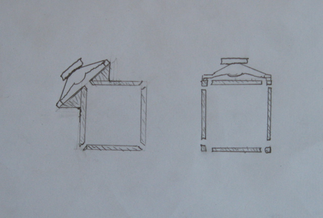

In a different vein: The mids are mounted on the flat of the horn, because that's easy. But it's not much harder to mount them on the corner of the WG (which I intend to do, when I get around to modifying my Unity horns). That way you can use a single entry hole (or slot) right in the corner. And you can move the mids a bit closer to the apex. Cross section:

It's all a bit embarassing that Mark Seaton's advice from five years ago was ignored by yours truly. He basically said "find any ol' small closed back midrange." I recall that he specifically told me that the back chamber on my original project was too large, and that the Eminence closed back midranges for line array use look like good candidates.
