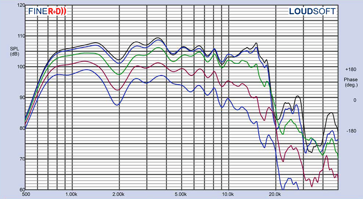

It's why I posted the Audio Express link on the 90 x 40 horn - it gives you a good idea of the pressure loss you can expect off-axis (..and notably one that's more *uniform at lower freq.s). From there you can look to your mid's pressure loss and see if you've got a similar pressure loss off-axis at and near the crossover freq. of choice.
*Note though that there is some "waist-banding" (extra pressure loss that's not as uniform) centered around 2 kHz at around 45 degrees off axis. This depends quite a lot on the measurement condition and IF you have mounted the horn to a baffle. (..a larger baffle should improve things, closer to what it is at 7 kHz, vs what you see below.)
Again, note that the actual linearity of the Beyma compression driver isn't very good - instead just look at the relative uniformity of pressure loss off-axis (0/15/30/45/60 degrees relative to freq.).
