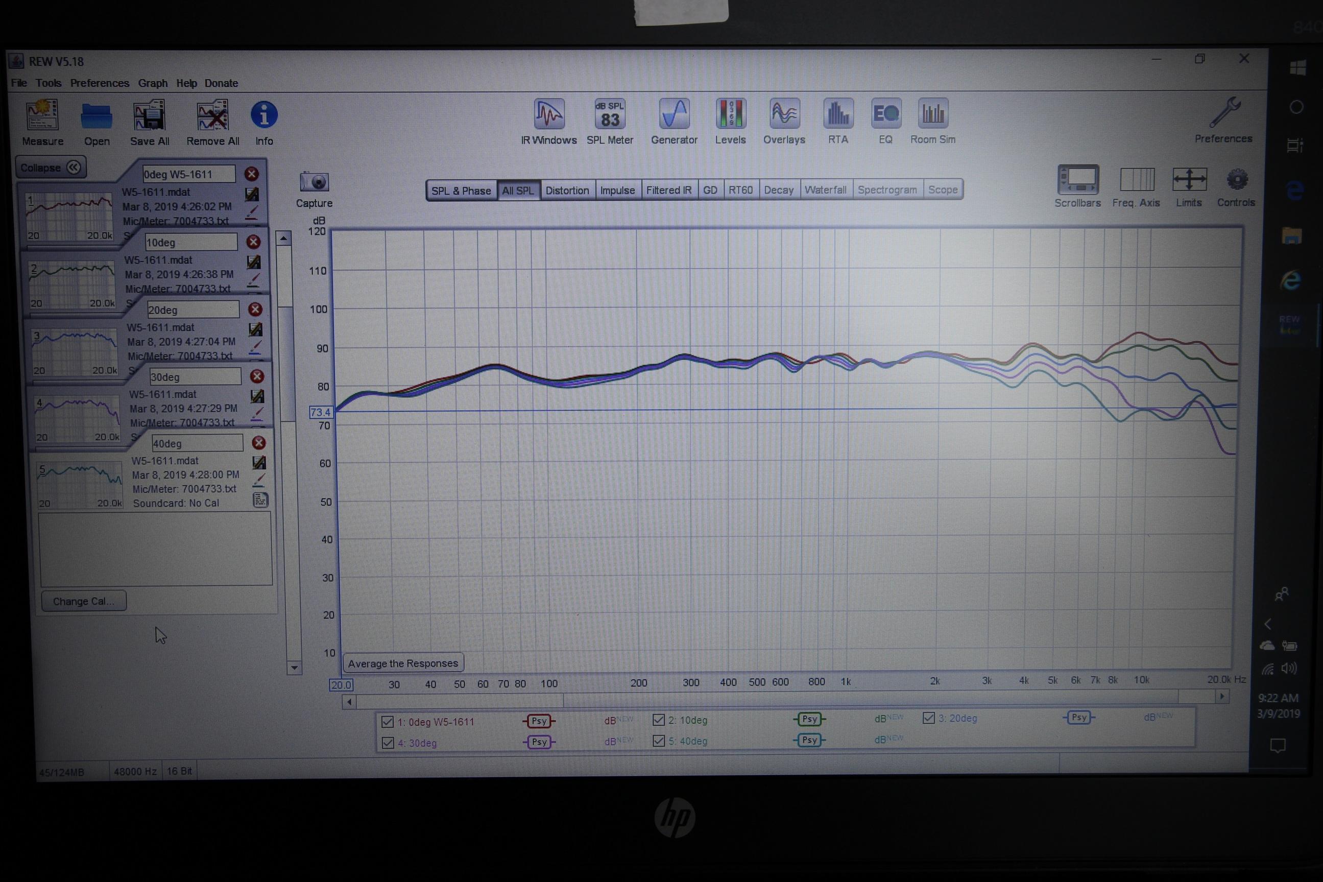

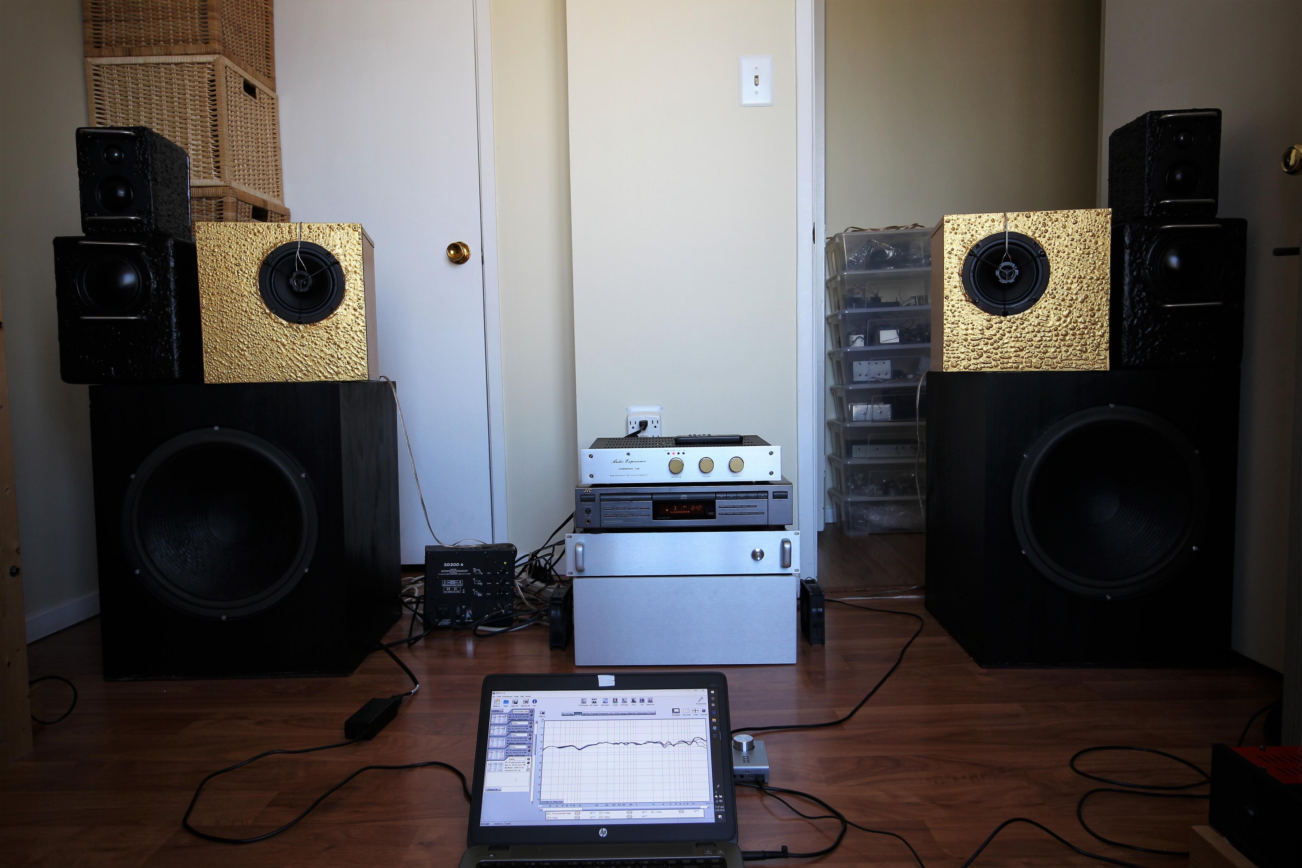

I had a pair of w5-1611saf around, so I put them into ikea bookshelf and took some measurements. I can post it if someone is interested. They would make nice midrange. While they have elevated heights on axis, they beam terribly of axis.
It starts severely beaming at ~3kHz. It sounds little boring, because signal with high fr information is only narrow beam. Signals off axis are lean in this information. Reflected signal therefore will be with less heights. Perception of luck of detail is likely the result. Otherwise its a great midrange. Flat, uniform, low distortion.

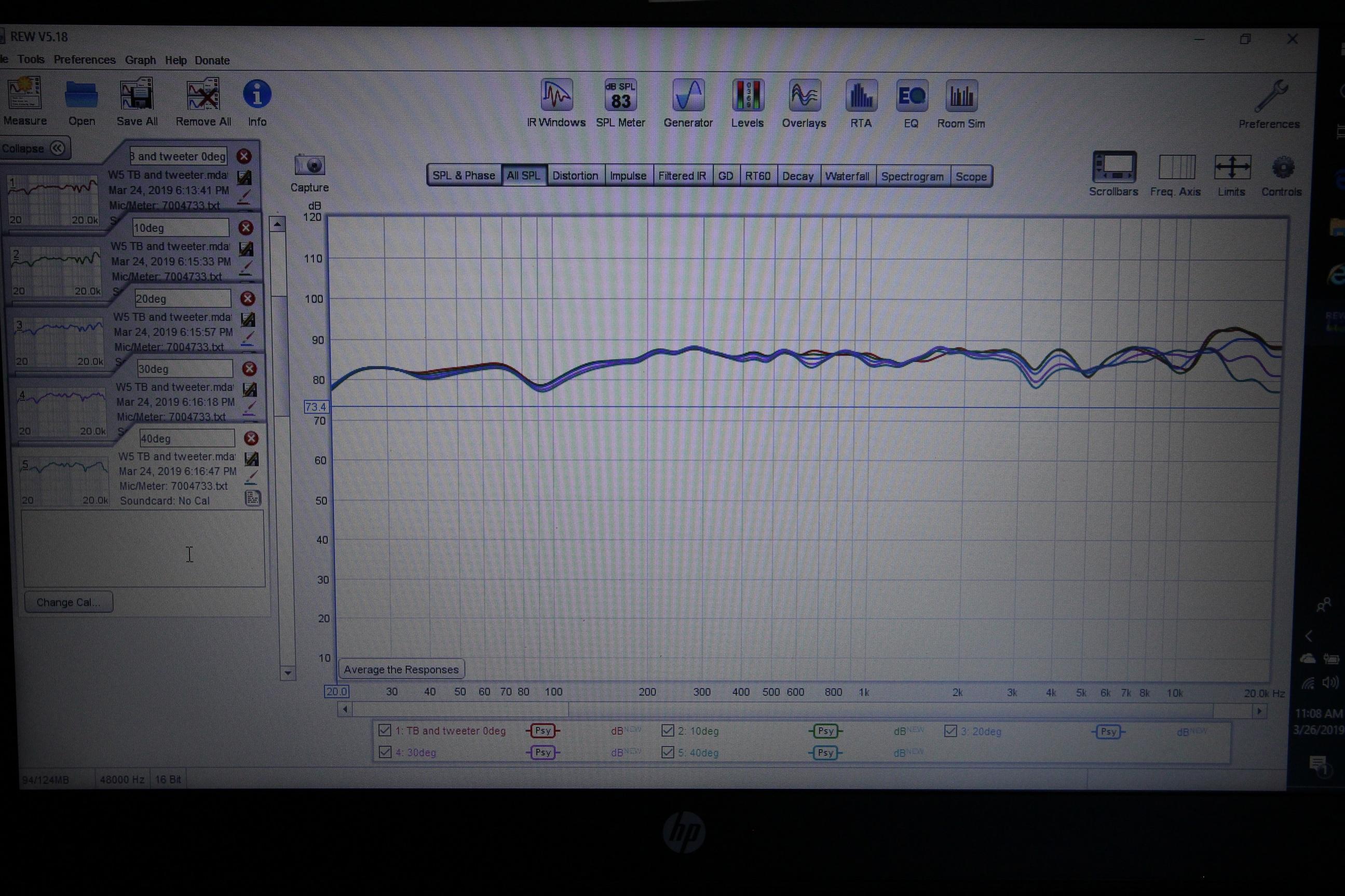

So I added the tweeter...this is how it measures now. Much better. More importantly, pseudo-coax combo now sounds great. Perhaps too sparkly, but that is way better than boring. Now it has relative uniform of axis response, it paints the room with uniform peasant sound. Highly recommended.

Glad that you like it as it is. Good for you. Constant directionality or at least controlled directionality is important to me. I perceive speaker with abrupt change in directionality as partly flawed.

sorry to bring up a dead thread but I've got these in the Frugel-Horn Mk3 and am almost pleased with the sound
like you already noticed, they are missing a lot up top. I'm going to give a rear tweeter a try and see how they measure.

Try it and see. Being rear firinf a lot will depend on what it is firing into. Upfiring may also be an option.

yep, i'm going to piano hinge the mount so i can adjust angle. parts are on the way
should be fun experiment
