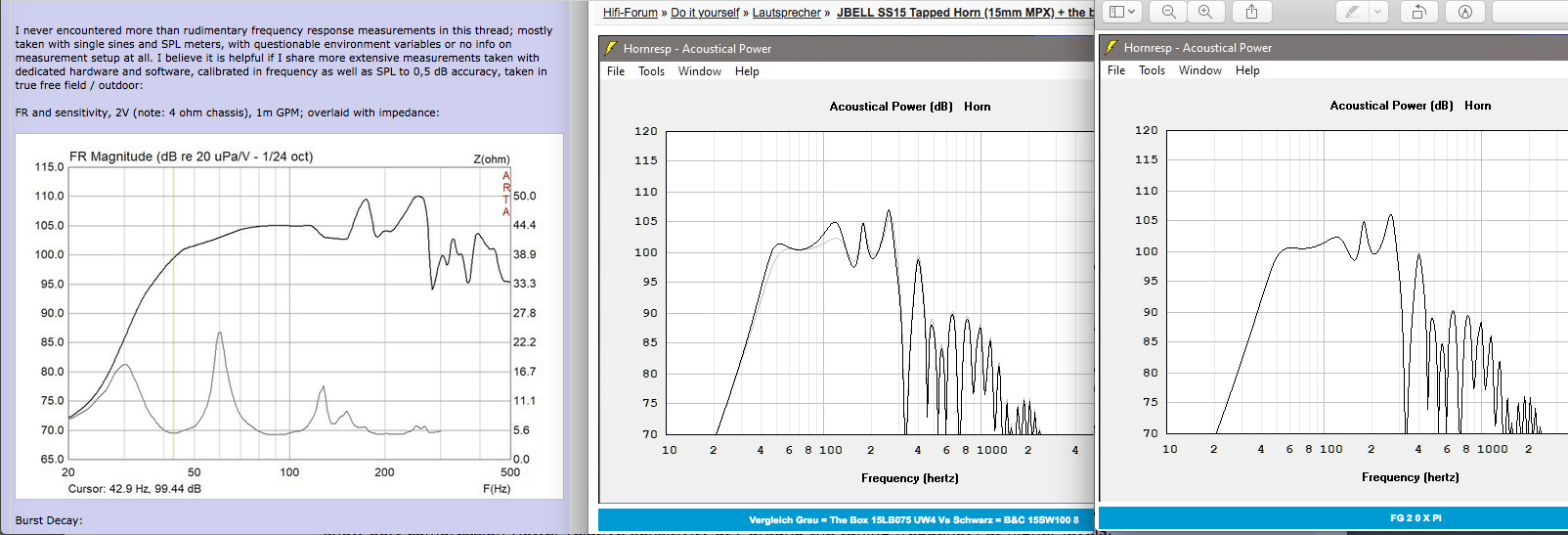

The SS15 is probably the best of the bunch you mentioned, though would be better built from 3/4" than 1/2" plywood.
The SS15 Fb is around 43Hz, output drops off steeply below 45Hz, not even 1/3 octave below 50Hz.
The measurement on the left was made with a 15LB075-UW4 speaker, the 3015LF response somewhere in between it and the simulations on the right.
The 4015LF is 98dB 1w/1m at 40Hz in a 38Hz Fb ported cabinet, the SS15 would give it ~+4dB more sensitivity up top, but may have little less output below, and will flap trying to get 38Hz, while the ported cabinet with EQ could pound down that low.

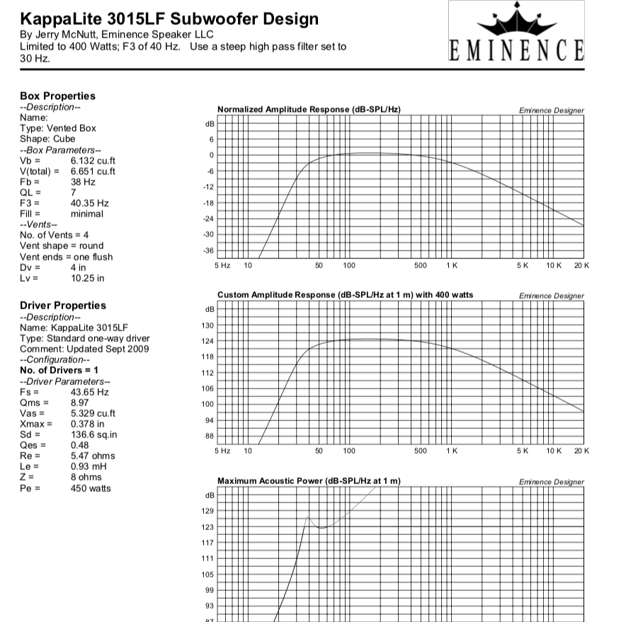

124dB at 400 watts is equal to 98dB at one watt:
The TOA cabinets I recall from the mid 1980s were big and well built, if they are around 5-7 cubic feet, I'd also suggest simply tuning them lower before building any of the designs mentioned above.
