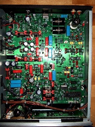

I picked up a Sheng Ya CD-S10 several months ago from a friend. This Chinese built CDP has a very decent sound. Many owners of the Sheng Ya CD-S10 have lauded their positive impressions of this player on a number of Forums reviews. This player has two tubes one 6DJ8 in the output stage and a 12AU7 in the power supply for voltage regulation. I have also heard that the 12AU7 is nothing more than a “show and glow” inside the circular window in the front of the player. I’ve rolled a number of tubes through this player’s with some improvements and some affect on the overall sound quality. Anyways, I’m considering performing some mods and upgrades to this unit. I did some research on this Forum and found very little on this specific player. I’d like to reduce the noise floor of this player for a blacker, quieter sound. I’m also looking to get more detail and clarity but without any harshness. The sound of the player is a little laid back. I would like to bring the sound a little more forward while expanding the soundstage. I’m looking for some ideas and opinions.
I have tried unsuccessfully to get a schematic of this unit. This gray market product has no distributor in the USA so support is all but non-existent. My initial plans are to replace the Raltron clock (Model CO-72E-T, 16.9344 MHz) with a better clock with a separate PS for the new clock. A picture of the board with the clock is shown in the first photo.
Additionally, I would like to change out some of the opamps. The second photo has numerical designations of the player’s opamps. Opamps labeled 1 & 2 are BB OPA2604’s. Opamps 3 & 4 are NE5532’s, and opamp 5 is a BB OPA2134. I’m not sure what function all of these opamps provide? I don’t want to needlessly replace any opamp that won’t serve my overall objective

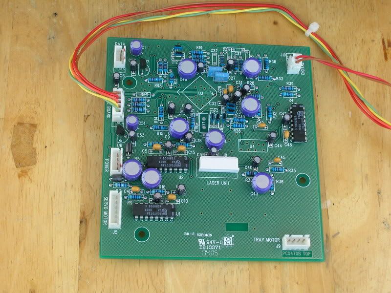

Last of all I was considering replacing some capacitors in the output signal path and potentially in the power supply. The 3rd and 4th photos show the PC board for signal processing and the power transformer. The picture of the entire board shows most of the player’s functions HDCD and line stage pre-amplification ability.
Your perspective and ideas are very much appreciated.

If you can take a pic of the opamps and output section this could help......
reclocking is good but do that last ! squeeze what you can out of the existing parts and then be blown away with the reclocking ....!
first find the dc blocking cap in the output...this will be the last cap normally an electrolytic following the last opamp......replace with stacked [parallelled] film caps ....say 10 x 1uf wimas 63v per channel.
Alternatively fit using flying leads a big paper in oil caps say 10uf 200v you can pick these up of ebay .. most are ex soviet military ...the ones I've got sound sublime liquid, fast, clean makes you realise how much the fitted caps are actually destroying the sound.
if you fit good sockets at the same time these caps can be wired straight to the output ...but you will need a resistor from signal to earth for each chanel ....try a dale vishay rn55 50 k- 100k a lot depends on what the preamp wants to see ...so you have plenty of wiggle room.

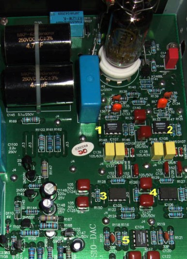

I was having trouble posting multiple pic's. Here's a pic of the opamps:

One of the top right hand corner would be useful too
As far as is possible from the pic .....
it appears that its relay muted which is good ...the single valve is in the last thing in the output.
there are sets of opamps ..but its impossible to see types
the front valve ......is it like my headphone amp in that its just for decoration ?

the opamps will buffer filter and add gain/buffer
for me the obvious possition to change would be the last opamp before the valve stage.
fit good sockets so its easy to swap them in the future.
As to what to swap to thats difficult ....I've just fitted some opa2227 that are making interesting noises and may go well feeding the valve
what are the two transistors doing next to the valve ? is one leg attached to the signal and the other to ground ?
you'll need a dmm to test ....
all the resistors look like cheap metal films ......those that arearound the opamps could be swapped for dale vishays for a worthwile improvment.
Are the two 4.7uf in the signal path ? [they ought to be ]
these are good but theres no harm swapping thes for more exotic types

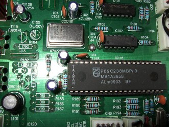

What DAC chip does your player use?. Looking at the picture .. it seems that the BIG IC is the microcontroller , not the DAC. I also see a 2 pin Crystal at the bottom right. Strange , most CDPs that i've open have the DAC installed close to the opamp and usually are SMDs mounted at the back of the PCB. Maybe you check this out to confirm.

Thanks for pointing out the little 12 MHz 2 pin crystal. I did not see that previously. I wonder what that is for?

As for the PCM 1732 DAC ... just check on the data sheet and trace the XTI/XTO pin .. this is where the Crystal oscillator output if connected. The 12 MHz 2 pin crystal is for the MicroController . The 16.9344Mhz is probably the one feeding your PCM1732., so this is the one that you would like to change .
