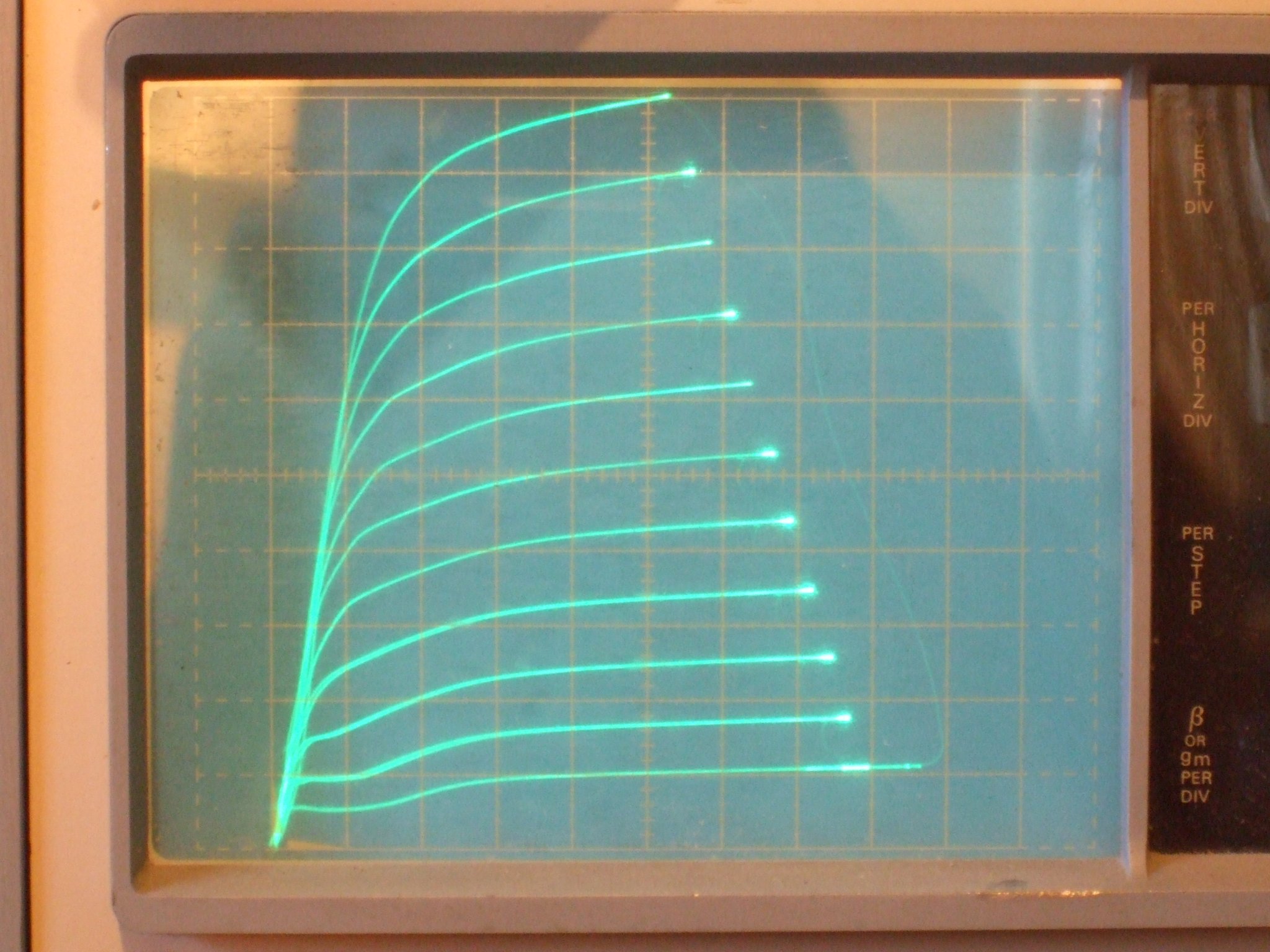

I curve traced some JJ KT77 tubes and was impressed with the curves. Much better than the old data sheets.If someone wanted to try replacing the EL34 pentode with a beam power tube, the KT77 fits the bill perfectly.
I can't find my JJ KT77 triode curves at the moment, but they look just like these:
https://www.audiomatica.com/tubes/kt77.htm
UL mode curves there too. The KT77 definitely has better triode curves than the EL34. Have seen it commented on.
JJ datasheet: https://frank.pocnet.net/sheets/163/k/KT77.pdf

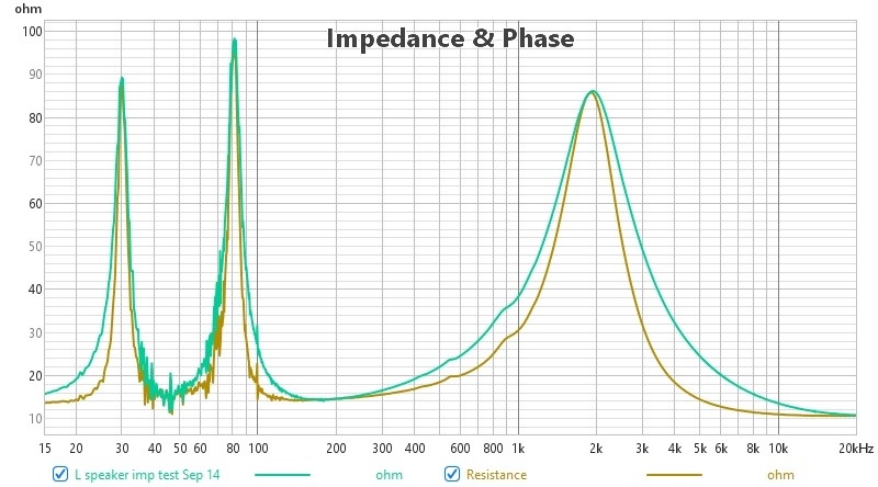

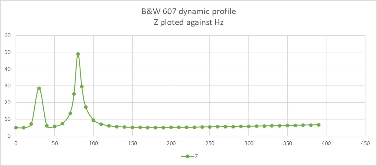

Hi 6A3sUMMER,
Apologies for my late reply, I had to find a little bit of spare time, today is a Bank Holiday for me so I set to to determine the impedance (Z) for my B&W speaker.
As I did'nt want to separate the drivers from the cross over etc, my readings are all from the binding posts with the links inplace linking the mid range driver to the tweeter .
DCR is the purely resistive value as speaks have a inductance I've measured and calculated the impedance 1st with a resistor in series measuring the voltage across the resistor and across the speaker through a frequency sweep 0Hz upto 400Hz. this allowed be to determine the current and then the impedance.
Just to play around a little further I then used REW software to run a frequency sweep to again calculate impedance.
I've determined that the free space resonance (Fs) where the voice coil is vibrating with maximum peak to peak amplitude is 30Hz and 80Hz
I've included my excel plot of the dynamic profile as well as the REW results , I've not gone on to calculate the Thiele Small measurements as I think I would need to disconnect the cross overs.
I know this thread is'nt a speaker discussion but if I've got my calculations correct I would be interested in people thoughts and is there a optimum Push Pull amp for these speakers...

gt6hudson,
No, I am not suggesting that anyone open the loudspeaker enclosure,
and even for an open baffle enclosure, I am not suggesting the disconnecting of the drivers from the crossover.
Measuring the DCR of the loudspeaker input terminals is the 2nd easiest test of likely minimum impedance that a loudspeaker might present to the amplifier.
The easiest test of a loudspeaker impedance, is to diligently search for a review of the loudspeaker that includes a graph of the impedance test.
When I had access to the $50,000 Rohde & Schwarz vector network analyzer, the $10,000 precision cal kit, and the DC return loss bridge, it was so easy to test the impedance from 10Hz to way beyond audio frequencies, if I wanted to test that high.
Now I manually test loudspeaker's impedance, much more labor intensive.
But I always start with DCR of the terminals on the back of the enclosure.
Generally, at all the frequencies where the current and voltage are in phase, the impedance is Either at a Maximum, Or at a Minimum.
That makes it easy to find most of the likely suspects, just roll the signal generator frequency slowly to find those impedance points.
