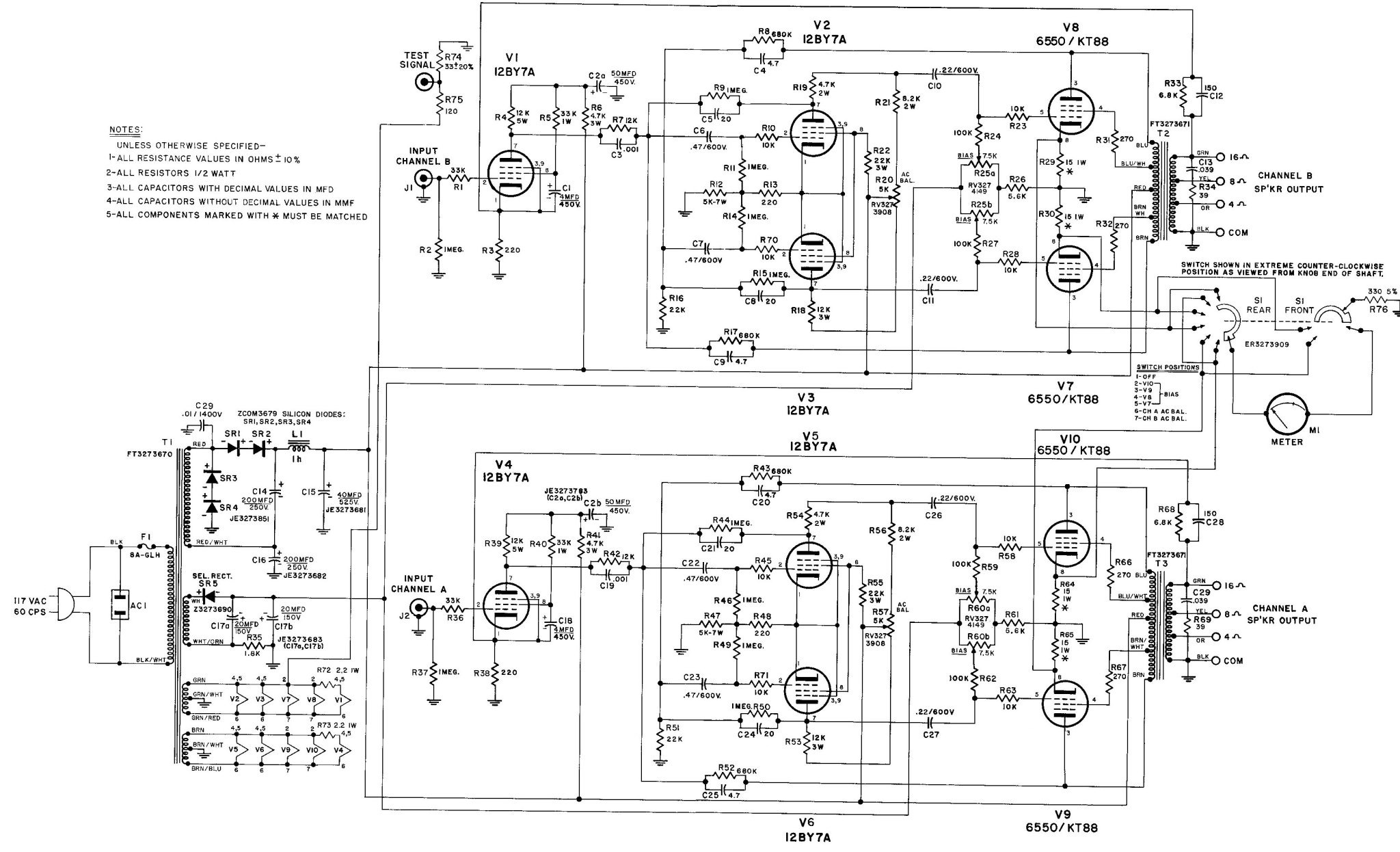

For the Dyna Mk III Circuit, be sure to purchase very well matched KT88 tubes.
Warning: Fixed Adjustable Bias 6550 tubes need Rg return resistors of 50k Ohms Maximum; the Mark III uses 100k Ohms, way to much (can not just change to 50k, the driver will distort to drive 50k.
If the tubes are not matched, the output transformer will hate you, and you will hate the performance of the output transformer too . . .
Saturated Laminations.
Global negative feedback never fixes saturation, it only makes it worse!

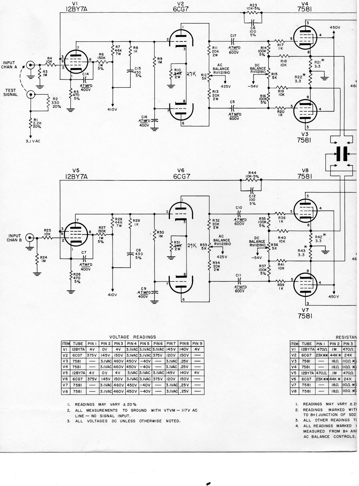

Recently, the HK Citation II has been successfully cloned using some cheap Antek OTs:
https://www.diyaudio.com/community/threads/citation-2024.416813/#post-7778673
Usually this Amplifier gets hyped up so much that DIY is unthinkable without possessing the original HK OTs. The reality is that the "local" N Fdbks ( here just meaning: NOT including the OT in the loop ) reduce the loop gain for the global Fdbk thru the OT to similar levels as a typical Mullard 5-20 clone/variant/upgrade. ( EICO HF89 ) This HK amplifier with KT88s meets the power requirements stated.
In any case, the same OTs could build the EICO Amp as well.
The HK Cit II could be even further modded to become a -Low Cost- amplifier. The $12 12BY7s can be replaced by plentiful $3 6197 tubes almost transparently. ( just a pin-out difference, same gm, mu factor and Rp ) The $240 to $300 a Quad of KT88s could be replaced by $3 6HD5 tubes IF the UL mode is dropped. ( Stew Hegeman himself said the UL mode was a mistake for this amplifier )
As for all the mysterious local FDBK loops, they can mostly stay the same. The inner most loop around the 12BY7/6197 drivers just lowers the driver output Z, and the crossed KT88 plate to 12BY7/6197 driver grid loops perform the "local" N FDBK for the KT88s or 6HD5s to linearise them. Without the UL mode, the plate to driver FDBK resistors -could- be dropped in value slightly to make up for the missing UL loops.

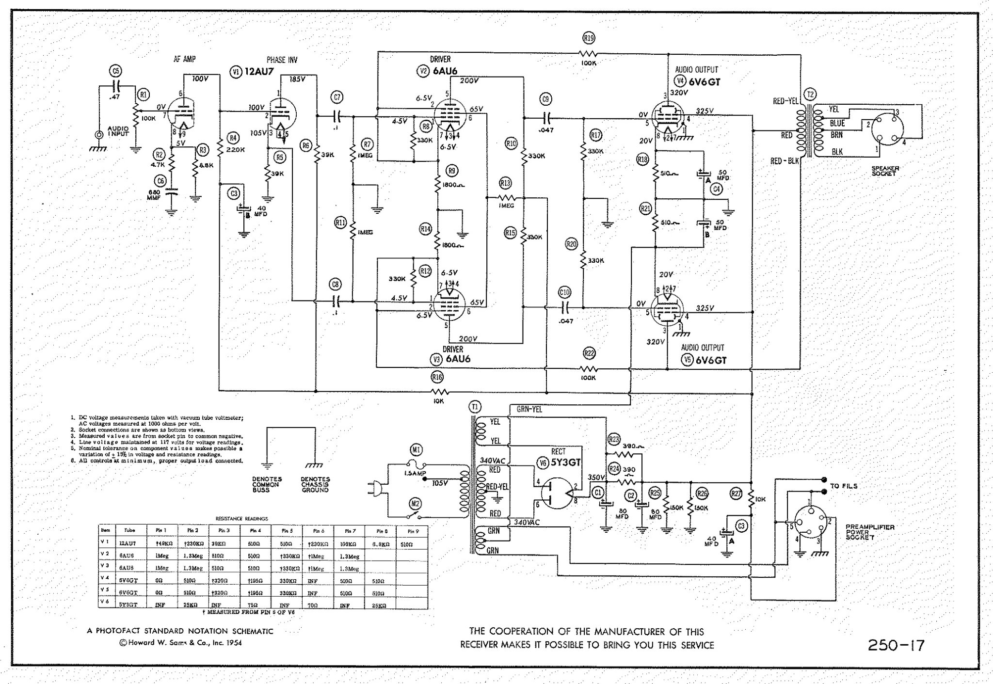

Another approach would be to upgrade ( for more power ) the highly respected RCA SP-10 amplifier. This amplifier uses a -conceptually- similar design as the HK Cit II but with some detail differences. Similar tubes and OTs could be used, 12BY7/6197 and KT88/6HD5 tubes should work fine, but many other combos could work as well. The RCA uses triodes in the front end, and pentode drivers. The CIT II uses a 12BY7 front end. Both use pentode drivers. The HK reduces the driver gains with a local loop to be similar to triodes for Zout. The main driver difference being non-crossed FDBKs to the SP-10 driver cathodes instead of crossed FDBKs to the Cit II driver grids. Similar results.
The RCA SP-10 needs an overdue upgrade for today's power needs, a very useful exercise.
Of course, either of these schemes can have the N FDBKs reduced ( higher value FDBK resistors ) if you want less precision and more traditional tube sound.

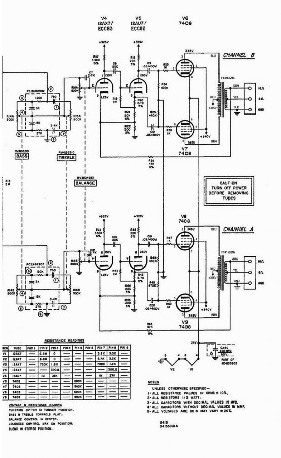

Citation V . . . an interesting amplifier
I think the 7581 Beam Power is similar to the 6L6GC Beam Power. Only the GC has the plate dissipation of the 7581; 30 Watts.
All the other 6L6 versions plates can Not take 30 Watts.
The 7581A plate can dissipate 35 Watts.
I think the Mullard 5-20 used EL34 pentodes; 25 Watt maximum plate dissipation.
If someone wanted to try replacing the EL34 pentode with a beam power tube, the KT77 fits the bill perfectly.
The 7408 plate dissipation is 14 Watts. That 7408 amplifier in Post # 36 is a Harmon Kardon A300 assembled, or K300 (Kit, I built one)

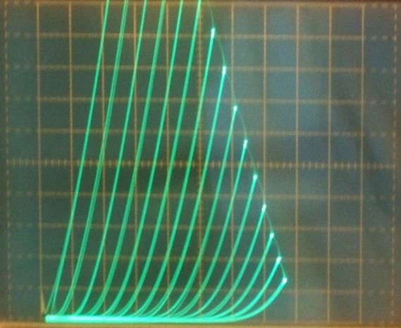

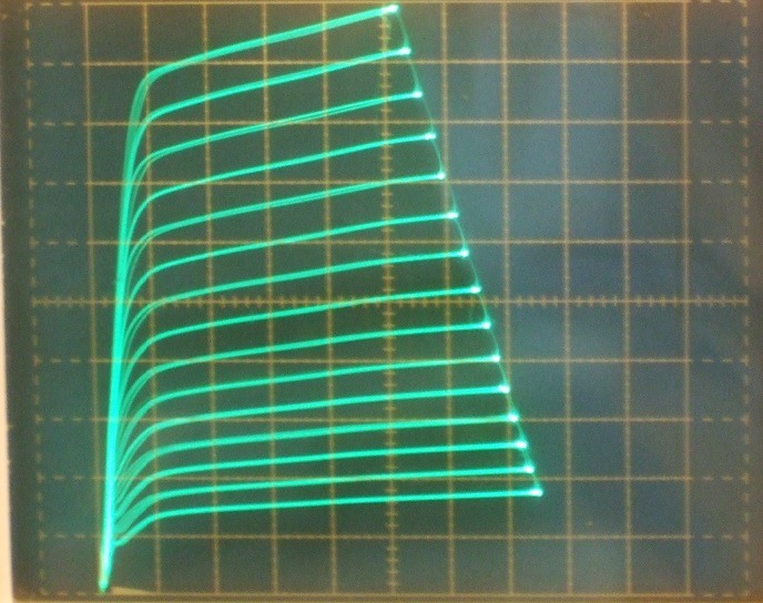

Well, If I were building any of these Amps I would venture to try the cheap 6HD5 output (already have it's cousin 6HJ5 ) with a lower Zpri OT and lower B+. One could even set them up for UnSet type drive, which can give you Xmitter type quality triode curves, without the usual HV or high Z OT expenses.
6HJ5/6HD5 with UnSet drive:
The 6197 driver candidate:
and 6197 in triode:

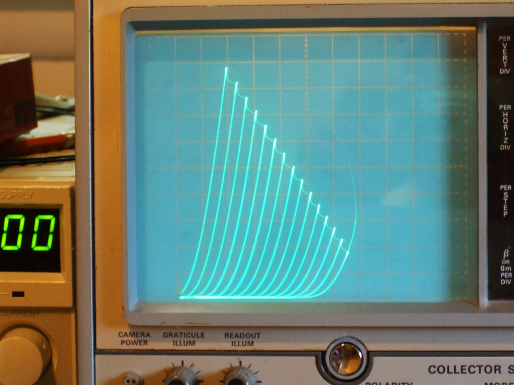

The Mil GE 6197 tubes I got in a sealed box are so well matched you can skip curve tracer matching.
While 12BY7 tubes I've tested were very un-matched. I've found that the 12BY7 support structure does not have enough anchor points to the Mica to keep the plates parallel. A TOO cheap TV video tube. Oddly, the 6197 tubes are cheap now, since they never found their way into Audio equipment.
