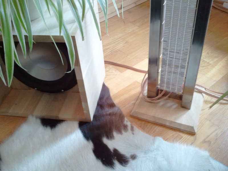

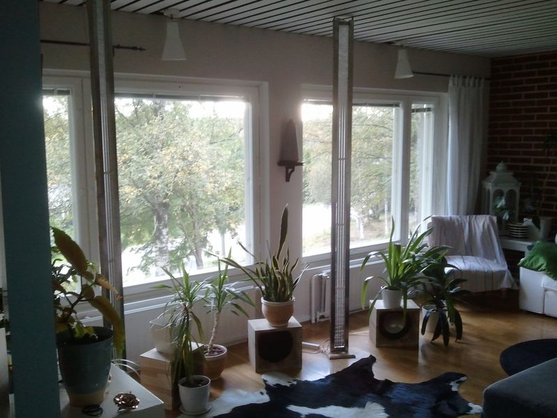

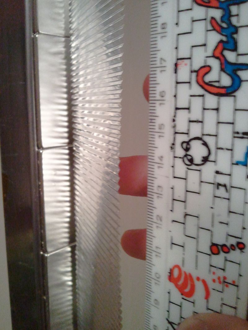

here are two pictures of my wide range ribbons. The ribbons are 70mm wide and made of 11um thick aluminium kitchen foil. Backing film is clear packing tape, because it happened to be thinner than 1mil Kapton tape.
Amplification is done by diy direct drive class A SE Mosfet amps and MiniDSP.
The question is about aluminium ribbon damping.
My limited experience is that pure aluminum has a lot of resonances and the best way to damp the resonances is to use plastic backing material and to divide the ribbon to narrow vertical slices.
However there are still annoying resonances in the upper midrange.
Based on internet info I have understood that Apogee Full Range speakers had 50mm wide pure aluminium midrange ribbons with about 15um foil thickness and without any Kapton backing? How did they manage to succeed with pure aluminium without severe resonances?
Is ordinary kitchen foil totally wrong alloy to be used in a ribbon transducer or should I try to treat it somehow e.g. annealing?
BR,
Hannu

you might experiment with embossed bumps on your foil rather than folding the foil. you can make the bumps any size you like. You will need a sheet of perforated metal or plastic with the hole size and pattern you want for the foil. rubbing the foil over the perforated surface will generate bumps in the foil. Best regards Moray James.

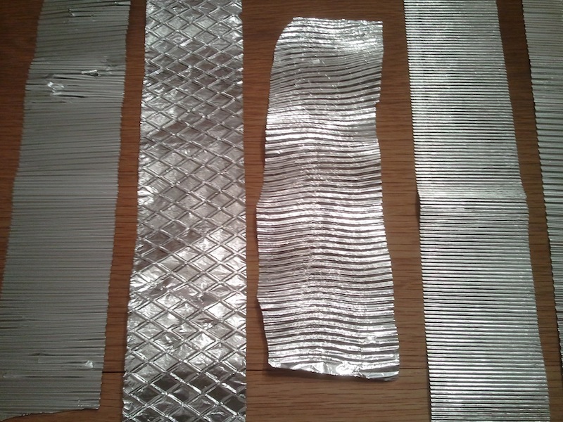

Thanks for your reply Moray James.

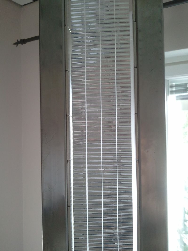

Here are some samples of different style corrugations I have tried. Almost all are pure aluminium without any backing material.
The diamond pattern is closest to your suggestion of embossed bumps.
Maybe I should try diamond pattern with plastic film backing.
And yes, all the different corrugations sound different from each other.

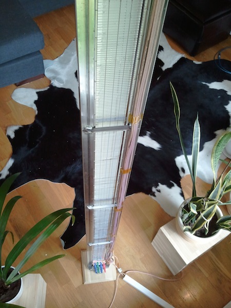

I received a question about more detailed construction info.
So here are a couple more pictures.
The ribbon frame is made of 30mm square steel tube. Some horizontal structural braces are welded behind the frame.
The bottom baseplate is screwed to steel frame (steel tubes have welded nuts inside).
Neodymium magnets are 50mm x 25mm x 3mm. Magnets don't need any glue to hold in place.
Ribbon frame height is of course from floor to ceiling. 🙂

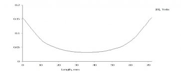

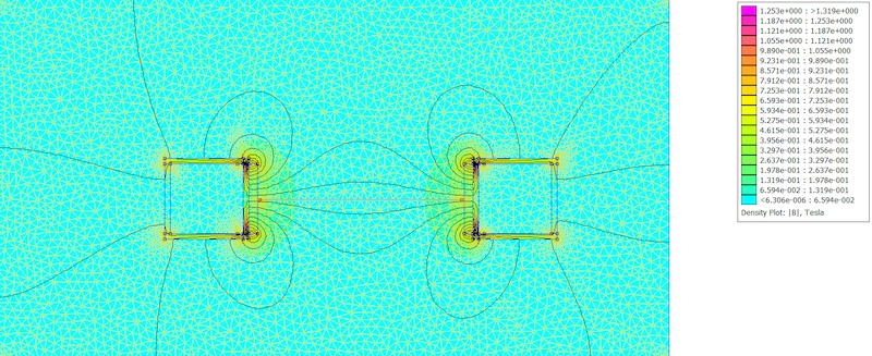

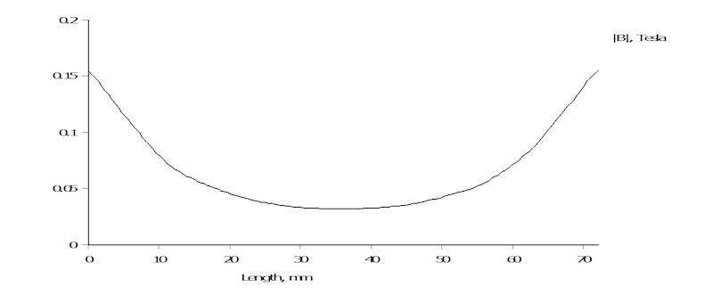

I guess I should point out that my ribbons are pushing the limits of ribbon design. 70mm wide ribbon combined with reasonably priced neodymium magnets leads to low efficiency due to low magnetic flux density.
I have attached couple FEMM modelling pictures to show the low flux.
This doesn't matter in my active system with my listening levels.
Ribbon high pass filter is LR4 at 140Hz.
A more standard wide range ribbon design would be 50mm wide ribbon with 200Hz LR4 high pass filter. It has higher efficiency if built with the same magnets I'm using. (My previous ribbons were like that.)
And for anyone reading this thread, please feel free to criticize my opinions. I'm no expert in this area and I would love to learn more.

The corrugations are very shallow , are you able to duplicate along with the same foil ..? How are you driving the foil directly , even with 4 your impedance will be in 1 ohm range ..
I could try to duplicate Apogee corrugation if I knew how many corrugations/pleats they used per inch or cm.
Would somebody be so kind and measure how many corrugations per cm/inch does Apogee Scintilla or Full Range have?

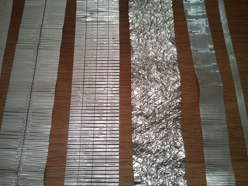

I have attached a picture of my finest pitch corrugation (the pure aluminium one).
I guess one difference is that my corrugation is triangle wave and Apogee used sine wave style corrugation? Any comments to this?
