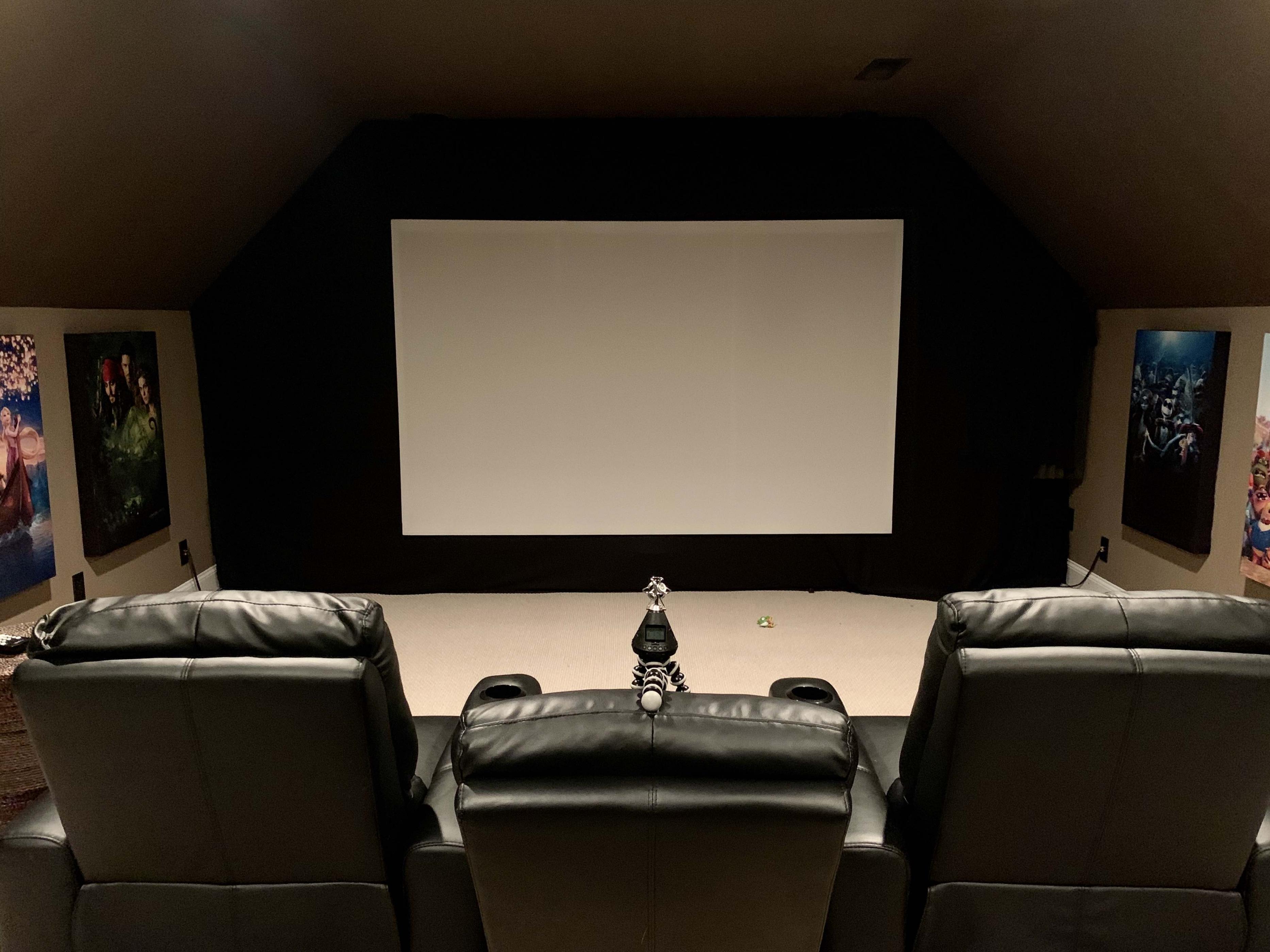

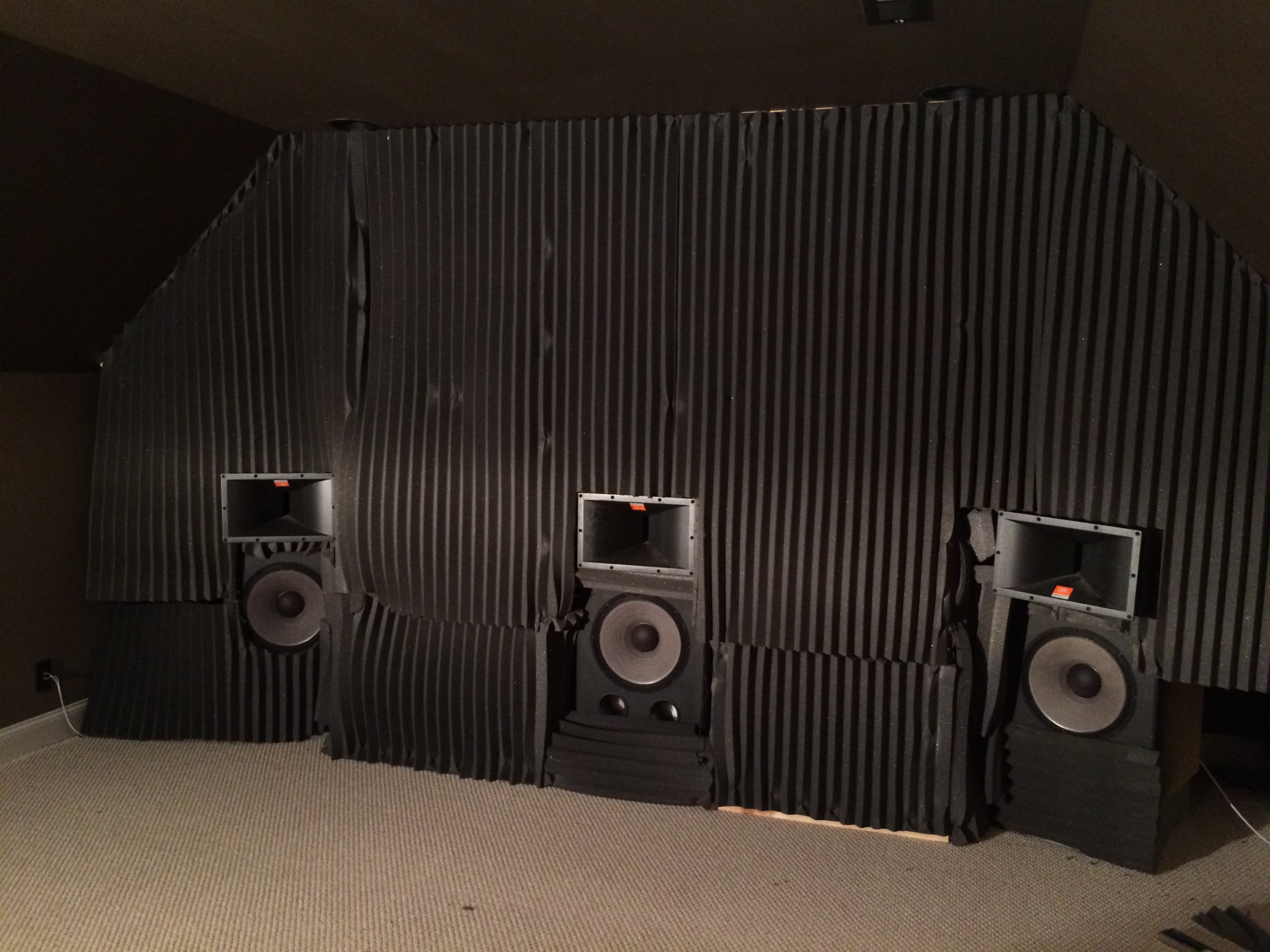

I edited the post above to discuss what I’m using. JBL Pro Cinema 2035’s in 4 cubic foot enclosures mated to 2446j CDs on (forget the waveguide model).
The speakers are about 3 feet from the back wall and a false wall frame (no baffle/actual wall) was put up. Then 2” wedge foam on top of the wall. All covered with black grille cloth and then a 120” acoustically transparent screen.
This is an “in progress” pic. With a final pic and the mic setup as well.

Thanks for the pix! That should sound great. I wonder why it was so bright? Maybe you'll have to record pin noise or sweeps and we can look at them.
Not sure. I haven't measured this system in YEARS. The drivers are ran actively off a Crown xls1502. The crossover point is somewhere in the 600hz area, IIRC. (it's a BIG freaking compression driver and horn) And that horn rolls off above about 8khz, IIRC. So that may very well be why you're seeing the drop off. Too many variables to know for sure without separating them.

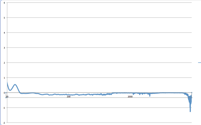

I plotted the specrum of a 40 second clip of music from each track. Didn't see a real difference. So I went a step further and exported the data to a text file then imported both in to excel, took the delta and plotted it. As you can see from the attached delta plot below, there is no appreciable difference until 20khz+. Between 20-20k the largest delta is 0.5dB @ ~35hz. For nearly all of the auditory spectrum the delta is about 0.10dB. Which is an acceptable limit for my purpose. I don't think there's any legitimate argument to be made as to the reduction in sound quality per the reduction in noise. At least based on the data I have on hand.
