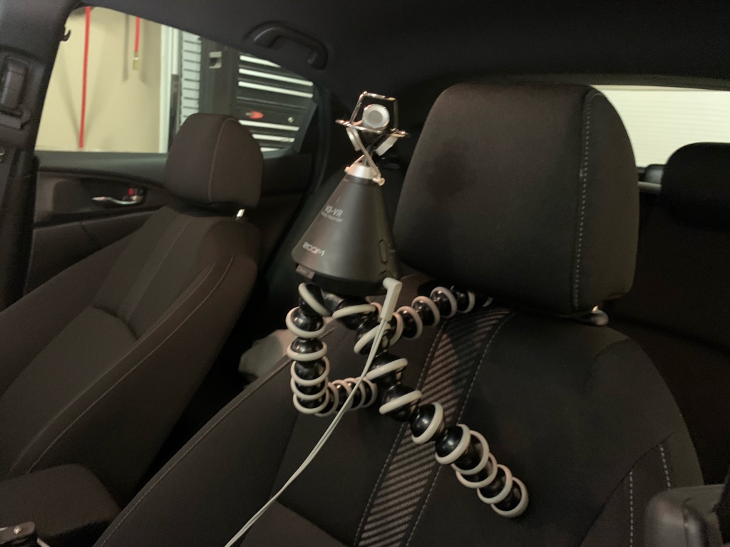

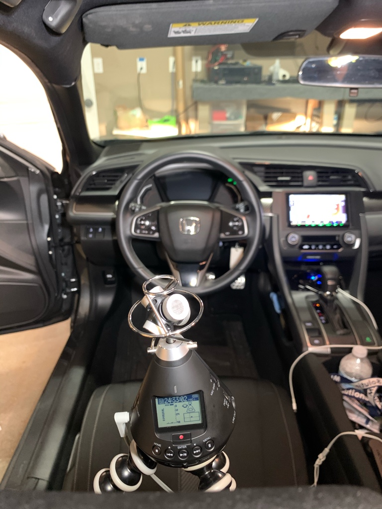

I've been tinkering with the Zoom H3 in my car. I use a DSP to get time alignment and levels set so the car stereo has a pretty good left/center/right setup. I figure if the H3 in binaural mode can replicate what my car does (in such a reflective environment) then it would be a viable candidate.
I'm still messing with determining the best balance for mic sensitivity and system output so I can get the volume I want. I'm NOT done vetting this thing but I did want to share the last recording I came up with before calling it a night (as you can hear, it was time for supper, LOL).

"your face is a channel". 😀
I'm fairly happy with the recording.
I will test this device out in my home theater tomorrow, where I expect the difference between left and right to be more apparent (in a car, the soundstage is limited in width by the physical dimensions of the car; you can't get wider than about 15 degrees on the left and the right side is as wide as 45 degrees so it's a very asymmetrical stage, even with using time alignment and level matching to help center up the vocalist between the two sides).

And I’ll say this... I was happy with the in-car results but I’m starting to think this thing may have too much self-noise to be useful. I have to bump the mic gain up a good bit to get it to match the level I perceive the volume to be and by doing so it introduces a lot of floor noise which I’m not happy about. I could simply turn the mic gain to zero but then I have to increase the system volume to a level that is much higher to my ears than it is to the mic.
So, I’m back to looking at the stuff from sound professionals linked earlier.
I’ll tinker around with it a little bit more but at this very moment I’m not sold on it and may wind up sending it back.

Sounds good! Very clear like Pano says. LOL! I love the 1 minute to supper 🙂
Gain matching to get the best SNR is hard. I see you have explored that a bit and concerned about the noise. If you go the Sound Professionals route, getting a portable mic pre with low enough self noise may be an issue and may not be an improvement over what you have. It's tricky...
Also, do you have a way of measuring dynamic range? I.e. like in JRiver or other tools. You could check the DR on the song in JRiver, then make a recording of the song in your car, bring it back and import into JRiver and run audio analysis and compare DR. Based on what I heard, it should be close. Also will give you some comparison of mic sensitivity and output levels so you can find the workable range...
