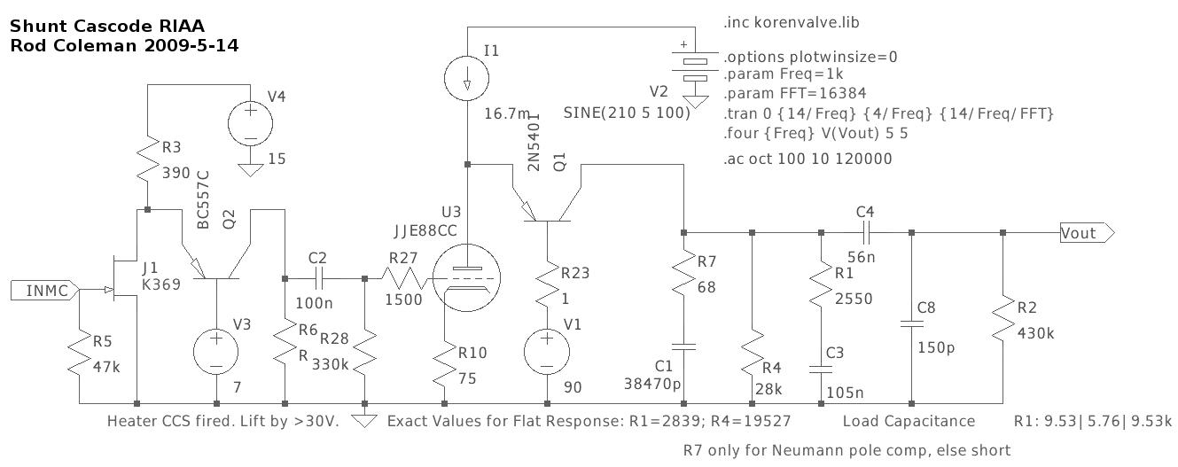

This is very much a folded cascode...I don't think it is a folded cascode, but I would like to ask you confirmation about it by describing how the circuit works.
Q1 keeps J1 drain voltage stable, so the voltage at J1's gate changes the current flowing through J1.
R2 is a CCS due to the constant voltages at both its sides.
The current through R2 can pass through J1 or R5, the latter will then become the output voltage.
If you want to increase the gain and accept an higher output impedance, refer the grounded side of R5 to a negative voltage and increase its value.
This is why I said that curves and load line are like a CCS loaded triode rotated by 90°.

I have just seen the same shunt vs folded in the original Rod Colemans' thread.

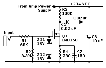

Perhaps you could use a depletion MOSFET like LND150 in place of the tube as in this example:
I would use a single bidirectional TVS diode (SA18CA) instead of the double zener but that's just me trying for a lower part count.
Removing C2 will make it far more linear with the expense of gain - this was designed for guitar use originally and other changes can be made.

Thanks kodabmx, I would like to avoid high voltages just for the line stage.
IMHE the LND150 works better if driven fom the source by a pmosfet (in source follower configuration) and the gate connected to a voltage divider from drain to ground to apply local feedback. Like the UNSET.

I did however make a simple depletion MOSFET (IXTP08N100D2) line amp. One device, 300V B+ and for 2V in you got 100V out - unless you put a bypass cap... then you got way more gain and like 45% THD (I'm guessing - the waveform was ugly).
Still, You can just adapt the same principle. Use lower voltage depletion MOSFET (or jFET?) on a lower voltage supply.
I don't know a lot about solid state parts, but if they make a small SIT, that would work well.

The circuit in #1 can work very well. The performance depends on a quiet and stable DC supply, and careful choice of the JFET, but it has the great flexibility of gain vs. output impedance vs. drain current that is not easily matched in other configurations.
I have used almost the same circuit to make a complete RIAA LP preamp, using Shunt Cascode JFET 1st stage, and triode second stage. It has been in used for many years with a Lyra Lydian Beta and later, a Denon DL103. Perfectly quiet to the ear, huge stereophonic image, and a distinct impression of being in the recording space.
