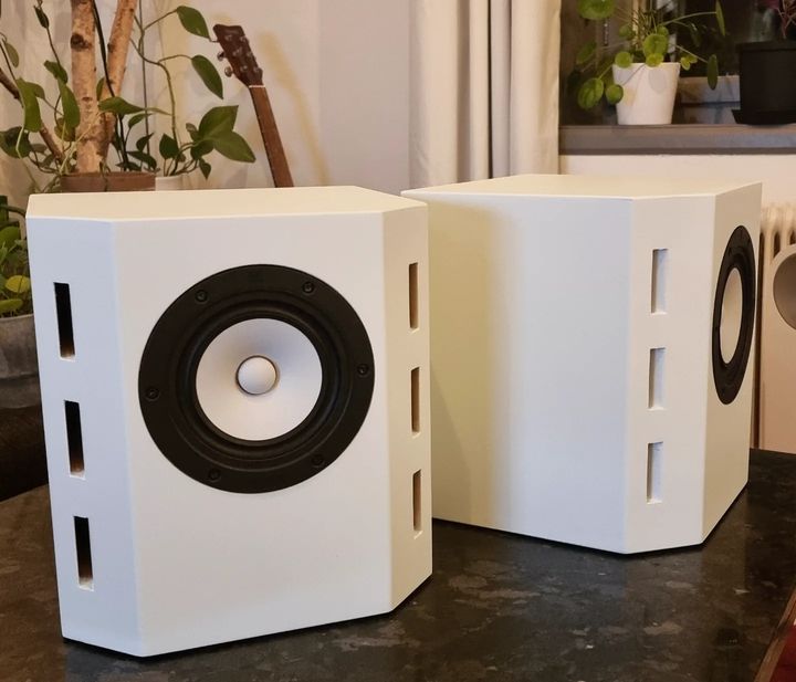

I could not find 18mm plywood, called one place but they would only deliver minimum 5x of them. I did manage to buy 15mm plywood today though, so I will go for a plan with 15mm. I was thinking of going with the Mar-Ken 10 plans then. I can buy 12mm as well to do the front (2x12mm), but will leave that for another day.
Also, in the plans for the mar-ken 10, the slots are 9.5mm thick. But I think I will have a rough time getting exactly 9.5mm. 9 or 10 is probably easier, got any tips for solving this? Is the best option to get 10mm and try sand it down a bit? Or is it acceptable to use 9 or 10mm?

Well if you want to do a design for a rectangle box similar to the mar-ken 10 I'll definitely build it! Usually easiest for me at finding wood in 3mm increments.

Thought I would update. Finished painting them, have played maybe 40-50 hours on them so far so still a bit to go. They look really clean!
