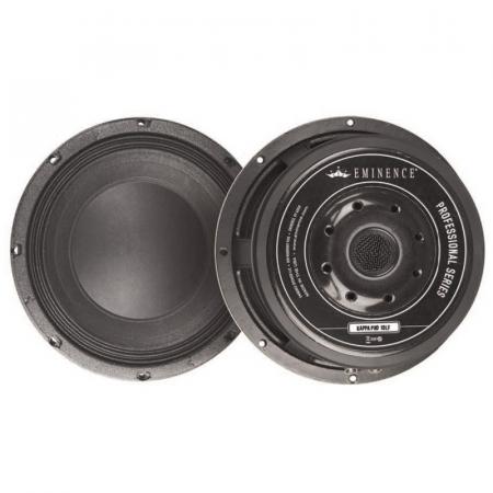

I know this is asking for a lot, but I found a couple of candidates like the Eminence Kappa Pro 10LF, the Sica 10SR2.5CP and possibly the Beyma 10G40. If you have any suggestions I’d love to read them!

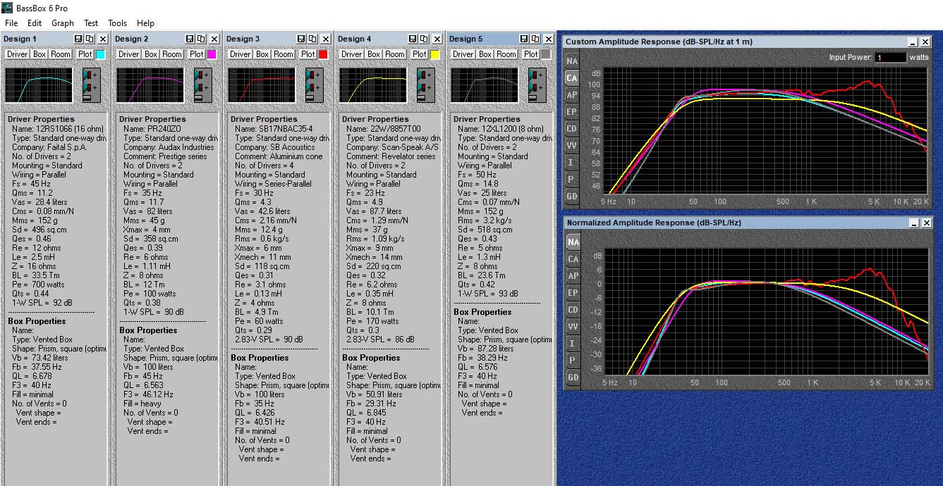

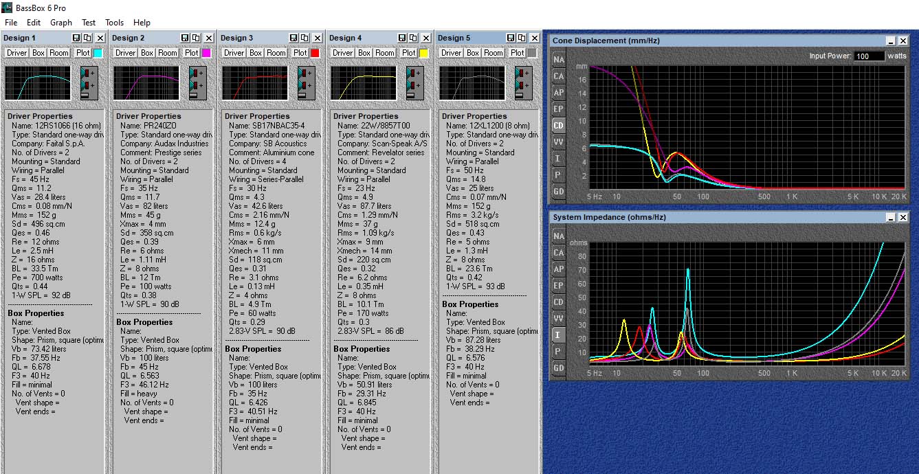

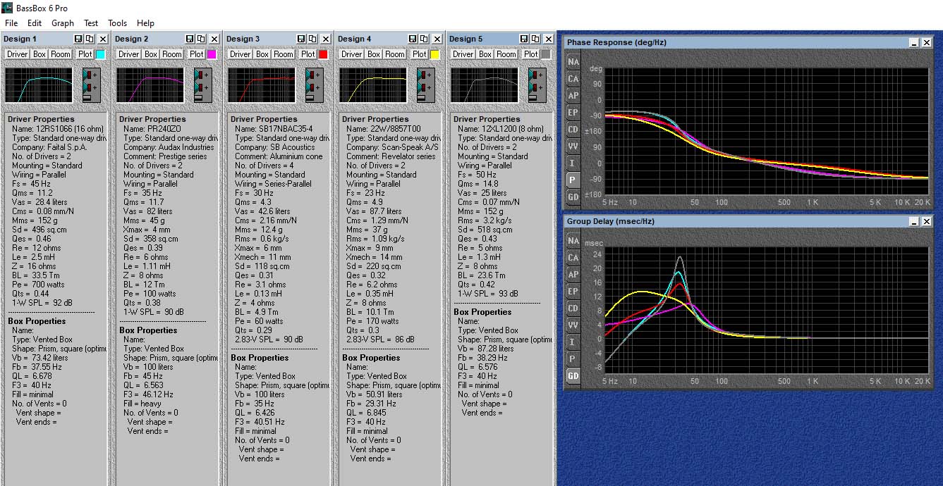

Alright, here's a look at several approaches, I will be going with the 4pcs of SB17NBAC35-4 option as that's one of the best and most cost effective approaches, it also gives me the option to build a slim floorstanding loudspeaker.
