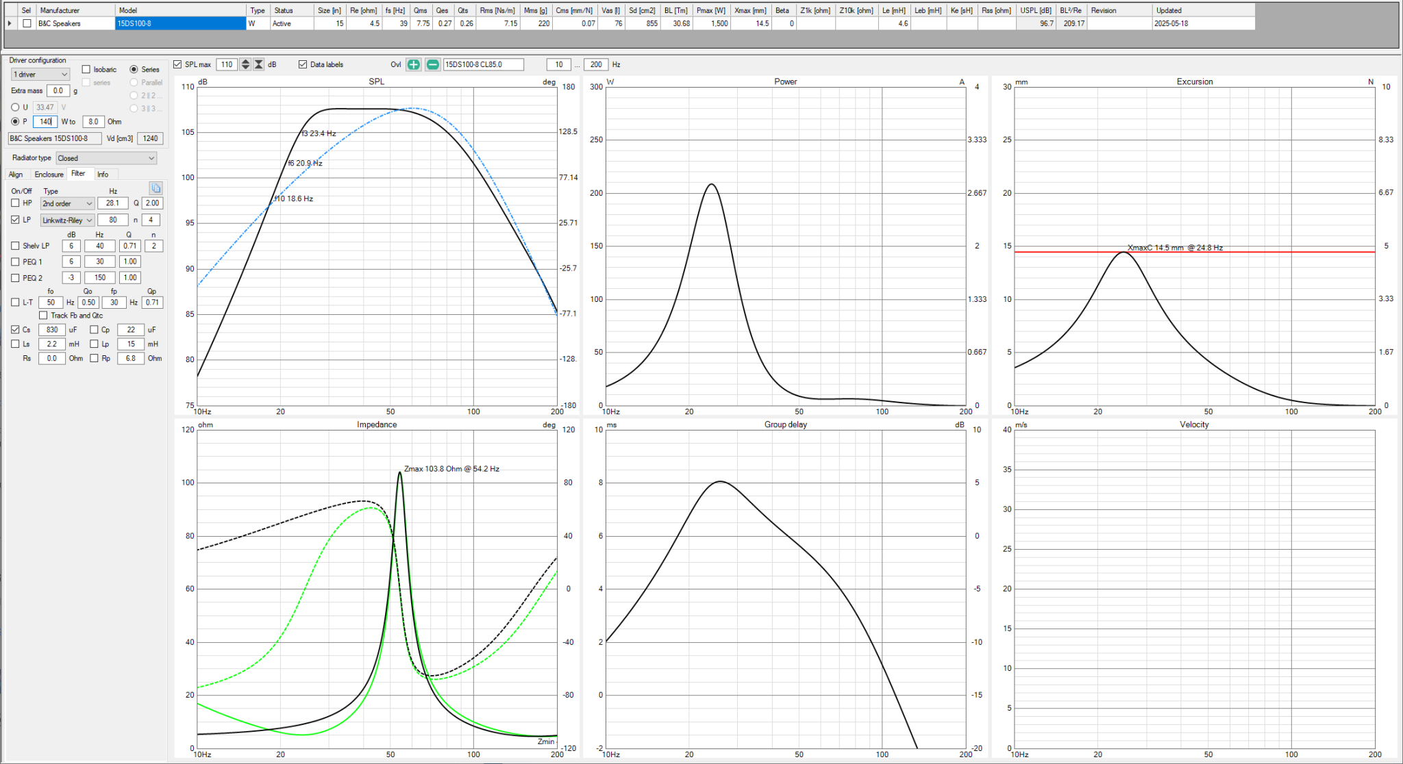

The 15DS100 has a relatively low Qts of 0.26, a relatively high Fs of 39Hz, and a relatively small Vas of 76 litres. Any traditional tuning will put it in a small vented enclosure that will result in a high value of F3.The DS115 seems way overkill and so im looking at the 15DS100. What do you think Witwald? Does that make sense?
If we use a sealed enclosure with Vb = 85 litres, we can achieve the following two sets of low-pass filtered responses. The black solid line corresponds to the response obtained with a series 830uF capacitor. The dashed ligt blue line is the response without the series capacitor. It's clear that adding the series capacitor significantly boosts the low-frequency response of this system. Of course, as its a sealed enclosure, we are displacement limited at a maximum SPL of about 107dB.

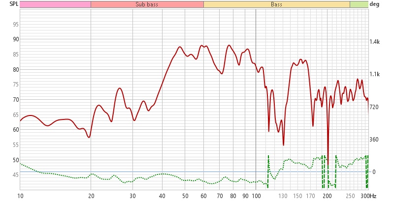

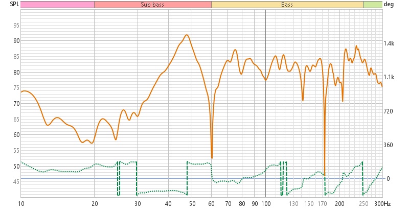

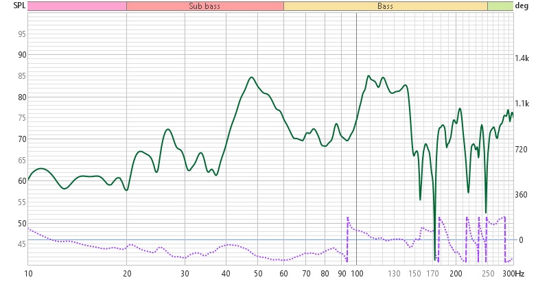

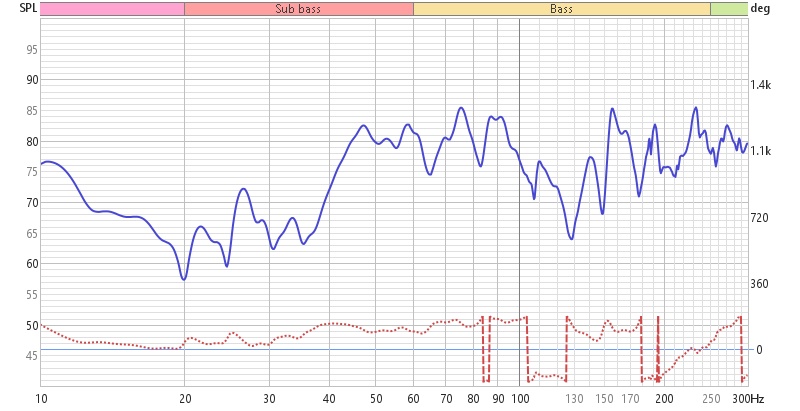

The findings are that the Revel main speakers have some room crated suck out between 110 and 150. because room is small and f208s are big i cant do anything about that. The low frequencies also seem to get less below 100hz. Therefore I decided to increase XO with the Daytons to about 125 and see how that goes. The mains at 140. it sounded better but the nul around 50 remained. On closer inspection it turns out I made a mistake assembling the diy sealed cabinet of sub number 2. A huge spike at GD gave it away. Turns out the speakon terminal was having a leak. I fixed it today and now both sub perform quite similar. for refrence: both sub cabs are 49x49x51cm (122 liter sealed)
I had to add 2 all pass filters on both subs and one on the mains and after some levelling, now they seem to be happy.
For now im not sure how to go further. I think im quite happy with the Daytons below 50 but above it remains a bit wooly. I think ill embrace GSG's Kevins suggestion to simply keep teh Daytons and add a nice 10 or 12" for more mid bass kick, also perhaps an even higher xo. Anyway, the ultimaxes seem to end sounding good around 130. I also decided to put them in stereo since that made levelling easier.

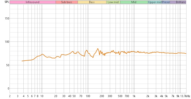

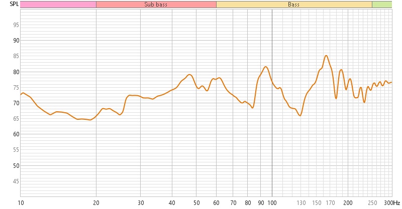

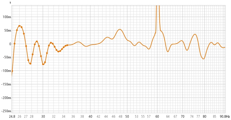

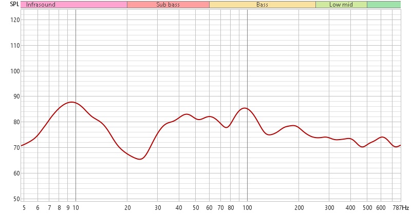

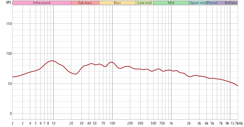

the max SPL that im looking for is about 110-115 but between 107 and 110 is fine too. Here are some graphs and measurements. MMM and MLP. Mains only and subs only.
this is the rta for levelling and fixing some boomy bass at 44hz, fixed now. I zoomed out to check if the slope is acceptable.
strange rise below 10hz, but no worries
bad sub cab exposed
mmm of current situation of all 4 speakers
larger scale
sub 2 xo125 after cab fix
sub 2 before leak fix

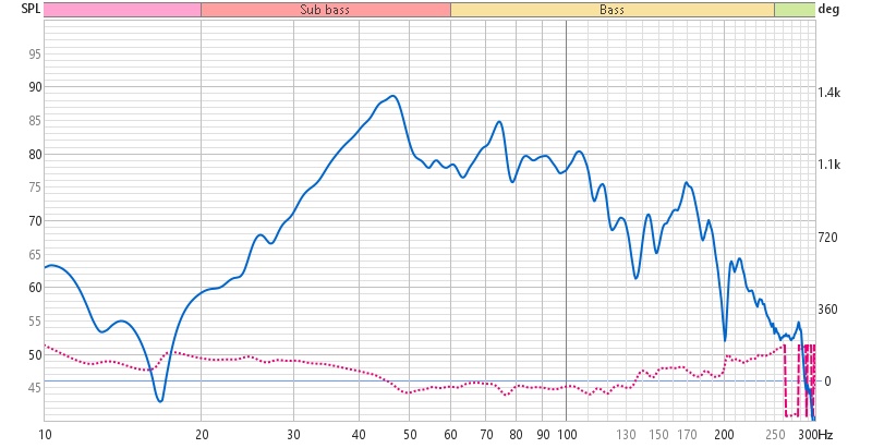

sub 1, the older spec ultimax (the other is ultimaxII)
