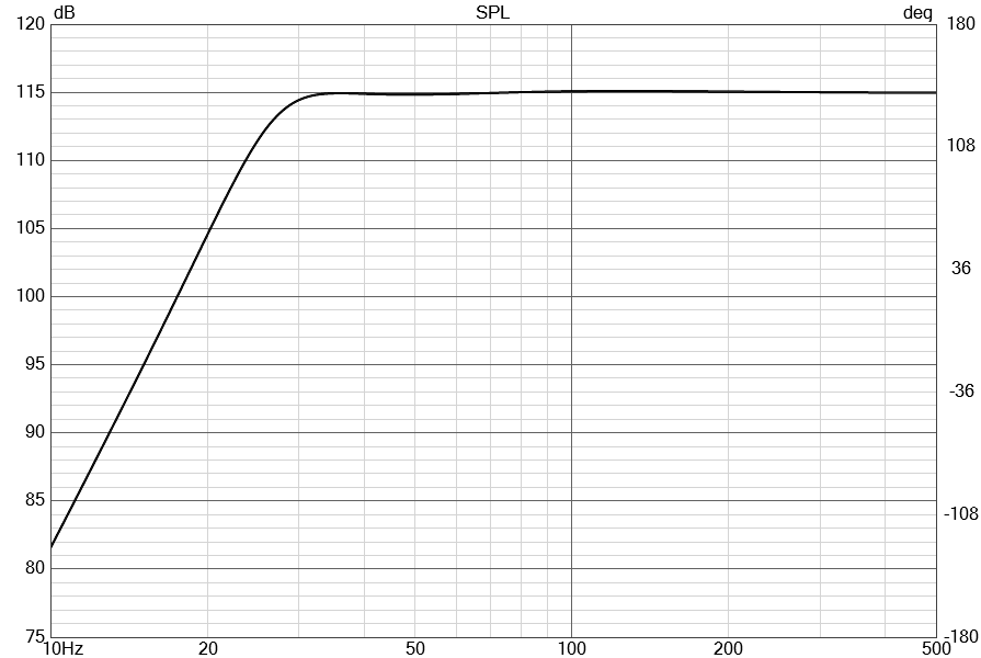

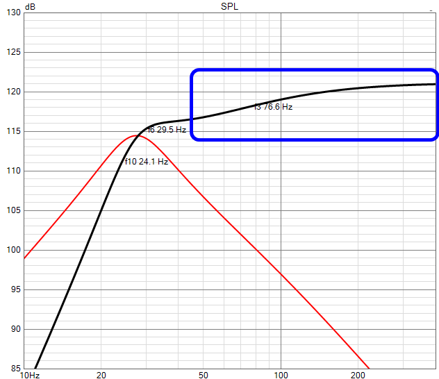

The low-pass shelving mode, applied with a negative gain at higher frequencies, can be put to good use to flatten the natural vented-box response of the 18SW115-4Ω/18SW115-8Ω drivers. The region of application is shown in the picture below.
By applying an appropriate low-pass shelving filter, we can get the following response. Notice how flat it is. I was a bit surprised how well it worked. The response is −3dB at about 26Hz or so.

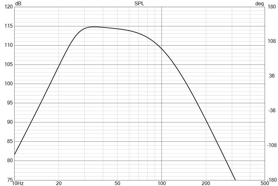

We get a very nice low-pass filtered response when we add a 4th-order Linkwitz–Riley low-pass filter set to 100Hz. This subwoofer should blend in very cleanly and smoothly with the main speakers when they use a complementary 4th-order Linkwitz–Riley high-pass filter.

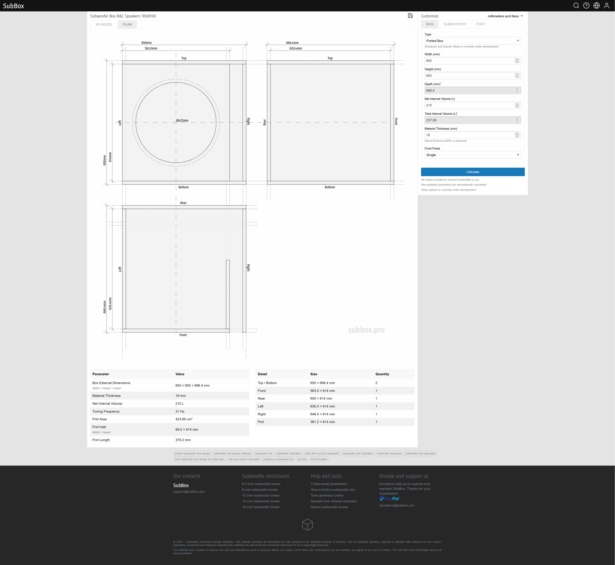

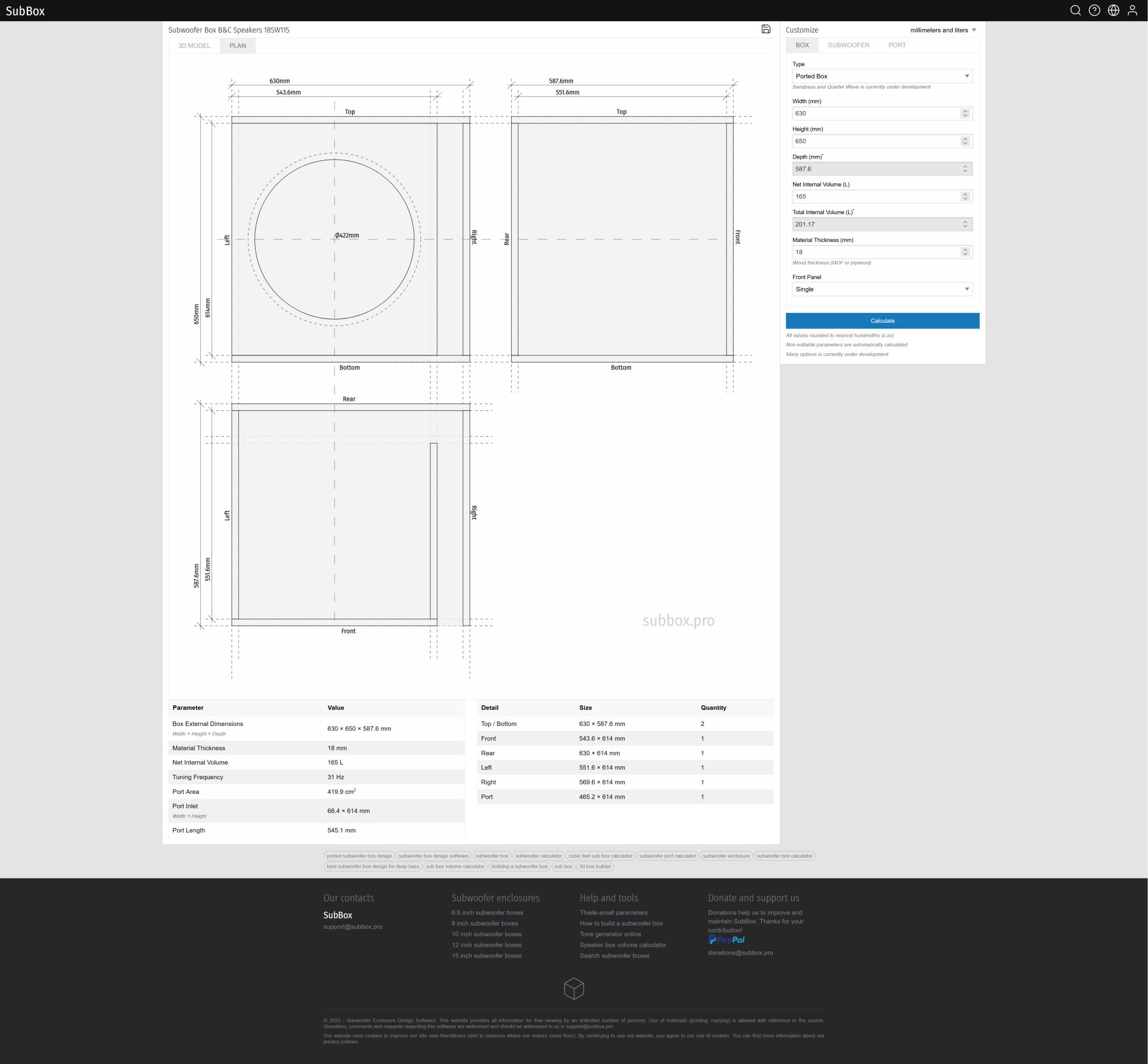

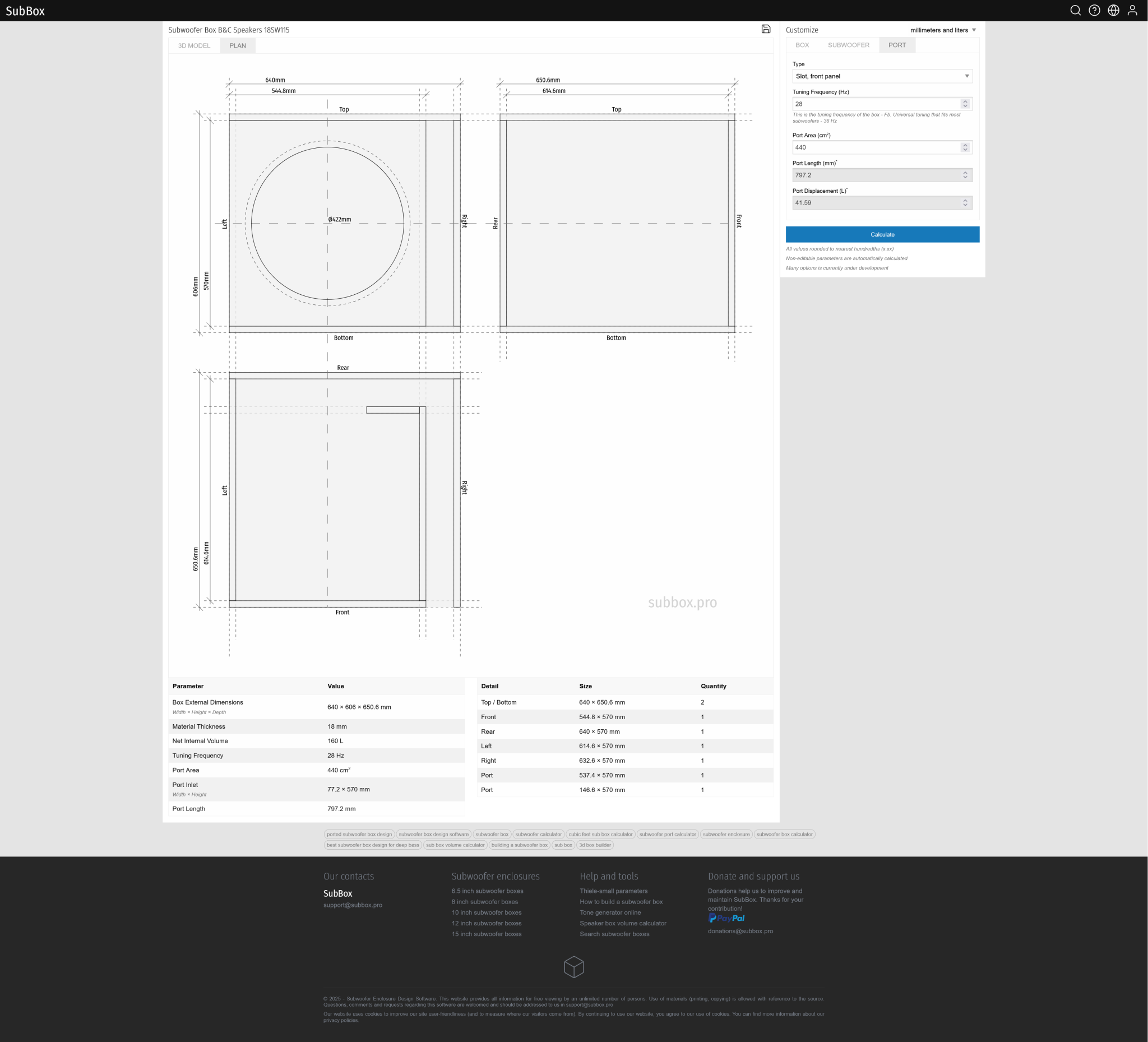

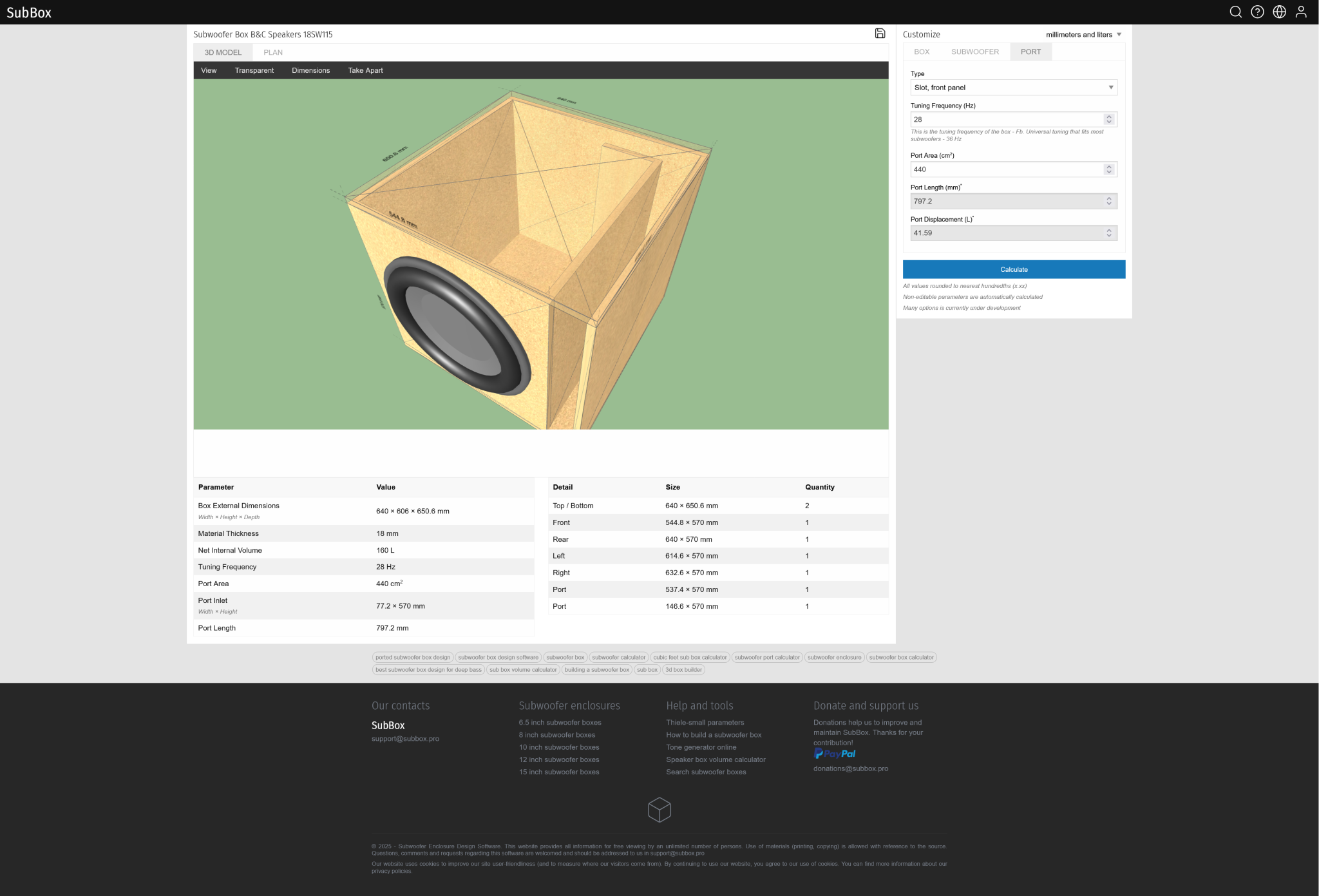

I did manage to create something in subbox.pro. I chose a 34Hz tuning freq since I couldnt get your 28hz suggested tuning frequency to work well over the entire range to 100hz. Can you run a 34hz config through your software @witwald and either confirm or warn me not to do that and instead go for the 28hz version? I feel its getting close to the drivers limits and close to a high pass filter I need to implement.

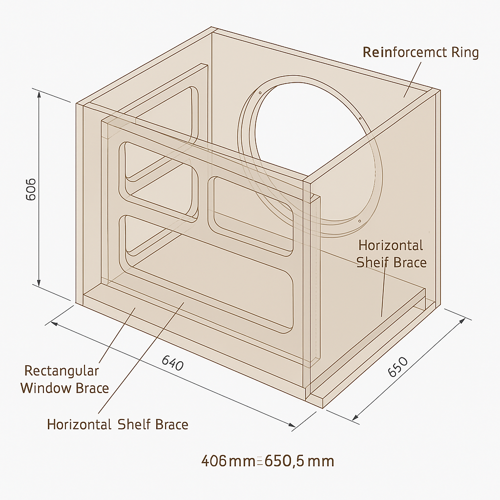

This design I ade in subbox.pro. However, I dont see any bracings. Does it matter for the final design much if you add bracings? I guess in a ported design you dont add wool or only strictly to the walls?

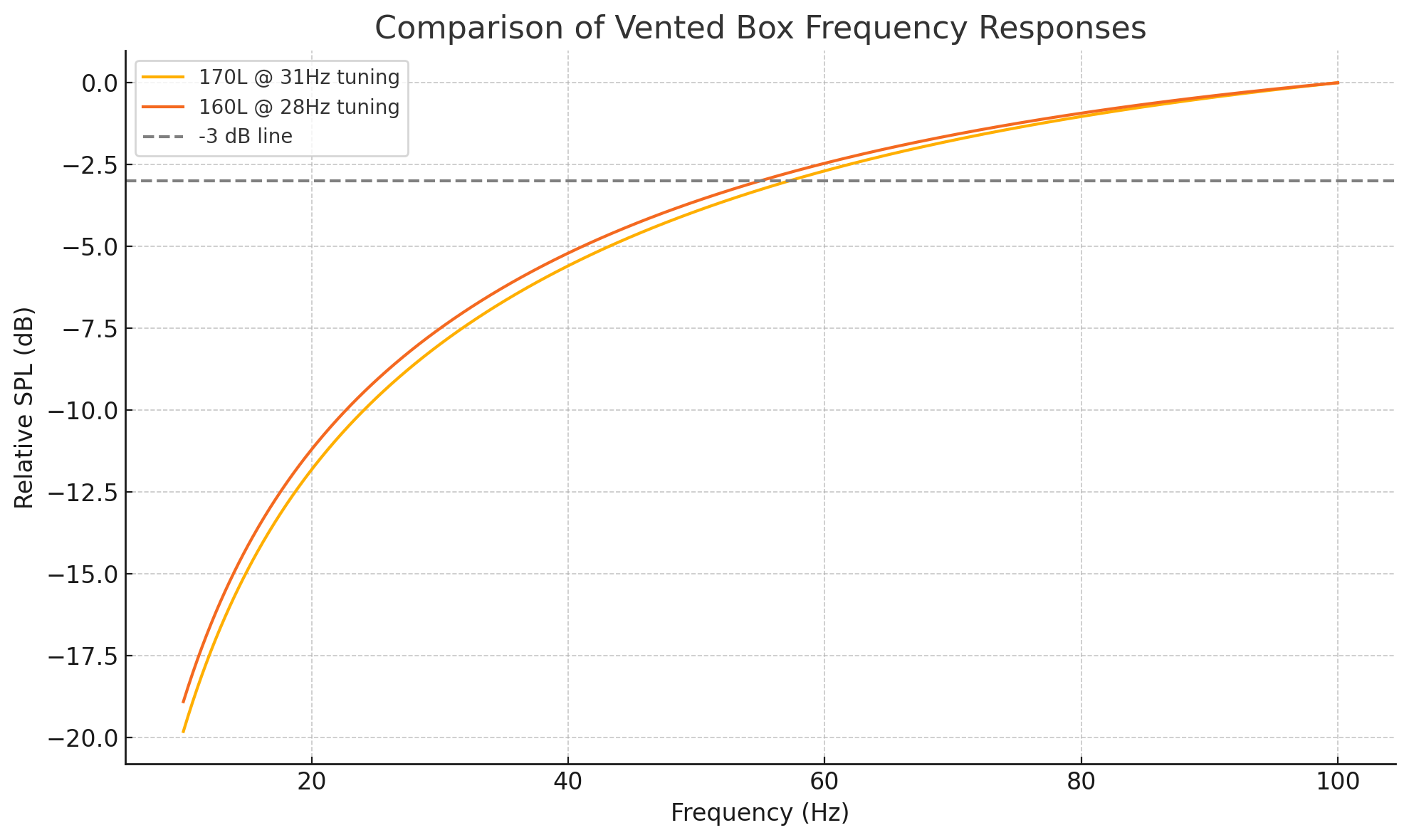

How about this @witwald : I got ChatGPT a bit tighter on the leash and it made a comparisment between your 160liter/28hz tune suggestion and my WInISD conclusion. Turns out indeed the 28hz is a slightly but nevertheless better design.
However, chatgpt cant figure out a port for the 28hz config unless the box becomes too big. It tested air velocity and says a 65x65x x depth box still makes way too much air velocity
And its finished, and double checked. Were going to build a 28hz tuned 160 liter box for the b&c 18SW115 on @witwald design calculation this is the best it can do in this config.

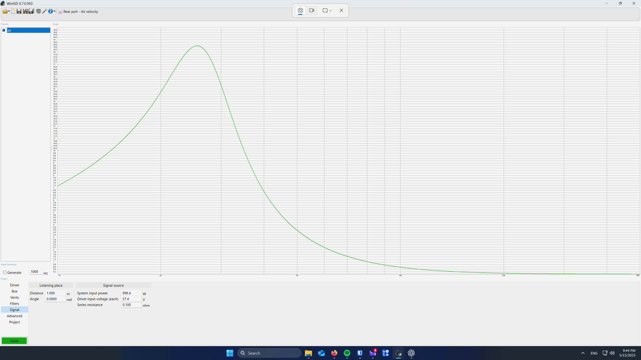

The front vent is 011x0.4m with total lenght of 87cm, so folded. In a 64x60x60 box. Winisd calculated about 19ms air velocity at 1000 watt, about 22 at 1400 and a max of 24.5 at full 1700 watt power. Is this responsible design enough? The design is from subbox, chatgpt did the calculations, and later made some bracings suggestions.

I would try and avoid using a right-angled L-bend for the port. It's likely to generate some turbulence at the corner.

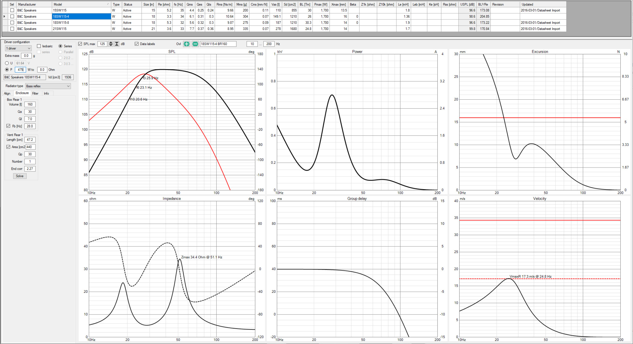

In any case, the port length Lv = 47.2 cm calculated by VituixCAD is much shorter than the Lv = 79.7 cm that your box drawing shows. Maybe we are using different end corrections to compute the length of the slot?
Indeed but bear with me, I didnt even know what WinISD was until last week and only got grasb of it since the last 2 or 3 days.
I examined your images carefully and noted instantly you have a different end correction. I tried to insert that in WinISD but it keeps jumping back to 0.732. After your comment I went and tried again, googled some more and it seems the current version of WinISD doesnt let people change either port lenght or end correction. Why I dont know but there should be a big warning as this has huge implications for anyone trying to build a vented design.
The advice is to work further in Hornresp, another program I only discovered a few days ago.

Evenso, winISD doesnt let me change. It does let you change to vent or slot, but the end correction doenst change. But Subbox pro also doesnt allow such. Which leaves me confused. Ive tried sketchy or speakerbox lite but enter lots of problems and complications.
Cant I just cut the drawing above, the 53cm board to 47 and leave out the 14cm folded part? Or do I need adjustments elsewhere to stay at Witwalds 440cm2?
It's possible to use an indirect approach to get SubBox to change the length of the slotted vent. All you need to do is adjust the vent tuning frequency in SubBox until the length of the slot matches the one that was computed by VituixCAD. This will need to be done iteratively, by trial and error. A few iterations should enable you to get quite close to the desired slot length.
