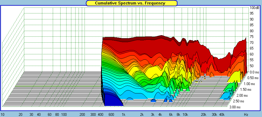

as you can see on this graph the XG18 is having no breakup node, and a very smooth response. i think it could be a very good choice, provided it is having a very good midrange distortion
also about the monacor unit, i agree that their curves are smoothed a little bit much, but if you look at theses measured specs of the SPH-165KEP: SPH165-KEP K&T you see the little membrane breakup node at 4.8khz , and
the smoothness of the curve before.
I assume the SPH-102KEP is having the same kind of breakup node except that you see on its FR curve that it is at around 10khz, soot really a big problem in crossover design. The SPH-135KEP is almost better behaved. I believe any of theses three driver could be good challenger, especially according to their prices

Some comments on the decay graphs etc.
If you look at the graph from the xg18 you'll definately see the breakups in the decay graph (no doubt about that)they are damped but they are there. Just compare them to those from the 165kep from monacor and see how fast (in milliseconds) the decay is (even at the breakup node at 4.8 Khz). It's faster then that of the xg18.
It seems that some just don't "analyze" what these graphs really say. Sorry that I'm picky on this, but it again feels like monacor is being kicked at. Okay they really have some bad stuff, but there are some superb units in there.
And that the decay indicates that the 165kep isn't a beginners unit is just ...... The small breakup at 4.8 khz is so well damped that it should be no problem to use this diver up to 3khz with a 12db network.
I've seen other measurements (in the K&T magazine) from several well respected scanspeak, seas and vifa units that aren't up to the level of the 165kep! I'm talking about the same measure methods here, so they can be compared.

I didn't mean my comment to be as strong as it was taken to be. It's certainly true that the 165 is better than most; and quite a bit better than many in the intensity of its breakup. It's just that there are (a few) drivers with very well damped breakup, which would be a better choice for a beginner developing his own crossover without test equipment or simulation software.
With assistance from someone with equipment and experience, or if building from a kit, those concerns would be reduced, or nonexistent.
I recently heard a system that used a metal driver with a very fierce breakup peak that had no hint of harshness; the company is noted for its crossover development expertise, and justly so. So skill can certainly make these drivers very usable; but not by a first-timer.
I'd be really interested in your test of the Monacor 102, and the MSH 116 sounds ideal for the original poster.
I totally agree with curmudgeon in here, even if the 165KEP is very good, the fact that the breakup is localized on a precise point that is a bit low in frequency for the use intended make it a driver that may not be "easy" for a beginner without experience in crossover design.
And although i love this unit, i may point to the fact that, having used it with a 12db / 3khz, i found the breakup audible even if it wasn't a big problem, it did colorate the sound, probably trough the effect it had on lower order harmonics.
BUT that was why i pointed to the other KEP unit that do have same kind of breakup but much higher in frequency. I'm pretty sure that you could use the 102 and 135 with a 12db at 3khz, without any problems, even for a beginner.
