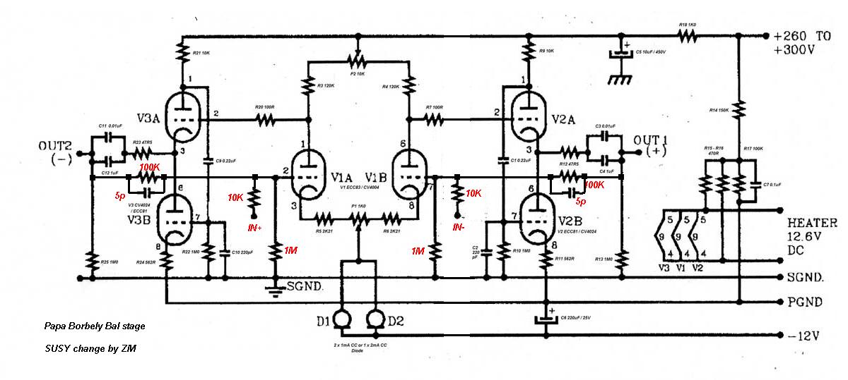

I've sorted out the Borbely. INP1 should be the input in unbalanced mode with INP2 grounded. If you want balanced inputs then R8 needs to be changed to 1M Ohm and then the pre-amp is fully balanced.
I'm now ready to drive the F4.
The heaters are running about 200V above GND.
Gain will not be a problem. I can either attenuate the inputs (as I am during testing) or add a bit of negative feedback (not really desireable I know).
The issue is getting enough output swing (~18 VRMS) for the Pass F4.

use feedback ; make it SUSY stage ; best of "both worlds"

SUSY is Papa's patented Super Symmetric mumbo jumbo
white wodoo of modern electronic era
look for his patent and various pdfs on FW and PL site
even if from patent you'll understand nada ( I reckon even Papa doesn't understand what he wrote there
anyway -
is SUSY stage ; with +/-36V you'll have nearly 70Vpp on output - clean
........ that's almost good for driving tube booster amp
tnx to SUSY and few tricks - whatever you pour in Pumpkin - it will clip at said output level ..... at least when gain is set to 10++ times
anyway - if you need conversion of Papa Borbely's stage to Papa Nelson's SUSY - just say ..... and give me needed gain

Assuming most CD players feed out 2V RMS and the F4 requires 18V RMS I would need a gain of 10.

....... I'm contemplating fitting an alluminium sheet within the bottom of the case and fitting the HOT semiconductors to it, dispensing with heatsinks completely.
good thinking 😉
here it is ; observe parts with red values ; gain is 10 , as you wished
I'll increase value of output caps , at least to 3u3
Many Thanks
I'll try it in the next few days.

Fortunately or Unfortunately, depending on how you think.
The Borbelly fitted into my 1U case and is fully finished now. (less your SUSY Mod)
The Pumkin won't fit into a 1U case so I've had to buy a 2U case (Good ole E-Bay)
As the PSUs are completely different I'm going to have to complete two completely separate Pre-amps. That'll be good as I will be able to compare them.
In the Pumkin you specify C1 and C2 at 5pF. This is a value of capacitor that has disappeared off my radar.
I can get 4.7pF +/- 0.5pF. Would you keep R5 and R6 at 100K or change them to 110K ??
