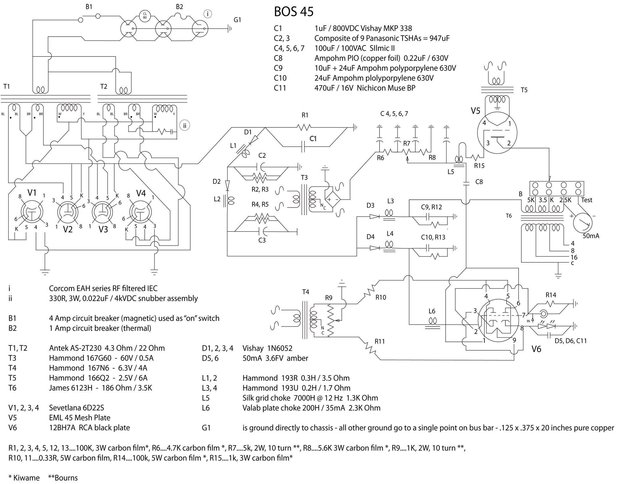

Not sure if this is the right spot but in the F4 manual and the 6 Moons review it is suggested that a small power amp makes a good preamp for the F4.
I have a nice little 45 based tube amp I'd like to try...but...I'm shakey on how to hook my 45 to the F4.
It looks like one just cuts off one of the RCAs on a given interconnect, puts an 8 Ohm/2W resistor across the resulting bare wires and then connects bare wires to little (45) amp's speaker terminals - remaining RCA to F4. (respecting polarity)

I believe the "c" common is not connected to the signal ground - I will check.
If output terminal "c" is not connected to signal ground should I connect the constructed interconnect to the 16 Ohm taps and use a 16 Ohm resistor? 😱

🙁Well so much for my beliefs; the speaker terminal (-) does have a lead back to signal ground. The transformer has a lead marked "0" going to the speaker terminal (-) so it is grounded through it's connection to the speaker terminal.
But...
This lead from speaker terminal (-) to signal ground is connected at signal ground with a spade and screw. I could disconnect it and thus float the transformer but I don't know if that is wise. :nownow:

:scratch: OK, I made interconnects with 10R/2W resistors across the the + and - , checked continuity and R and connected these across my speaker terminals (on my 45 SETs monoblocks). These interconnects then fed the F4.
The SETs were fed by a B1 which in turn was fed by a CD player. This is my normal set up for playback with the SETs. All units/connections are unbalanced.
Turn on CDP, turn on B1, turn on first 45 SET, turn on F4, all's quiet...turn on second 45 SET...Bias shoots up on both 45 SETS. I have to turn it all the way down to get it just over safe levels. What I get from the speakers is low level signal, distorted.
I went back and checked all my connections, checked the 10R resistors (not warm). Made sure all the connections made sense made sure I had the source correct. It just doesn't work 😕

Whats the gain of your 45 SET? Your output transformer assuming is a 25:1 ?
Well it is not a proper schematic; it was my very first build, I had to show myself how to hook up the tubes. Four TV damper diodes in bridge rectification, PSU is diode isolated, 12BH7 paralleled driver for the 45. Perhaps you can translate my pictogram 🙂 ...

'Floated the secodary, checked for playback and wired up the SET for feeding the F4. (16 Ohm 2W across the + and -, No problem.🙂
I'm a little underwhelmed though. I can't say anything against the combo; it's competent...like a Toyota Camry. But who gets excited by a Camry?
I really like the SET as an amp, driving the very same speakers! I really like the F4 (fed by the BA3 FE as preamp) driving these same speakers (Klipsch La scala). I just can't get excited by the SET driving the F4 🙁 But hey, it works! Maybe your little amp is the little amp that could 🙂
Perhaps you discovered one of the 'truths' about hybrid amplifiers? I've read comments that it's not the tube by itself that has the 'magic' but the interaction of tube with OPT and speaker. When you isolate the tube from the speaker (with the F4) it's just another voltage gain stage. I would like to hear it for myself one of these days.
