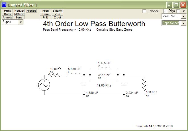

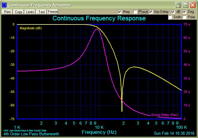

What are your exact requirements? Attached is a 4th order Butterworth with
10kHz BW and a 19 kHz Notch.
Input and output impedances are rather low to keep the L low.

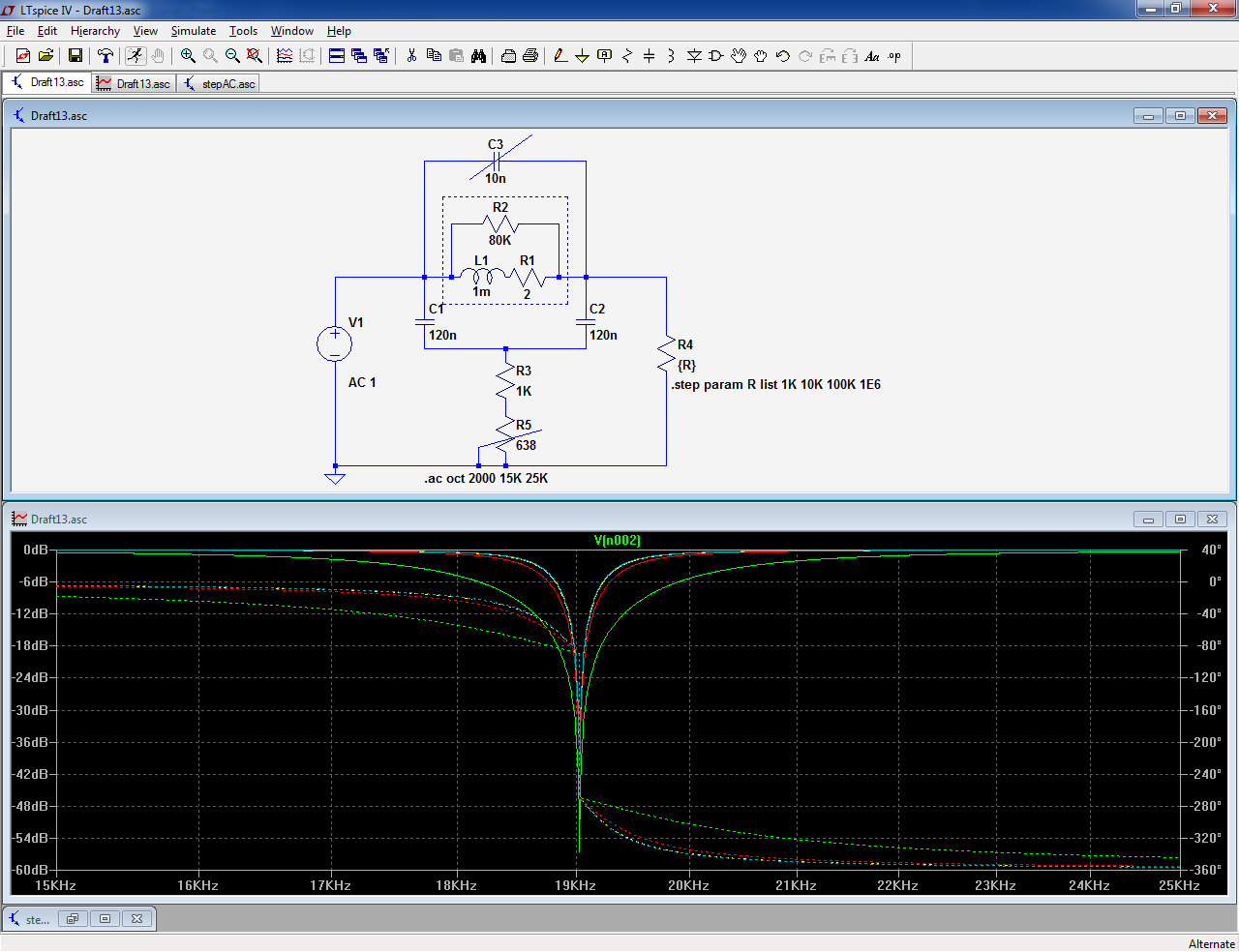

For such an application, I am fond of this type of rejector: it does not require matching, can give an infinite rejection with very imperfect components, the notch depth and frequency can be tweaked easily and separately, and it works with a very wide range of input and output impedances with little performance change.
In this example, the inductor is an ordinary 1mH choke and its loss parameters are compensated by R3+R5.
The exact frequency can be adjusted with a small parallel cap, C3.
Note that C1 and C2 do not even need to be exactly identical: you could use 100nF + 150nF for example.
If the inductor is very lossy, R3+R5 will have a low value, limiting the range of source impedances, but that's about the only limitation

Now the OP just needs 10:1 matching transformers on the in and out to give him a 10k working impedance.
... or redesign the filter with higher impedances... i don't know what Conrad want to do with this filter and what the exact application is. So wait what he says.

The notch makes a lot of sense- thanks! The 19 kHz will be dead on, and I think that's the only thing I'm worried about filtering out. I did consider transformers, since an LC filter with low Z uses manageable inductors, but that was all just getting too complicated for the intended purpose. An opamp filter would be easy enough, but if I were going to bother with power I'd just plug in a commercial K-H filter and dial it up!
